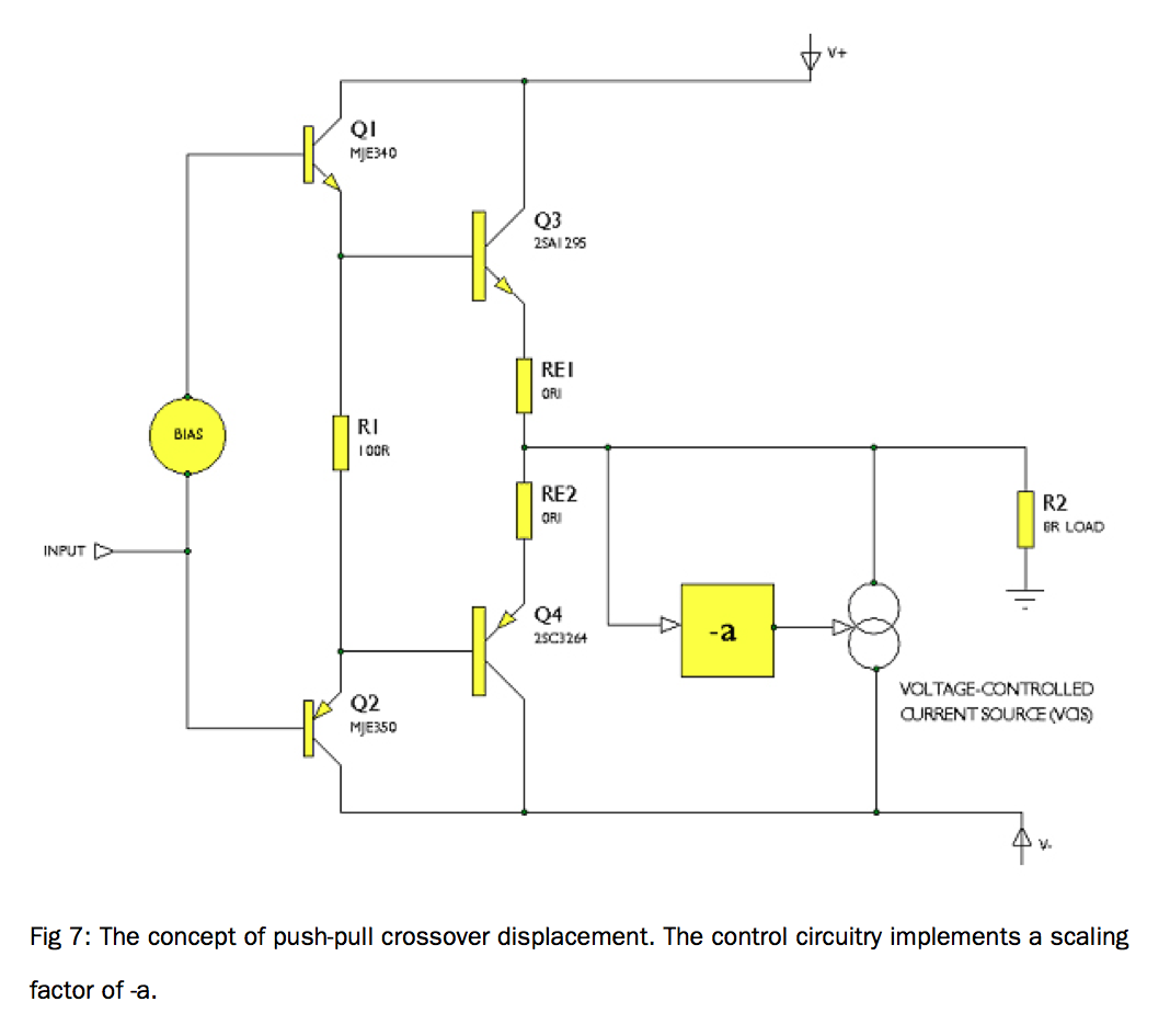

Dear All,
I tried to run the the chips at Class A as well, but with a cascode current source. (I saw a similar trick in some DIY headphone amp designs). I found small improvements in sound, especially (strange enough?) in the lower octaves. However, I went a bit to far and didn't had the availability of adequate heatsinks, so the thermal shut-down jumped in, and the chip got to hot. Now it is mentioned again here, it is interesting to experiment again with it. Lucky to see that this chips are well protected, and that is one of the big benefits of those chips. Some discrete designs will self-destruct themselves with such a experiments.
With kind regards,
Bas
With kind regards,
Bas

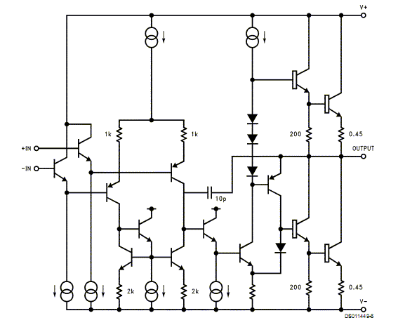

Actually, I understand VERY well how this happens.
To wit, the input offset voltage, after accounting for the various parasitics and input bias currents, NFB networks etc. is actully around 10mV or more.
In many "gainclones" even with balanced DCR I measure more DC offset on the output than the total of the change in voltage at the output that a 0.1A extra bias current can cause.
So in this case we already have more unbalance from the normal offset than from my mod.
So, I repeat my point:
IN PRACTICE and with the LM3875 or LM3886 or LM4780 the imbalance in the differential input stage are very small, when using 0.1A extra bias to the negative rail.
Further, due to the design applied in these chips the effect of any imbalance on the output signal (distortion etc.) is very much minimised.
At the same time the application of the "unbalancing" has a very material positive impact on the distortion at low levels (much greater positive effect that the minimal imbalance).
You may bang on about imbalancing the differential pair, the point is that in the context and at the levels we are working with in my examples this imbalance is irrelevant and at best no worse than that from the normal offset sources.
It does not suffice to know the theory, one must also be able to evaluate the magnitude of the effects and contrast them to the impact they make.
I see you did not take up my offer to demonstrate that you actually know the theory sufficiently to present the necessary math to show just how much my modification upsets the apple cart.
For reference, D. Self shows that indeed the DC Balance is critical in cases where no emitter degeneration is used. Incidentally, his work also shoes that even with fairly minimal local degeneration (much less than the 1K used in the LM3875) will linearise the transconductance so much, that even several hundert mV DC imbalance on the inputs do not have any material effect.
Incidentally, for an un-degenerate differential stage D. Self suggests that limiting the imbalance to 1% is necessary. If you had done your homework you would realise that 0.1A extra current to the negative rail shift the current balance by less than that in the LM3875.
Anyway, you are still welcome to show your math. I have work to do.

EXACTLY.
And one has to understand the various effects of such techniques as local degeneration as well.
Note, I do not dispute that we will will see a very minor imbalance (though not necessary one that is much larger than what is present in normal operation and even Nat Semi's Datasheet Test circuits).
What I am pointing out is that the effect IN THE SPECIFIC CASE of the Nat Semi Overture Chips is very small in terms of quantity and it's impact is further reduced by various other design techniques implemented in the Nat Semi Chips.
Anyone can throw some halve-knowledge around. Those who understand what they talk about can give at least first order estimates of how large the impact of a given problem is.
So, you fail to quantify the magnitude of the problem you keep banging on about. I repeat again, please provide your numbers. This will:
A) Show the extent of the problem
B) Show that you understand the complete nature of the problem
As to "Well, i respond the same way i m talked to...", I believe you where the one to introduce the term "childish tweak". And that in the context of a tweak where you have repeatedly demonstrated an inability to quantify the issue you refer to.
Ciao T

You mentioned that is possible to run LM3886 at unity gain, could you explain how?
JCX beat me to it...
In case you missed it:
for "unity gain" operation look up "noise gain compensation" - easiest with inverting gain, positive gain is going to require a low, stable source impedance at the + input from ~ 20 KHz - 2 MHz
As for the actual practical implementation, sorry, that is a commercial product, so that shcematic stays under wraps I'm afraid.
Ciao T
See here how Self does it by actually varying the current source. Again very interesting.. For us DIY-ers it can be interesting to stick to a fixed cascode current source. Not difficult to build.
With kind regards,
Bas
With kind regards,
Bas
Hi Bas,
True, but when compared to the speaker load the kind of resistors we can use with normal chipamps are still quite high in impedance. So the difference going from there to a CCS is markedly less than with many other systems.
If you do a CCS you may as well make it dynamic, as per Mr. Self. He suggests that the extra current should be zero when the amp is maximum positive swing and at double the quiescent level when the amplifier is at maximum negative swing.
This seems to call for one of Nelson's dynamic current sources maybe?
As for pull to positive rail or negative rail, the results will be quite different in case of the LM3875, see attached principle schematic. Actually, that schematic is worth going over with a fine tooth comb. Many a proponent of discrete designs can see a lot of good ideas here that are almost never found in discrete designs...
Ciao T

Dear Thorsten,
But since it is Self's patent (pending) it doesn't feel good to copy him. Second how to vary the current source? I suspect in the Cambridge it is done with a PIC since the whole amplifier is PIC based. Analogue there are of course many ways to do it, but add skills and complexity.
With kind regards,
Bas
Well, for private, personal use even patented technology is "fair game".
And the "pull down" current source for Op-Amp's has a long history, I am sure with sufficient time and effort there is probably enough prior art to challenge this patent, if one was so inclined.
As said, the dynamic current source by Nelson (Pass) could be a starting point.
With as linear a relation as that D. Self describes we just need a circuit that, referenced to the negative rail, outputs 0V if input voltage is twice the negative rail minus dropout voltage and outputs 1V with the negative rail voltage applied and 2V for no input voltage.
Looks like a single transistor (or maybe something temperature compensated like the Tl431) could do the job. I am sure, if I spend enough time I can do it with an LM317 and some resistors... Shame the 317 has not enough voltage handling for our job.
Given Mr. Self's description I'd rather doubt it. It seems clearly directly linked to the output voltage of the amp.
I would suspect an inverting op-amp into a level shifter to the CCS, if you'd ask me.
Ciao T
