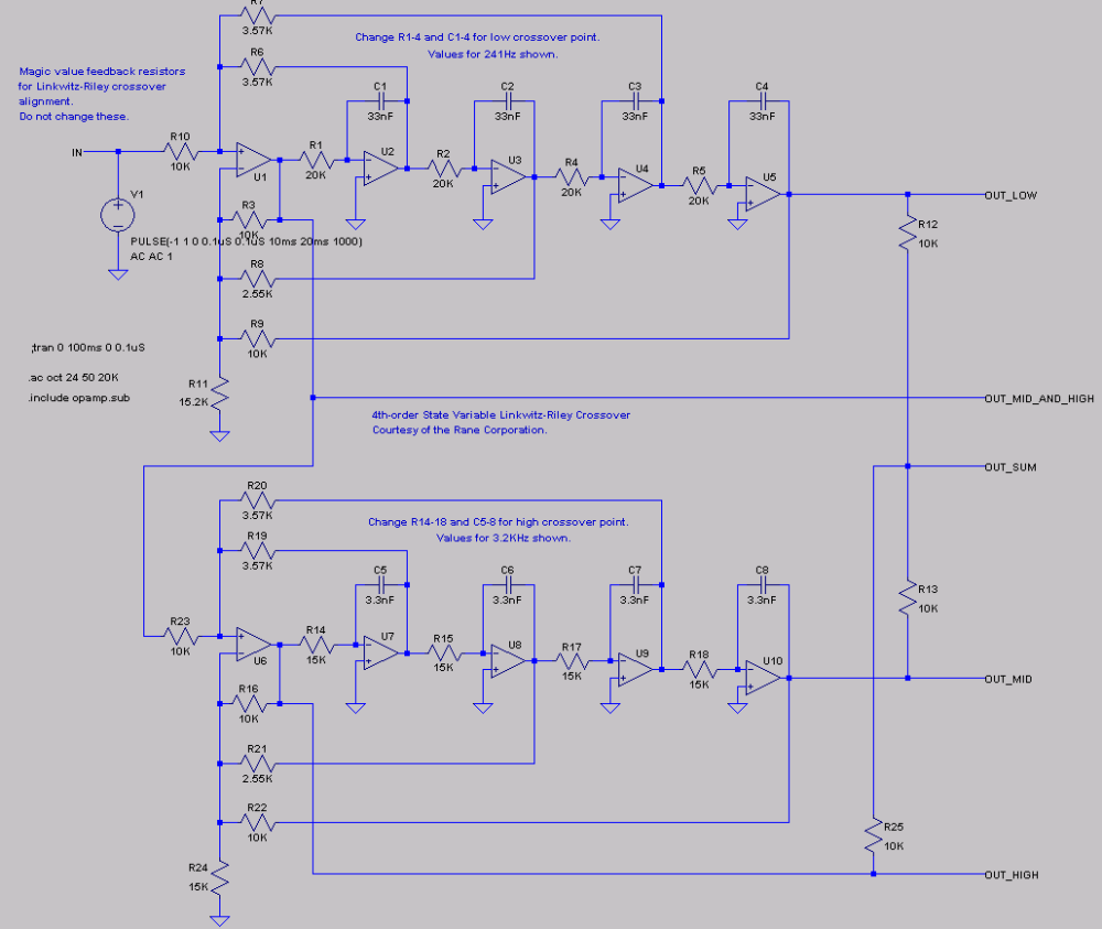

All capacitors and resistors the same hey. That's easy, just use the state variable Linkwitz-Riley design as described by the Rane Corporation here http://www.rane.com/pdf/linriley.pdf
Features:
Fewer resistors and caps if you want to make an adjustable crossover.
Less opamps than say the Rod Elliot Linkwitz-Riley.
High and low outputs from a single "stage" that have identical crossover frequencies. Again nice for an adjustable.
I have only just started to think about active crossovers but I don't see what the problem with phase might be with this. High and low outputs are in phase to withing few milli degrees at all frequencies.
So far I have simulated and built the low and mid section as in the attched schematic.

Didn't know they have a new name for this kind of circuit now. I recall seeing somthing like this some 20 years ago in Popular Electronics or something like that.
As some posters already mentioned - an allpass (alone) can't act as a crossover.
But a crossover often acts as an allpass. An LR 4 for instance has a constant summed output voltage but turns the phase by 360 degrees.
Crossovers that behave this way are often called allpass crossovers.
Transient-perfect crossovers (like the ones the poster above deals with on his homepage) are often just called constant voltage crossovers though this naming is a little inexact.
The crossover in question turns the phase by 360 degrees in total for a three-way crossover i.e. half the amount of the 720 degrees caused by a three-way LR-4.
