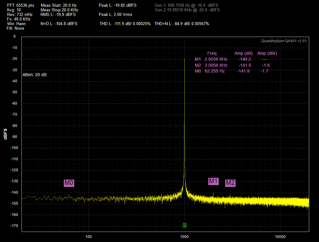

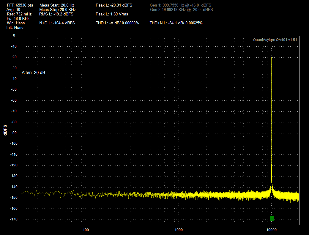

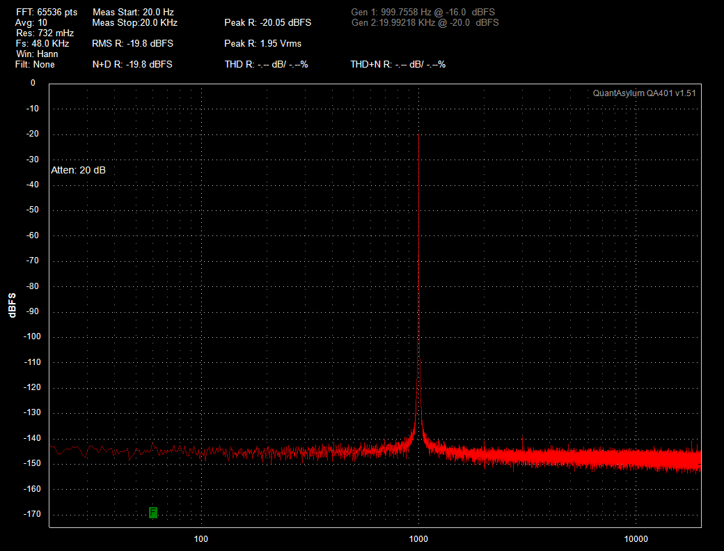

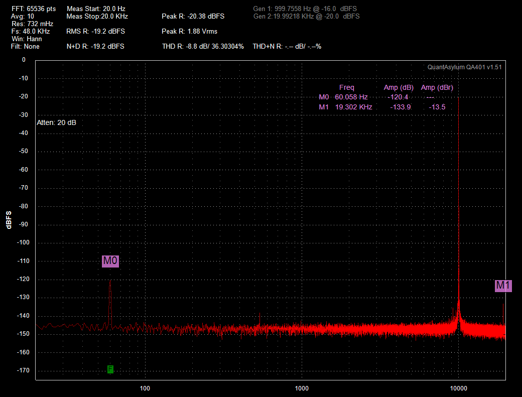

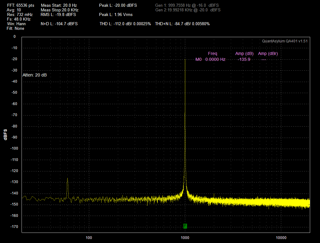

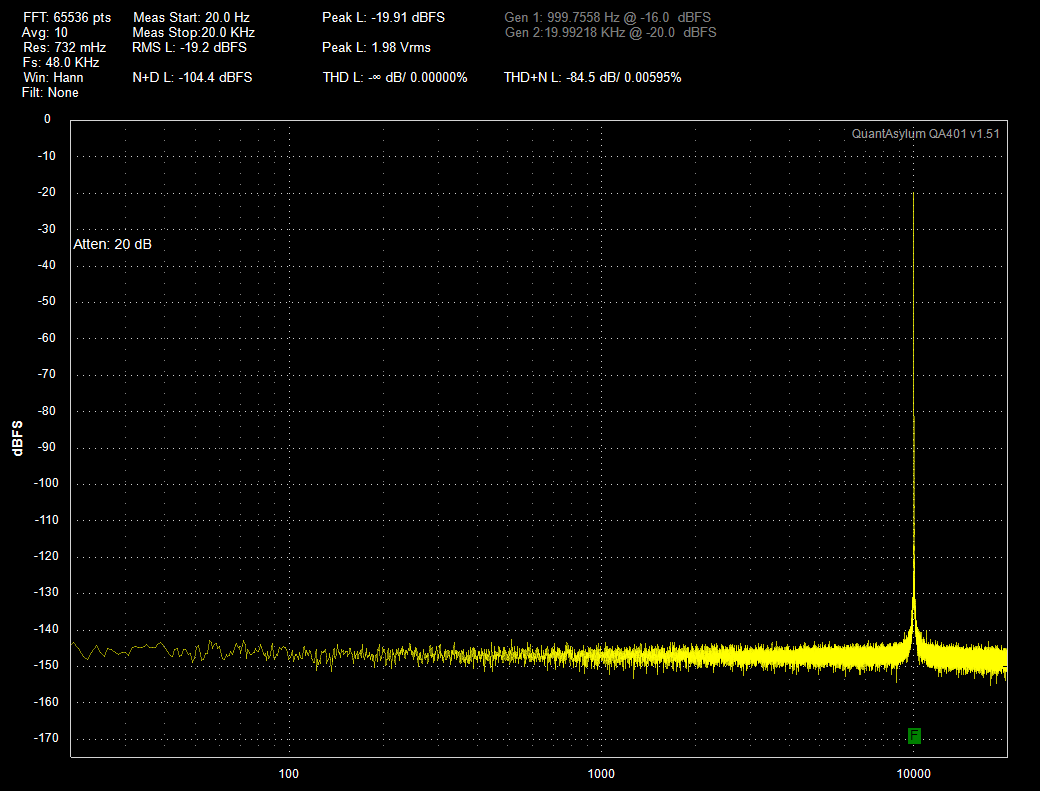

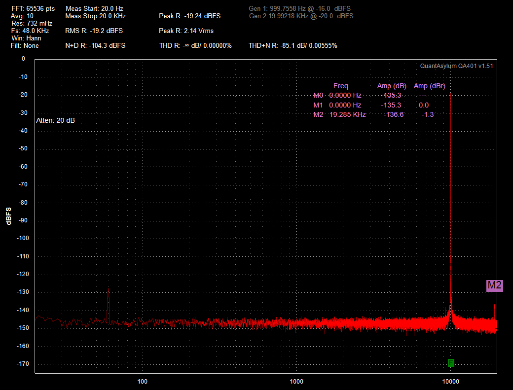

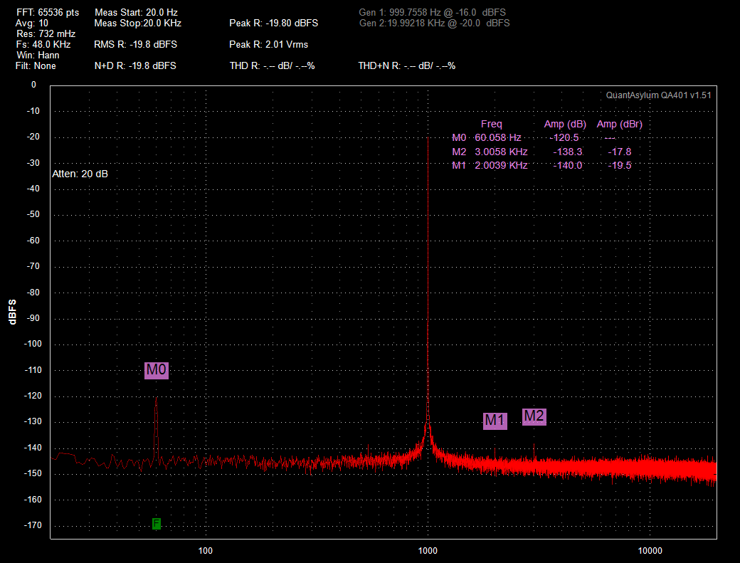

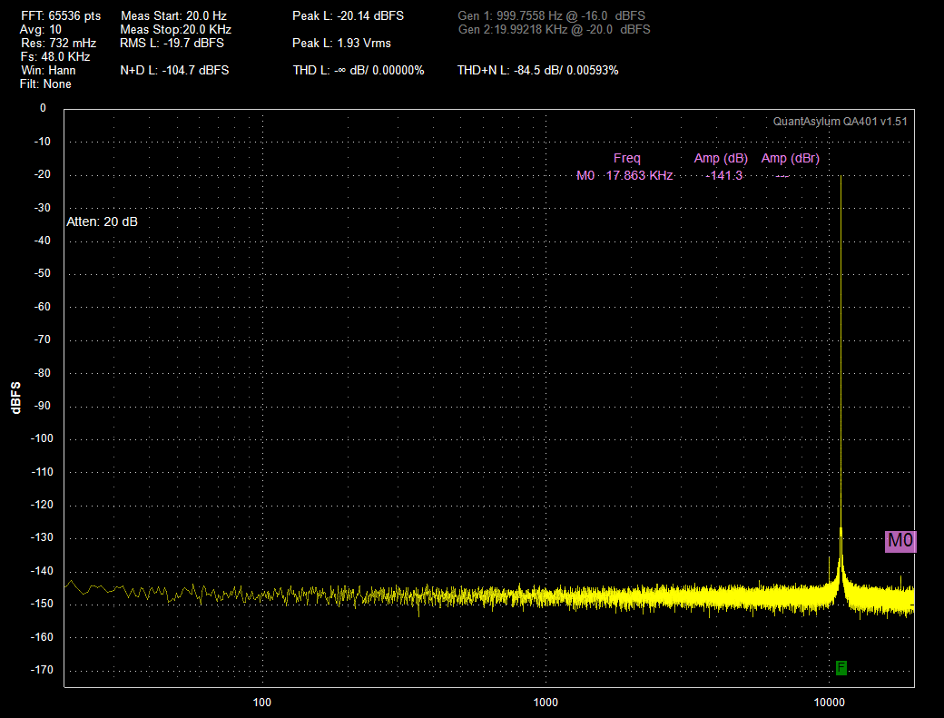

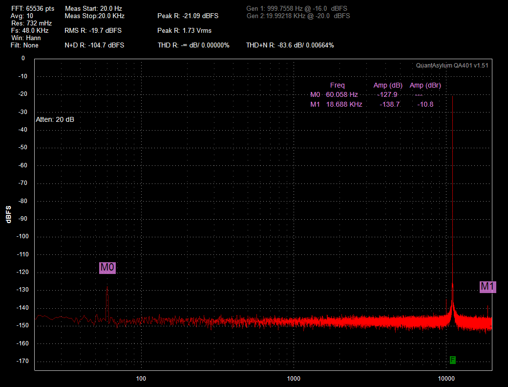

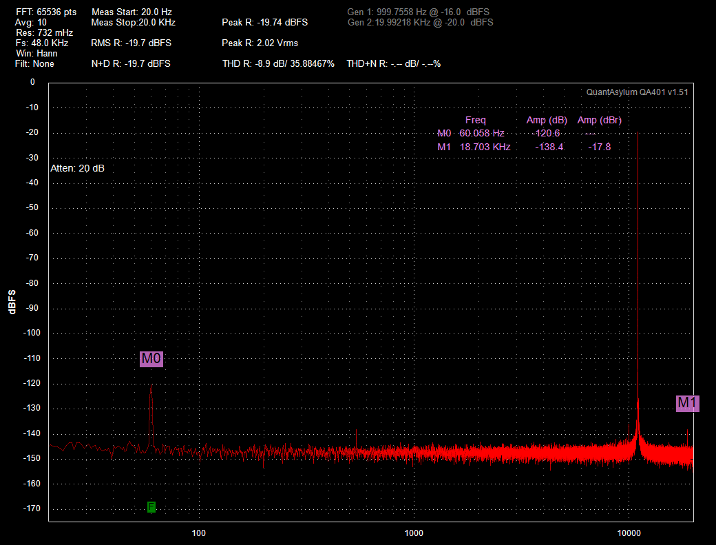

Thanks guys for the heads up on the backwards battery snaps. I did indeed notice it before anything exciting happened. I wanted to post my findings though, I have a few head scratchers to also ask about, which are potentially related to my analyzer output.
To test, I let things rest for an hour on AC power with the three oscillators turned on. The negative input to the analyzer is terminated with a 75R BNC jobbie. I'm posting results from both channels, AC and battery power, across three frequencies.
First, I tend to get some very wacky THD readings. See 10kHz_R, 11kHz_R_Batt and 11kHz_R. Since the graphs look great, I assume this is just an analyzer quirk? In other graphs, it shows pretty close to 0 and sometimes "---" which I presume means, nearly zero?
I see some 60Hz coming through from the analyzer power. However, it's not consistently there!
In general, do things look about as you would expect them?
edit: looks like the forum looses the original file names. in order, left-to-right, they are:
1kHz_L_Bat
1kHz_L
1kHz_R_Bat
1kHz_R
10kHz_L_Bat
10kHz_L
10kHz_R_Bat
10kHz_R

The 10 KHz and 11 KHz harmonics will all be outside of your measuring range. You need to switch to 192KHz to see any harmonics from them. If you mix the two you can then see the IM products which should be 1 KHz, 9KHz & 12 KHz to see in band with the 48 KHz sample rate. The peak value will be significantly higher than the RMS value so the reference levels may be misleading.
I think the first picture is on AC since it has a 60 Hz spur. The lack of spurs on battery is pretty remarkable and attests to Quantasylum's layout. The harmonics at around -120 dBC is what I would expect from that ADC.
I don't know what the actual levels are but if you calculate -120 dB from FS 2V thats 2 uV. The source impedance of the oscillator is 600 Ohms. So to get 2 uV across 600 Ohms you need (I think) 30 nA (too many zeros. . . .) Then calculate the capacitor needed to get 30 nA from 120V is something like 1 pF at 60Hz. Again too many zeros so I may be an order of magnitude or more off but the point is that it takes very little leakage to get those low level spuria. I usually spend more time moving ground connections and wires around the bench than taking measurements.
