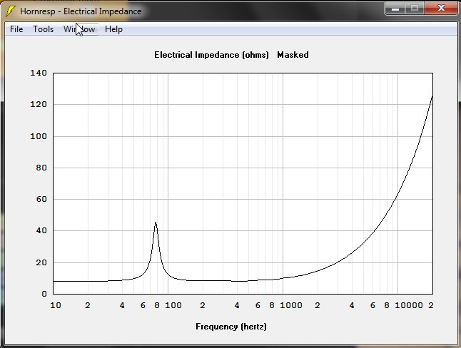

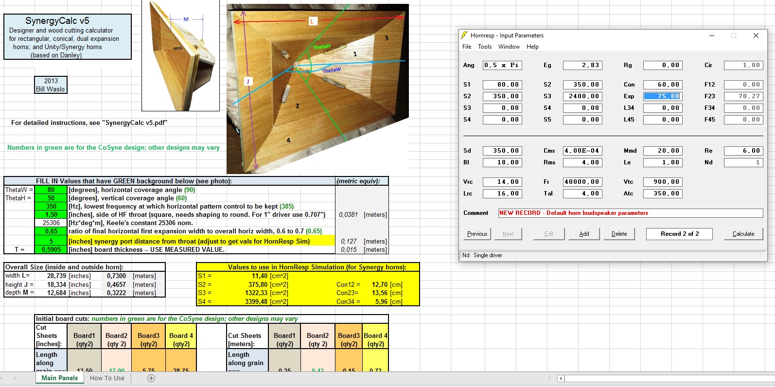

Also I don't know if you are anyone in this thread has used Hornresp a lot, but I can't understand how I am supposed to input the parameters from bwaslo calculator to Hornresp. There is no Con12, Con23, Con34...
Your build is very nice, and I can imagine the pre-designed waveguide gives very good results. However, I'm not very fond of the aesthetics of the black plastic PA horns, and would rather build my own out of ply. Just look at these beauties:

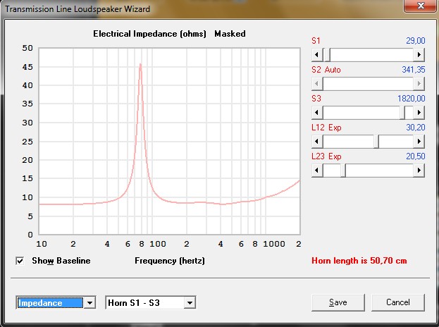

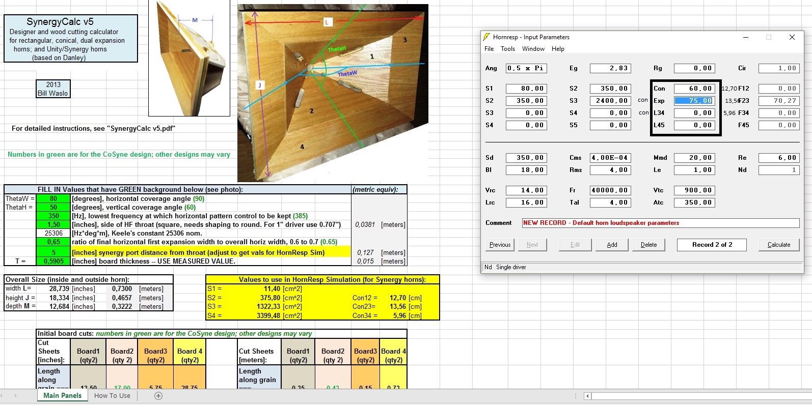

just type in square box I drawn.
put mouse pointer on the text and click to con, or exp, what you need and fill in the calculator stuff there in line with S1 S3 etc.
So click on text exp, to see con, and L34 to see con, double click on input box and calculate if it does not let put in something and save there.
regards
regards

Thanks kees, now I got it. Would this Seas 8" woofer be good for the horn?
Just simulate with hornresp, and you see, it has a nice strong motor and low qts, good for horns, I presume for bass.
regards

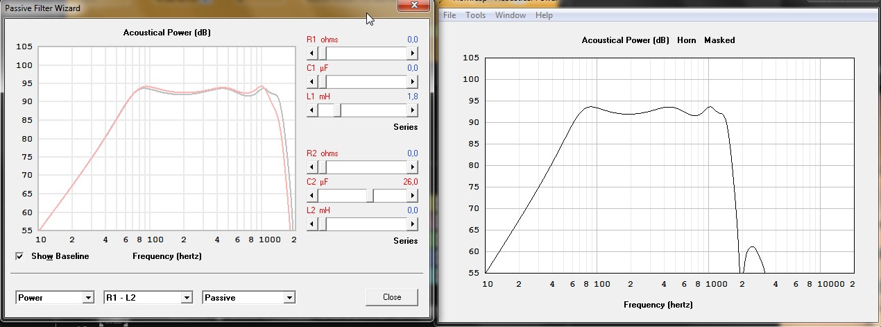

You can try a Zobel or other correction network but you would probably have to export the simulation results and then import them to a crossover design tool like XSIM in order to do so. You need to do this at some point because if you have several passive PEQs in parallel, you need to worry about the overall input impedance of the crossover from the point of view of the amplifiers ability to drive it. XSIM will give you more visibility into those issues.
My personal preference would be do use DSP and not have to deal with them. Even if I were going passive ultimately, I would simulate the digital EQ first to determine the PEQ F0, Q, and gain/loss needed.

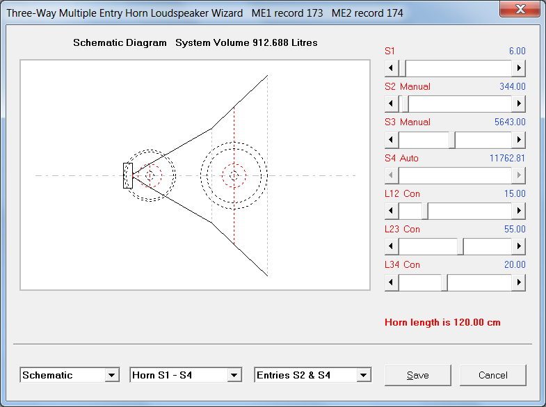

The Hornresp Multiple Entry Horn Loudspeaker Wizard tool can also simulate three-way Synergy-type systems.
Hi David
I did play with that, however, did not yet find out how to do that.

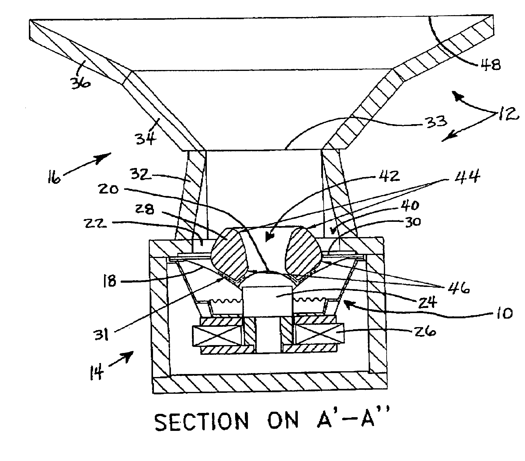

I did find on the internet this horn, who looks a constant directivity horn, but my attention is about the plug in it, what if I try this in the trynergy.
regards
You did a bunch of phase plug experiments already, if I recall correctly. Wasn't your finding that it was better overall without a phase plug for a cone driver?
This is a other kind of plug, a hf injector like thing.

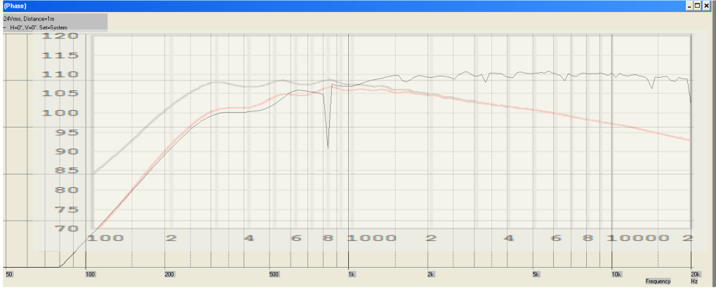

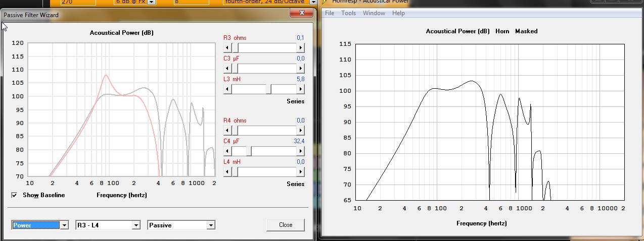

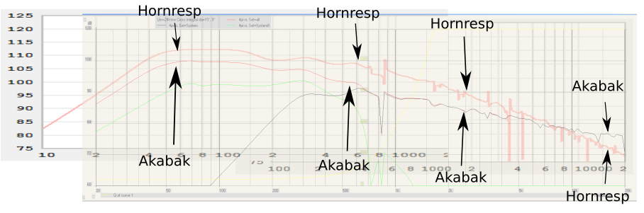

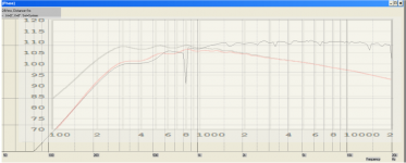

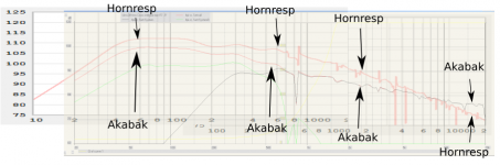

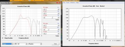

Little humble Akabak VS hornresp sims with my 3ways multiple entry horn project (using huge fixed delay, and 1rd crossovers, with kind of filler driver woofer) :
1) with some watts added in hornresp sims to show curves differences easier (easy to see/evaluate in low freq) : power response (not acoustic/on axis sim) using fix delays + 1rd crossovers. Filler driver in green, and fullrange in red, total in black from akabak sim. Only show here total hornresp power resp in red.
2) 0° freq response (horn simplified to 1 segment in hornresp) at exact same watt power, 1st order high pass. In low range, non coherent black line is just hornresp sim without filtering. Don't pay attention to it.
My conclusions : more high with akabak/less mid and lot more difference in directivity => i remember having readen David explaning that the model he use in hornresp for directivity is better in high freq.
Real result measurement in few days...
How would one simulate different back chamber volumes for the midrange and woofers using hornresp - if that is possible at all?
- or is it assumed that they share the same back chamber volume?
Maybe I need to play with it a bit.
