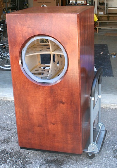

Well there's a limit to the size of cab I can get past the entrance to my family home so some level of compromise is included in this project.

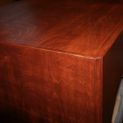

I've had a devil of a time with the staining, Birch is not easy and the gel stains have really odd colours. I've ended up staining it over and over because it just doesn't look right. Unfortunately, all my best intentions of using sample pieces to proof out the finishing didn't help because they were too small. Lesson for next time. This is my first attempt at staining so you can't ask too much !
Anyhow, I've done what I can. It's not a light finish, it's quite a rich colour. The photo is not that colour-accurate but it passed the WAF test.

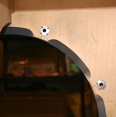

Installing T-nuts for the driver. I'm going to use 1/4 inch bolts. Right now I don't have bolts that suit the driver flange properly, but I've found two local sources on the web that I can visit for something more suitable.

Take a look at Allen-head cap screws. Use black oxide for black frames and stainless steel for polished aluminum frames.

I think I've found something from Fastenal. But I'm starting to like the appearance of the brass coloured bolts...

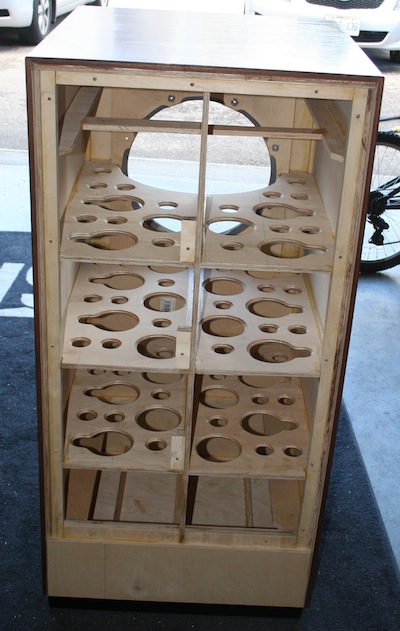

p.s. my wife had a bunch of old clothes for the charity shop. I just purloined them and stuffed them in the back. Now it's much better.

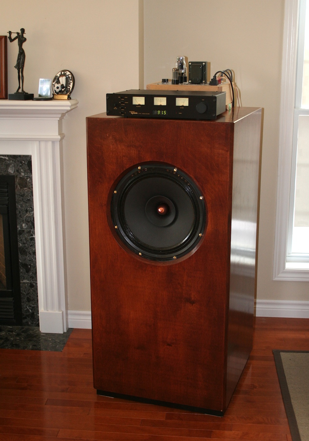

and let's get it hooked up.
no stuffing, open back, not likely it's optimal yet, but first sound is always fun !
can you have someone stand next to that in a picture for scale. it really doesn't look as massive as it is in that picture.
work looks really good tho.

That drawing looks good, but be careful of shouldered bolts. I sold a couple of cabinets with T-nuts on the back of a 3/4" baffle without drivers. The customer couldn't (??) find the 1" cap screws I specified and used 1.5" screws. The shoulders bottomed on the T-nuts, but he kept turning. The T-nuts happily stripped out the tangs and the baffle was ruined because there was now no way to get the screws back out. One reason I use screw inserts now instead of T-nuts. If the baffle is 3/4" (18mm, whatever) do not use anything longer than 1". 1" and shorter cap screws are threaded their entire length.

minus the lower bass, you may like it more with the back off.
But you may need woofer or subwoofer support.But very, very nice job there. Norman
Thanks Norman ! Yes - I'm quite open to the idea that I won't install a back to this, and instead of it being a sealed cabinet it may become a Boffle. It's also a handy place to store old clothes and pyjamas
I'm not in favour of adding any additional drivers, this will be a purist speaker. I may be quite happy with the bass as it is. We'll see how it goes.

Bob - I destroyed a t-nut on the back already, I found that they aren't all that good quality and one of them had a bad thread. This is the first time I've used t-nuts and well, they're cheap, what else is there to say about them. Threaded inserts would be my recommendation for a future build. I changed my approach by checking the threads before I installed the last of them. The bad one I had was on the back of the cleat for the back panel and it soon ripped free of the wood. I had to hold it with some pliers to recover the bolt. Good thing is that I have access to both sides of the baffle and so there's no danger of permanent damage - I can cut out anything that gets stuck. I guess you'll be providing bolts if you ever sell an unfinished cabinet with t-nuts again to save the consequences.
