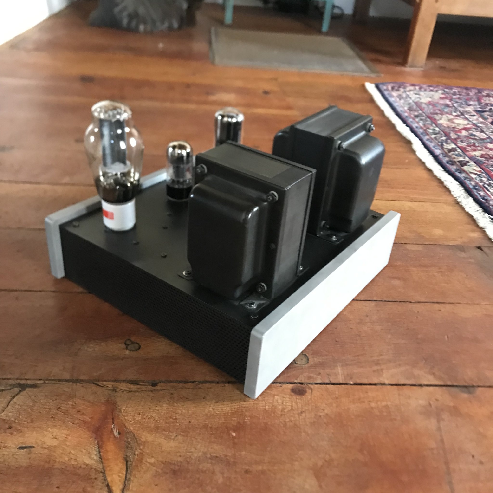

I'm thinking of getting this big rock tumbler to use in surface finishing aluminum front panels, heatsinks, etc. Prior to anodizing them all at home. I've tried sanding, buffing, lapping on glass, random orbital vs rotary sanding, etc. all sorts of ways, I get good results but not "repeatable" results from piece to piece, especially if I'm progressing through six to eight different grits of sandpaper. I thought well maybe I should get a glass bead blasting cabinet, but thats still a manual operation, and I dont have much room left in the garage. And also its a skill I'd need to learn and you need a very high CFM air compressor for one of those. I certainly dont have room for a large floor standing air compressor. I also looked at vibratory tumblers, but they are expensive and usually use a bowl with a rod down the middle which would mean I cant do long plate stock. The largest ones run close to $2,000
Then I thought I had a brilliant idea (those usually fail me)... Maybe I can find a large sized rock tumbler to do a "set it and forget it" tumble of my aluminum parts so that all the parts of an amp have precisely the same surface finish. The largest size panels I plan on doing would be 12 inches by maybe 9 inches, because that fits nicely in my mini CNC machine. Heatsinks, there are a few I like from heatsinkusa, the 6 inch wide and 4.5 inch wide ones usually cut to 3 inch length. So those are my largest part sizes.
Well, I found this large rock tumbler model which is widely used in the commercial rock tumbling world, it has a 15 inch by 15 inch drum to hold any sort of tumbling media I could think of and also hold the largest parts I'll be making... (link below). It sells for about $850 bucks everywhere and I can drive to pick it up. I'm figuring I could machine all my parts and heatsinks, then simply tumble them for a set number of days, hoping they will emerge from the magical drum with consistently the same and beautiful surface finishes. It's even water tight so I can tumble with wet media, try out different media, walnut shells, ceramic media, 2mm stainless beat shot, plastic abrasive media, corn kernals, etc. Then I'll anodize them (which I am already set up for in the garage).
What do you guys think? Will this work?

No,you would need HUGE rock tumbler, say 10X the size of your panellength ... obviously impractical.
Becuse "surface grinding" action is not uniform at different points inside.
It works for small parts (I use one to clean cartridge brass before reloading) because they are rolling and tumbling in all directions possible but a panel,even IF it fits, is too large for that.
I suggest blasting.
Sand is too rough and aggressive but you can get glass micro beads, which are rounded shape, result will be a beautful and very even satin finish.
By the way, that´s what Factories and Pros use.

Heatsinks are especially impossible to finish the area between the fins, so I would think this is ideal for that. I'm looking to get a matte finish that I can repeat, that's the key repeatability over time and projects.

Lets say if I placed a 12 inch long by 3 inch high by .25 inch plate into this 15 inch diameter octagonal drum, I understand that it will stay longitudinal in the drum, but it will be flipping over because the drum itself is octagonal, making everything more aggressive. I would think that should be ok. The abrasive might always flow in one direction across the face but I would think still give a matte finish after a time. I really think experimentation is the only way to determine what happens. I understand a glass bead blaster cabinet but it's that $1,000, big, high CFM air compressor my garage is packed. So I need to improvise, I have a spot for this tumbler. If it fails I guess I could just make shiny rocks!

I've never tried tumbling aluminum but I think a blasting cabinet is a better route to take, thats what I use (though I mostly do side panels). And I like to use a light patina where slight variegation in the blasted finish looks fine. Maybe it would be fussy if you plan to anodize... I don't know. I also think the tumbler will have a hard time reaching into crevices in things like heat sinks.
