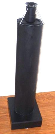

The omnis are in back channel service, and do quite well there. Their ability to not reveal their location is a very good feature for this. Not a bad feature for front channels, either, but as mentioned earlier, I elected to keep dipoles up front so that I could orient them cross-axis for a wider sweet spot.

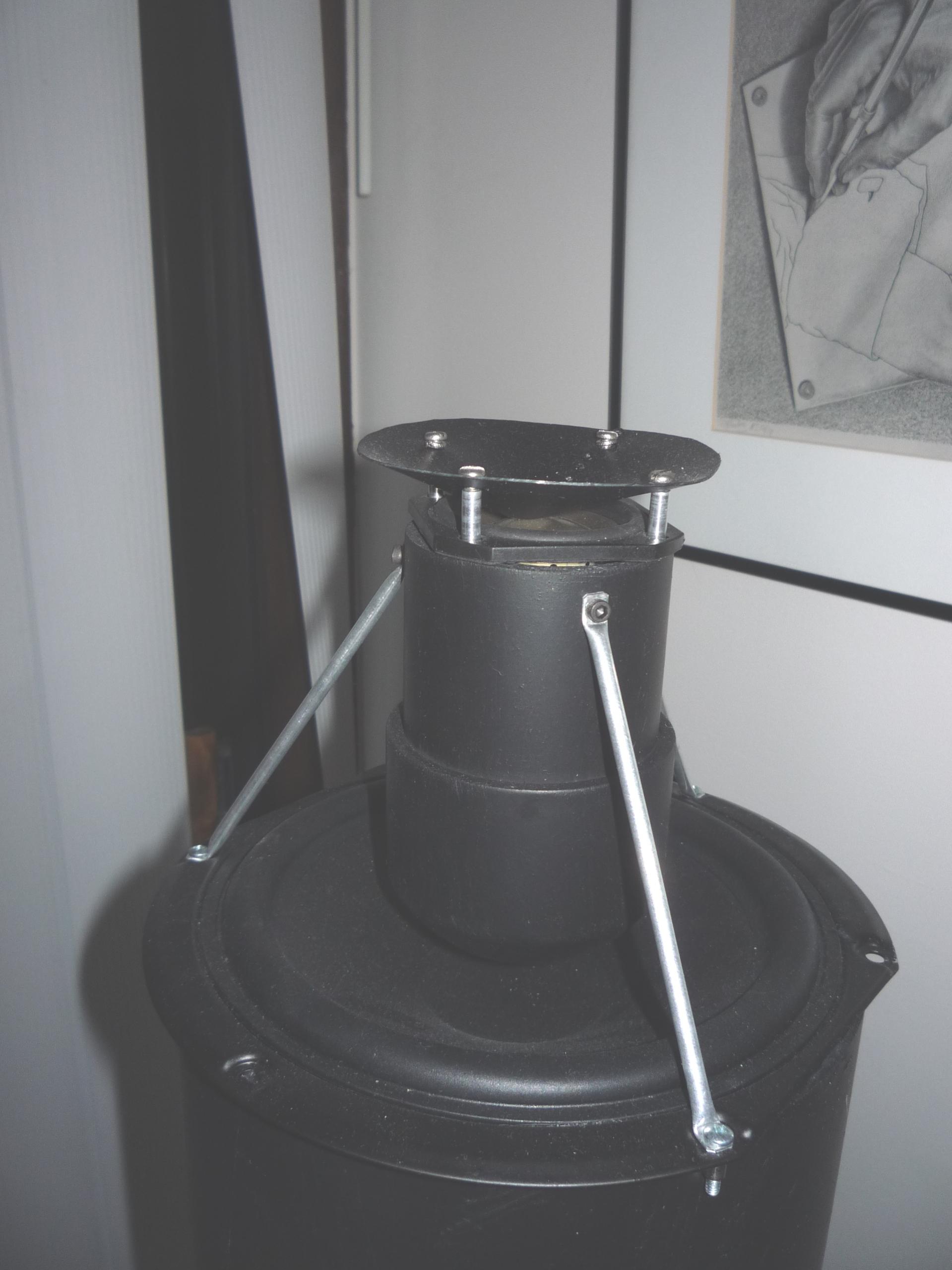

Larger pic of Driver/Reflectors?
Hi -- I like your approach -- I've also thought active electronics could better enable us to take advantage of some of the (potentially) inherent characteristics omni radiation.
Could you possibly post a larger pic of the woofer/tweeter configuration you used? I'm finding the black-on-black a little difficult to make out on my monitor.
THanks, JF

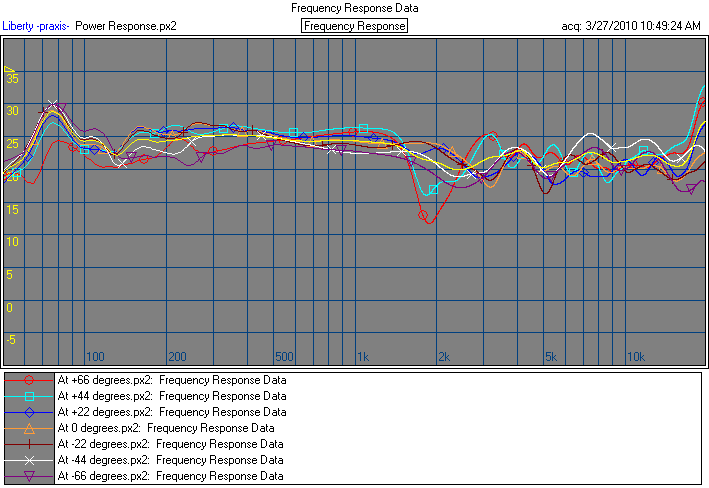

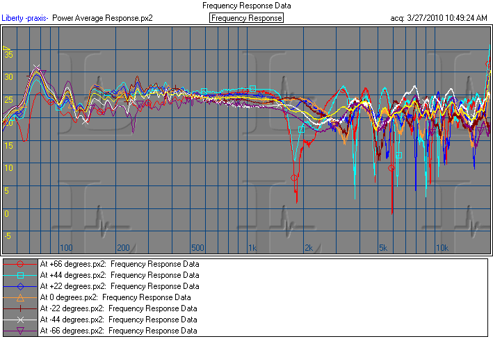

I pushed that concept to its max in my SoundRounds design (second link), which crosses over to a front firing tweeter up around 4khz and uses very small flange neo tweeter with vitually no baffle, so it never really transitions to 2pi space until very high in frequency. Below is what the FR looked like in that design. They won their class at the IowaDIY and imaging and soundstage were their highest rated categories.

Digeridoo, here is a closeup shot of the tweeter short pipe. Black on black doesn't photograph very well, sorry about that.
Dan N, I have read further about your other designs, very thorough work there. I'd be interested to hear how it goes if you do decide to work again on the midrange of your 'true omnis'. I'm considering doing a half omni, with forward facing tweeter like yours, for a center channel speaker. It has to be up against a wall, anyway, so there's no sense in having that one, at least, radiate more than 180 degrees. I have to deal with how it will play over the video screen, though, not sure how to attack that.
Your SoundRounds do look like an effective design, sort of like a Pluto done in a D'Appolito arrangement! Amazing you got it to go with a passive crossover arrangement, I'm impressed. You should consider marketing that one (though that's a tough path to go down).
