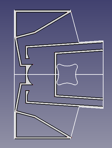

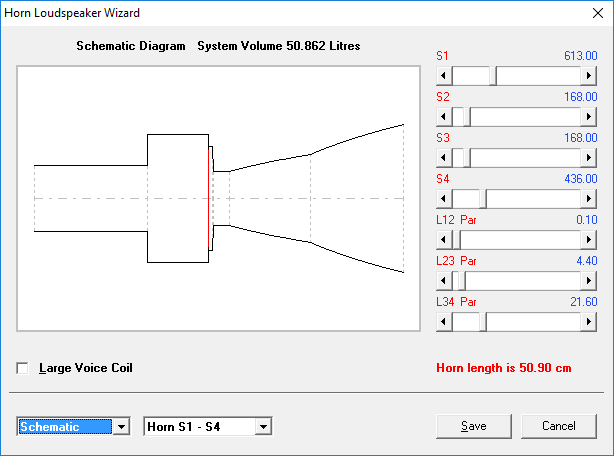

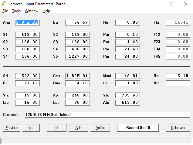

A 12 inch horn loaded MTM top: 12NDL76 and N314T-8
I am starting to work on a new PA system. I am replacing my four 18 inch Dayton PA460 subs with eight 15 inch PA385 subs. They are easier to carry since they are smaller, lighter (63 lb individually), and will go about 12 dB louder combined and about 8 Hz deeper (albeit with a lot more amplifier). I will start a separate thread soon when I get outside to make some measurements. Eight of them should still fit in the back of my SUV with the tops and amps.
This thread will be about my new (not built yet) PA tops (mid/high). I was inspired by Peter Morris' DIY Mid High 90's. Peter used the amazing BMS 4594HE two way compression driver and two RCF MB12N351 twelve inch woofers to make a 136 dB capable pole mount speaker. They are a little rich for my blood, with $650 compression drivers and two $290 woofers. Mine are not a poor man's version but more like a middle class version.

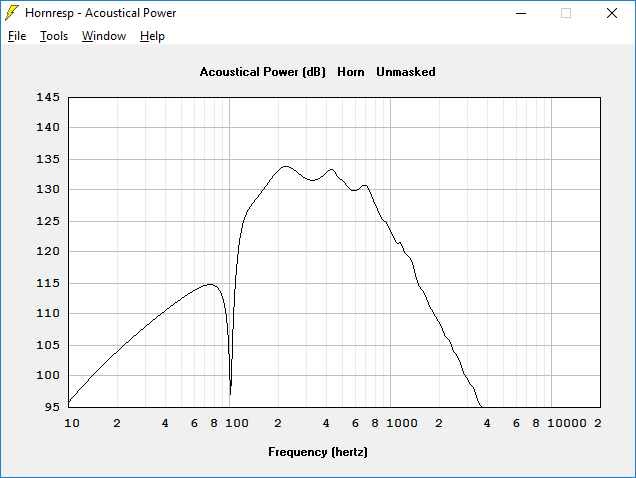

I am going to use an RCF HF94 horn with a Eminence N314T-8 HF driver and a single B&C 12NDL76 twelve inch in a folded horn. It is considerably less expensive, and considerably lighter (42 lb, 19 kg). Before I build this, I wanted to run the concept by some of people with more experience than me. The mid/bass will go from about 120 Hz up to 1100 or 1200 Hz. In my modelling with Hornresp, it is hard to get the horn to go that high.
My concept is to use the port and back chamber resonances to extend the upper end of the mid response. It is sort of a combination of a front loaded folded horn and a rear loaded transmission line cabinet with combined output. I split the horn and ports vertically the way Peter did to get the horizontal and vertical directivity of the mids to match more closely the 90H x 40V degree directivity of the compression horn. It is going to need a little boost between 700 and 1100 Hz, but is is still at least the same output as a direct radiator cabinet. The ports should give good cooling to the mid/bass driver and the handle cutouts should allow adequate airflow to cool the compression driver.
It is a bit of a goofy looking cabinet with the high horn and ports projecting forward. I kept the offset between the ports and the high horn small since they interact in the crossover region. The folded horn mid is 6 or 7 inches behind the horn, but I don't believe the horizontal directivity will be too bad since the folded horn output starts to fall off around 700 Hz. Each cabinet should be capable of about 130 dB/1m continuous which seems like it should match up pretty well with the 140 dB/1m capable subs.
The high horn chamber will mount to the cabinet with screws and gaskets to be removable so that the 12 inch is accessible from the front of the cabinet and is replaceable.
So, does this have a chance of working?

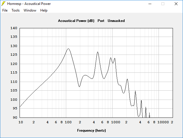

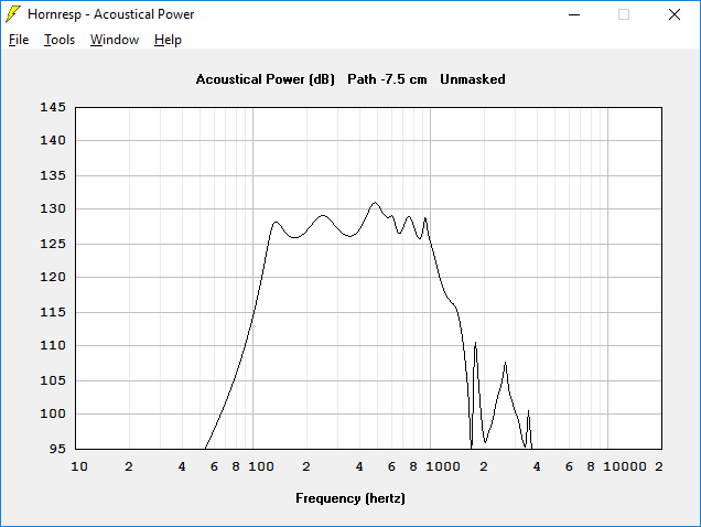

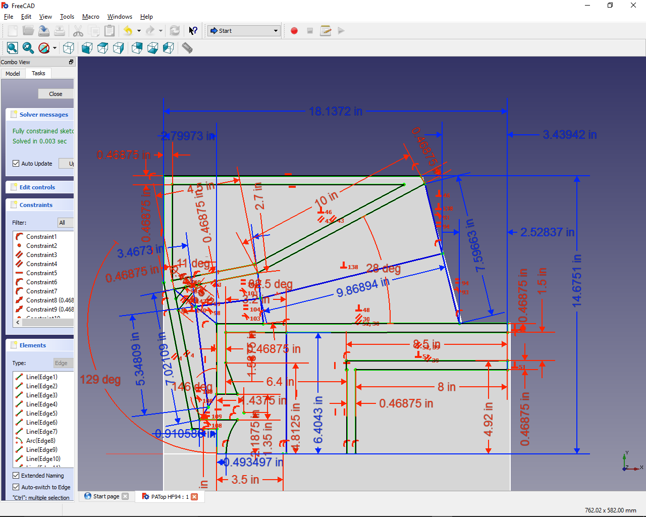

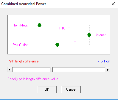

A bit of progress, a HF horn change and a couple of corrections.
I switched to an RCF HF94 horn since it is shorter and should still work well because the mid-bass goes up to 1000 Hz. It makes the cabinet smaller and pack better.
I changed the sim to 4 pi (full space) instead of 2 pi (half space), so the output should be more realistic.

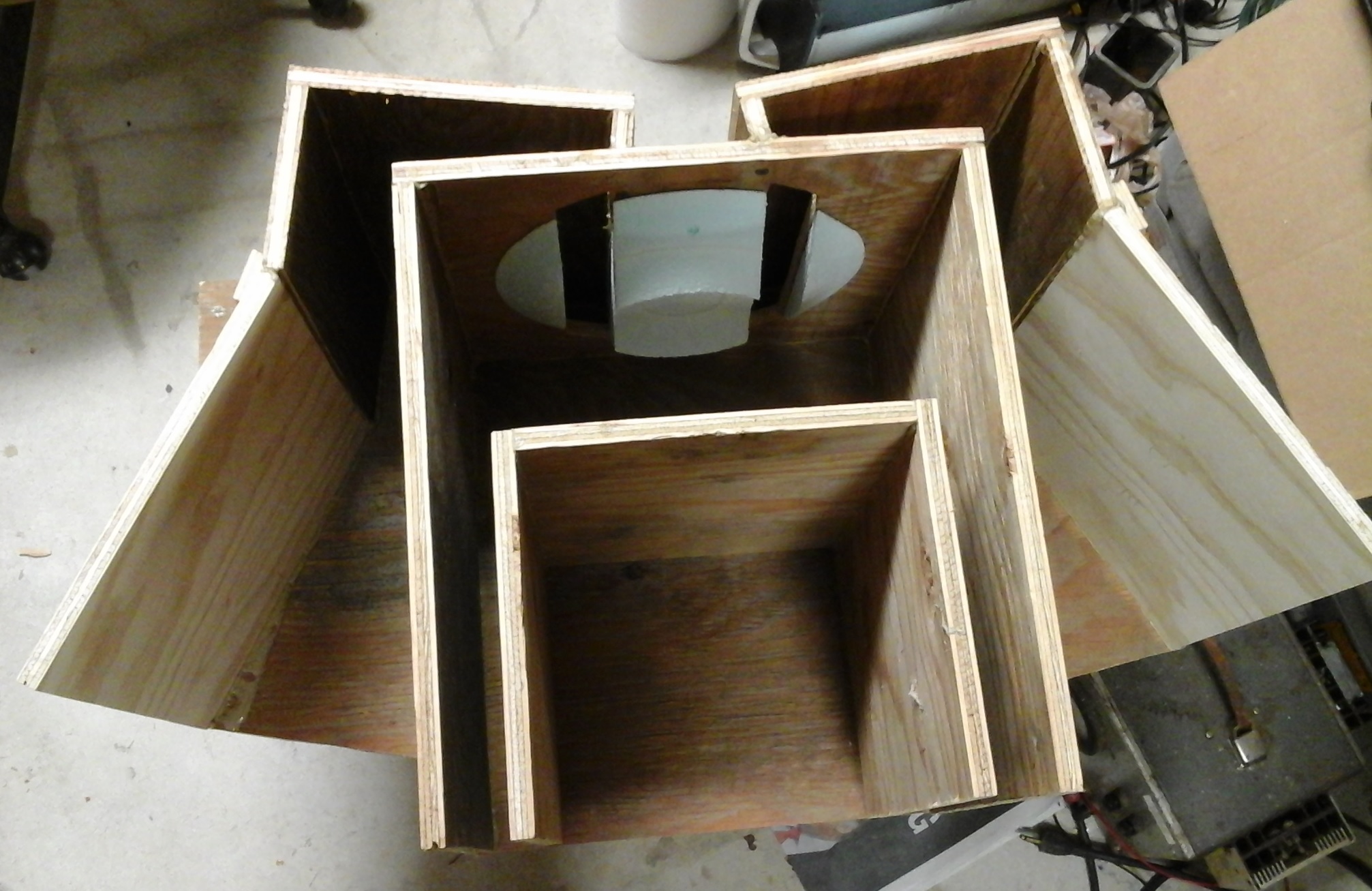

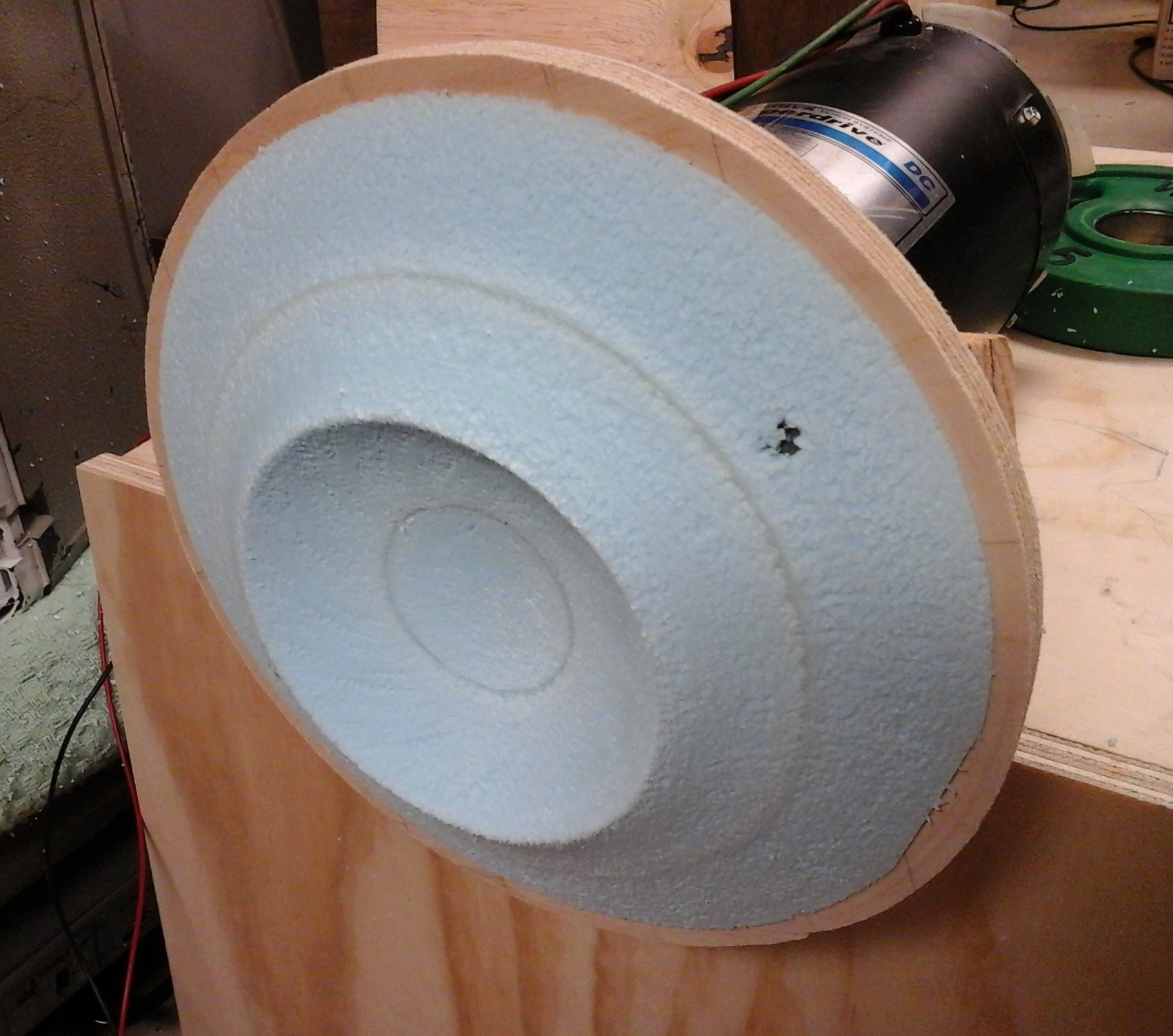

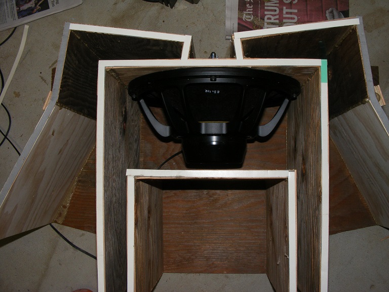

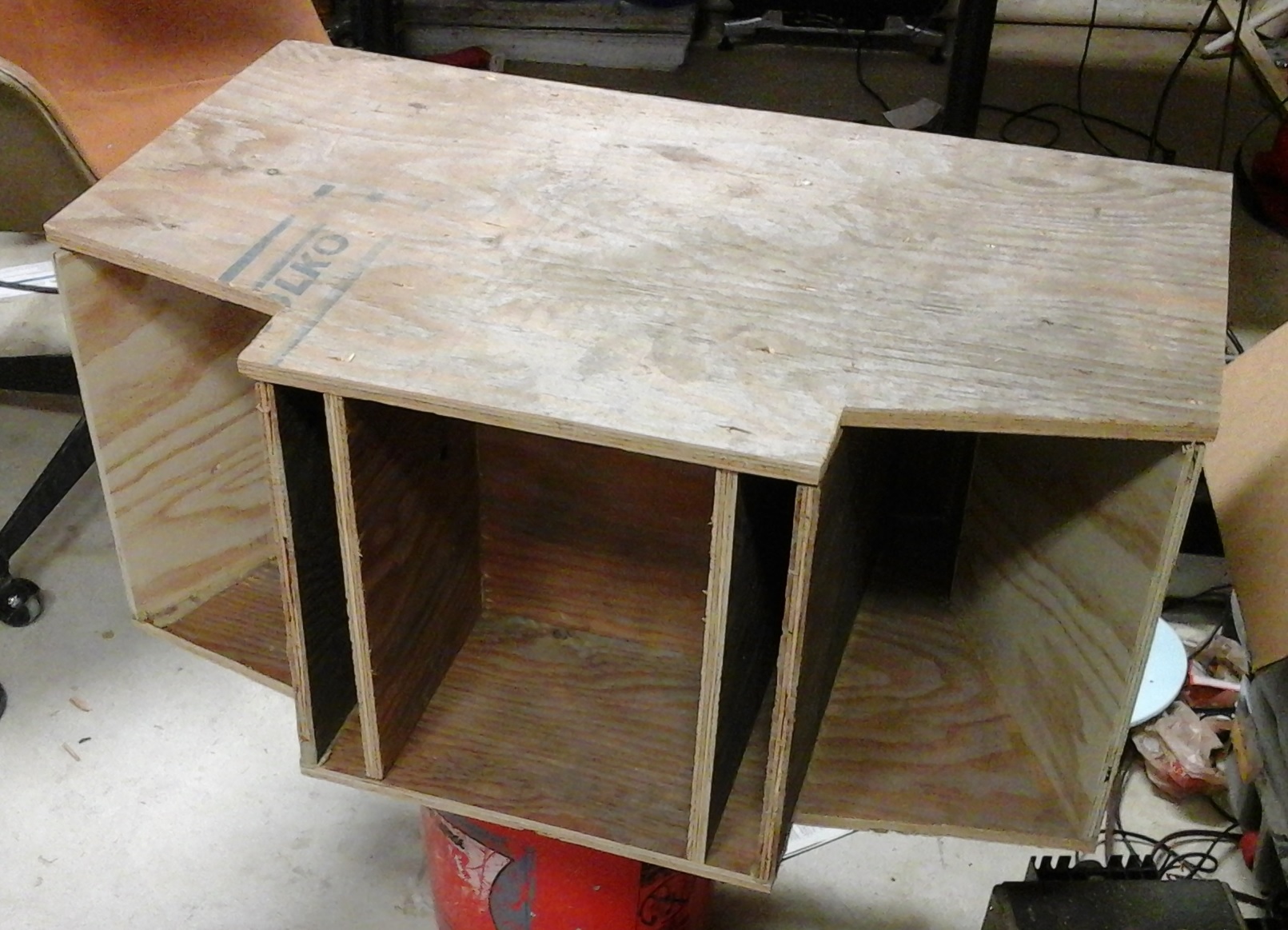

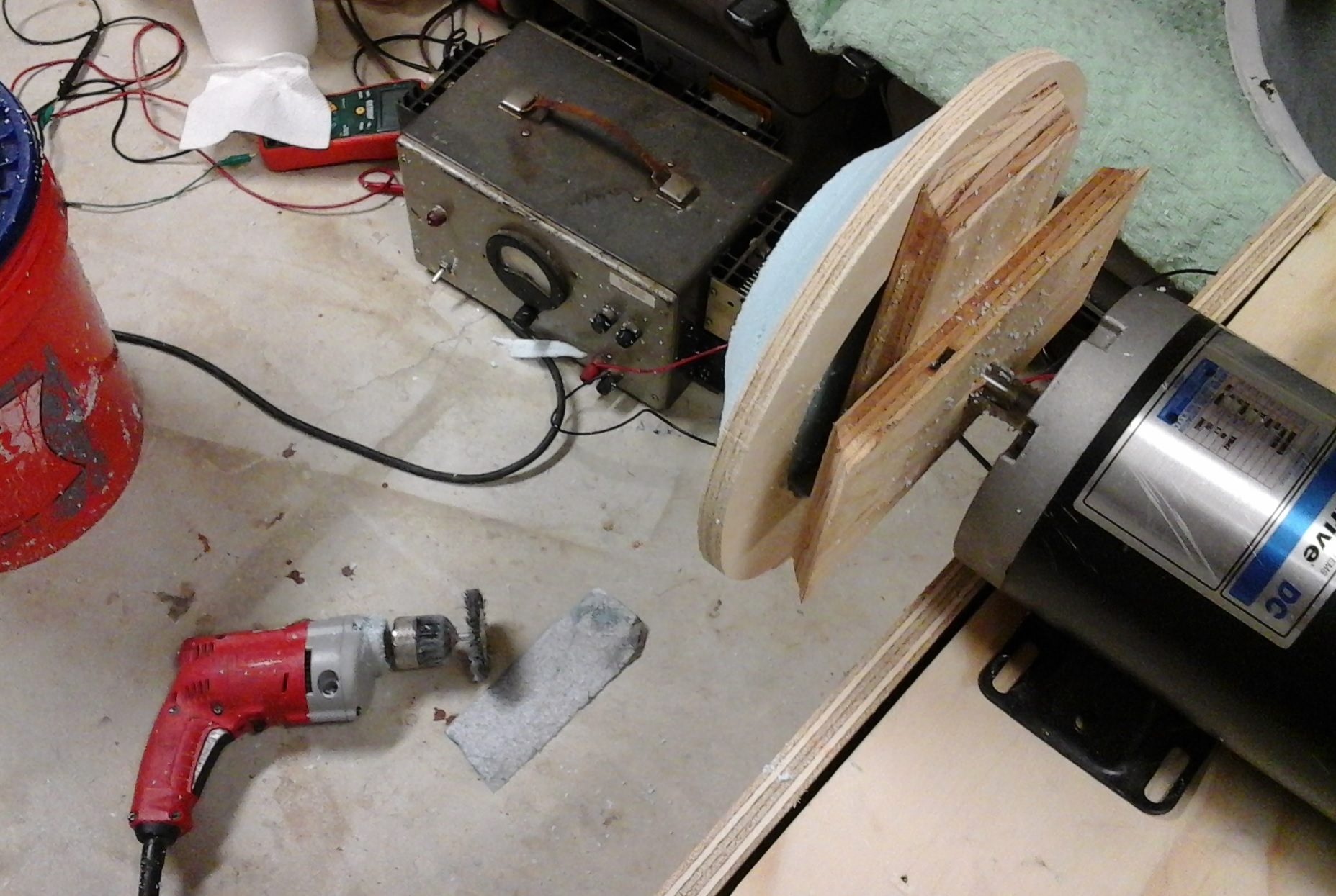

I started putting together a test box out of a piece of scrap 1/2" plywood sitting in the back yard (next time I will buy a sheet-- warped plywood is a pain). I made a makeshift lathe from a treadmill motor and used a wire brush on a drill as the cutting tool to carve a phase plug from blue polystyrene insulation.
And I made a mistake on the weight. I tried calculating based on the volume from the CAD model, but made a mistake somewhere.
The weight of the test box plus the components comes in at 42 lbs. Not bad, but a lot more than the 26 lbs I was thinking before.

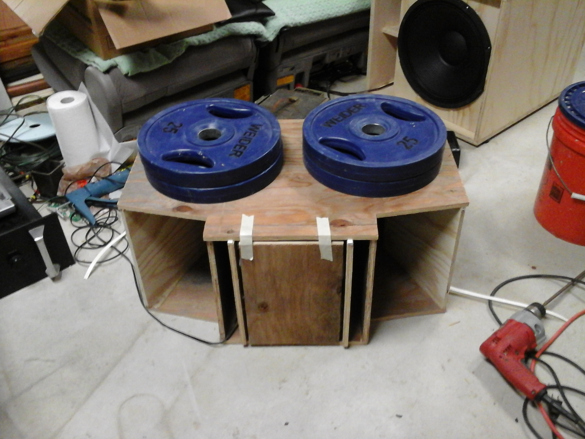

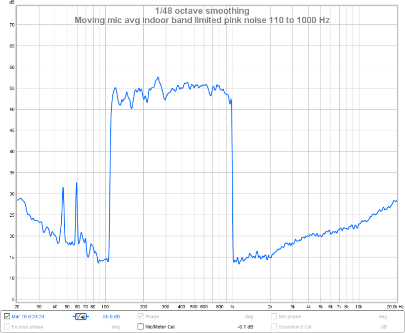

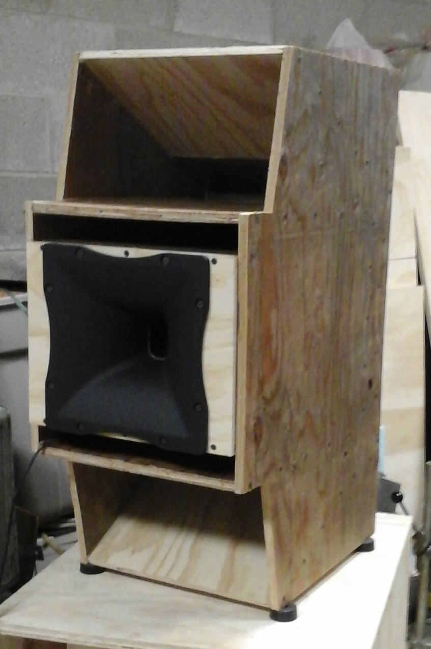

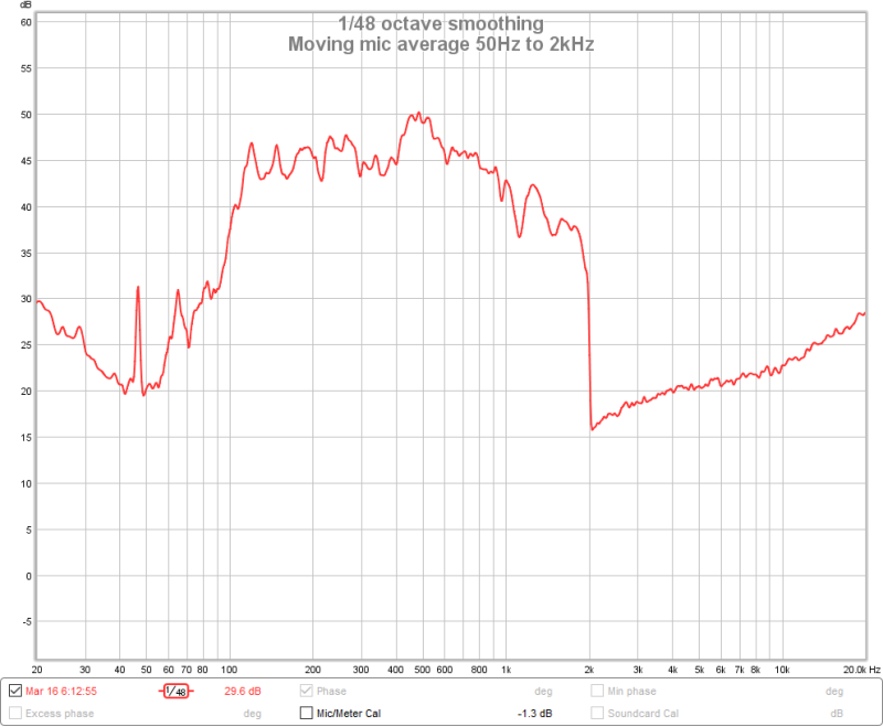

I have done a preliminary assembly and first test. I glued the horn and chamber panels to one side panel. I put weatherstripping on the edges of all the panels, put the other side panel on and put 100 lbs of weights on. I don't want to glue on the other side panel until I am satisfied that everythingis working well enough.
Unfortunately, there is snow on the ground outside, so I can't get outside for a reflection free test yet. I did the next best thing I know, which is a moving microphone measuurement at about 1 to 1.5 meters with band limited pink noise, roughly covering the 45 degree lateral and +-20 degree vertical beamwidth of the HF horn. I had a big suckout at 300 to 400 Hz until I put a panel and some insulation in the cavity for the HF driver and horn. The response compares reasonably to the Hornresp model. The levels are pretty low because I was testing at 4:30 AM while my wife was sleeping. The average level was 91 dB at 1/2 m in 1/2 space with 0.141V rms.
Lastly, I need the moderators to change the title of the thread from "A lightweight, high output 12NDL76 and HF146 top" to "A 12 inch horn loaded MTM top: 12NDL76 and N314T-8", since I changed my mind about which HF driver I'll be using and its not as light as I initially thought.
Marc

Here is a photo with the midbass mounted.
I just ordered the Eminence N314T-8 and the RCF HF94, so I may have some listening impressions by the middle of next week. Initial impression from listening to just the mid and a sub is that it has pretty uniform coverage when crossed at 1000 Hz. Not a lot of change in the sound of pink noise when I move around. It gets pretty flat with a -5 db Q=5 at 480 Hz and +2 dB Q=3.6 at 370 Hz. I am sure I'll be doing more tuning, but that got me in the ballpark
Construction was really easy. For the test box, I didn't even do any angled cuts except jigsawing the side covers. I just used lots of Loctite Premium PL to fill gaps. For the real boxes, there are two cuts at 11 degrees and four cuts at 9.5 degrees. I'll probably just cut everything at 10 degrees. Otherwise everything is square cuts at 12.5" wide. Eventually I'll clean up a drawing, but for now, if you are interested in dimensions, here is the sketch from the CAD model.
I need to make a 1/4" spacer to stand the driver off the back wall a bit. Diaphragm displacement is 3.7 mm max in Hornresp, but I want some margin.

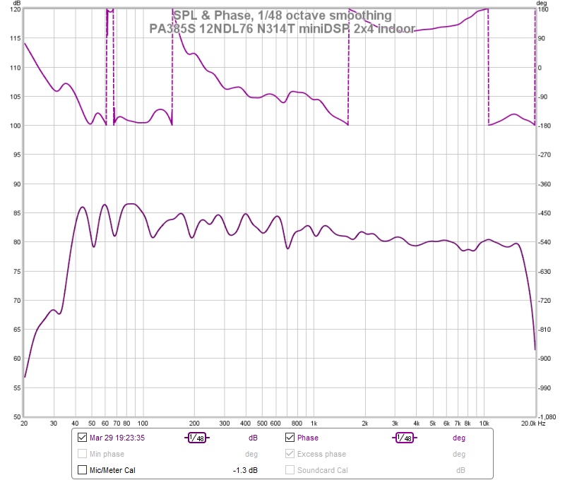

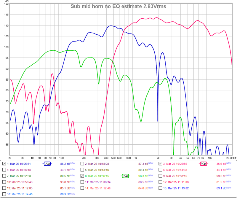

I got outside today and did some testing. It started to sprinkle when I was set up for 10 minutes. I managed to get in about an hour of testing and tuning before I chickened out and packed up. I got the highs and mids EQed and well integrated, and the bass EQed but not integrated to my satisfaction yet. I was unable to get any polars yet.
I stacked two subs, with two more empty sub cabs on top, then the top. The horn was 98 inches off the ground. I am using a miniDSP 2x4 IIR for crossover and EQ.
First plot shows the each driver without crossover (the compression driver I used a Butterworth 48dB/oct at 500 Hz for protection). The second shows after equalization.
I took pink noise SPL measurements at ground level at 5 meters along with RMS voltage measurements of each section with its EQ and crossover and calculated average sensitivity in band for 2.83 Vrms at 92 dB for a single sub, 107 dB for the mid, and 111 dB for the compression driver and horn. Fully powered that should be 140 dB for eight subs at 1000 W each, 136 dB for two mid cabinets at 400 W each, and 134 dB for two high horns at 100 W each. Looks like I need more sub (which I won't be able to move), or my tops will just be loafing along (it probably sounds better that way).
I only got to listen to a little music and not too loud, but I liked what I heard.

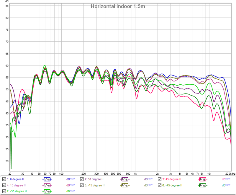

I took the first crude polar measurements this morning. Just rotated the speaker on top of the subs in my cluttered basement. The transition at the 1000 Hz crossover looks good to me. The directivity is nice and smooth. The anomalies at 8kHz are LR asymmetric, so it's probably the room.
Marc
