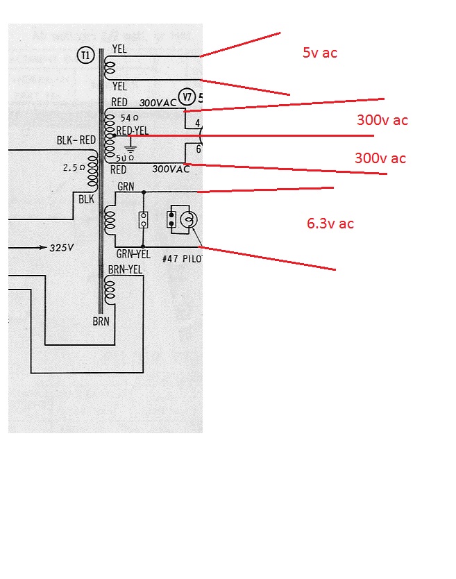

Since you are assuming the PT is toast, it gives you the 0 cost option of pulling the tubes and firing it up to do some A/C voltage checks at the rectifier socket and for heater voltage at one of the other tube sockets.
Ok, correct me if I'm wrong....You're saying to just remove the rectifier, and put a multimeter to the circuits to check voltages. I know I'll need to have speakers hooked up ( or something hooked across the speaker posts ), but doing this won't cause any damage to the rest of the amp?
With the rectifier PULLED out of the amp, you do not need to have speakers hooked up as no DC voltage will be developed in the amp. Look at the partial schematic and place your VOM where the red lines are drawn, and you should see the ac voltages as indicated. Dont worry about the winding at the bottom of the transformer, it supplies the pre-amp when the turntable is being used.

Look at the transformer diagram, you will see that there are two(2) 300 volt windings. actually its a 600 vac winding with a center tap. you should get 600 volts between the two red wires, and 300 volts between the red/yellow and the either red wires (check both). Remember with NO load the voltages will be a little high and thats OK.
Since line voltages are higher these days the B+ will be 10-15V higher than the diagram voltages. You expressed a concern that the 5U4 was bad, if you replace it you could or even should go with a 5R4GYB type which has a lower output than the 5U4, (higher voltage drop). It will help keep the B+ closer to the original values. The original 9302 B+ (325v) pushes the 6BQ5's into their high range from the start so it's a good idea to not let them get any higher if you can avoid it. Not a critical concern, just something to be aware of. If the 5U4 is still good, it's no biggy to keep using it to test and troubleshoot.
