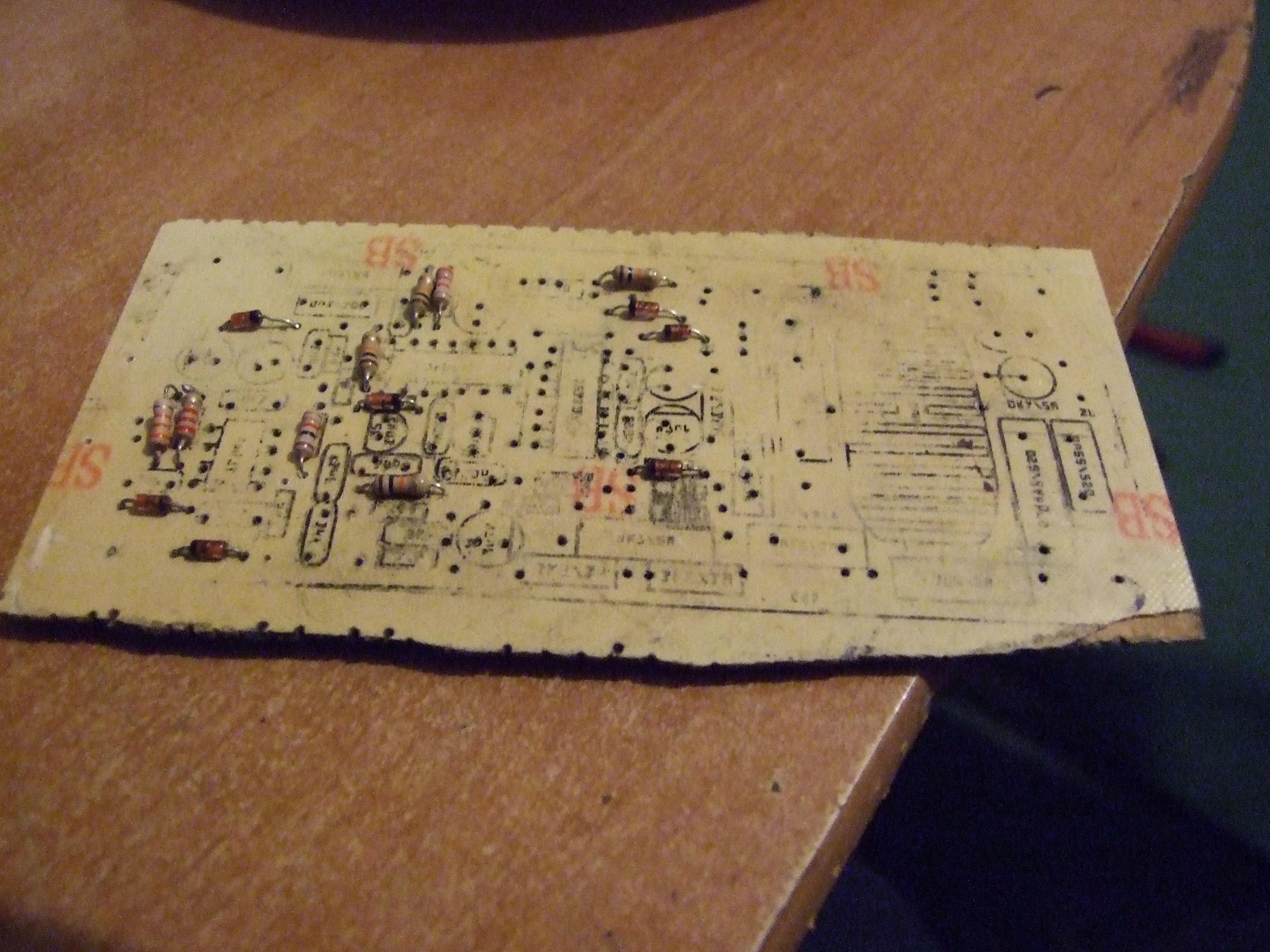

still waiting for your smps posti have made a smps i will post photos and plans
a few photos more to come. th art work and schema are for the revised version it works well.
the pics and art work
the latest version 3u space with everything on one board
http://www.diyaudio.com/forums/class-d/226812-my-class-d-amp-36.html#post3536038

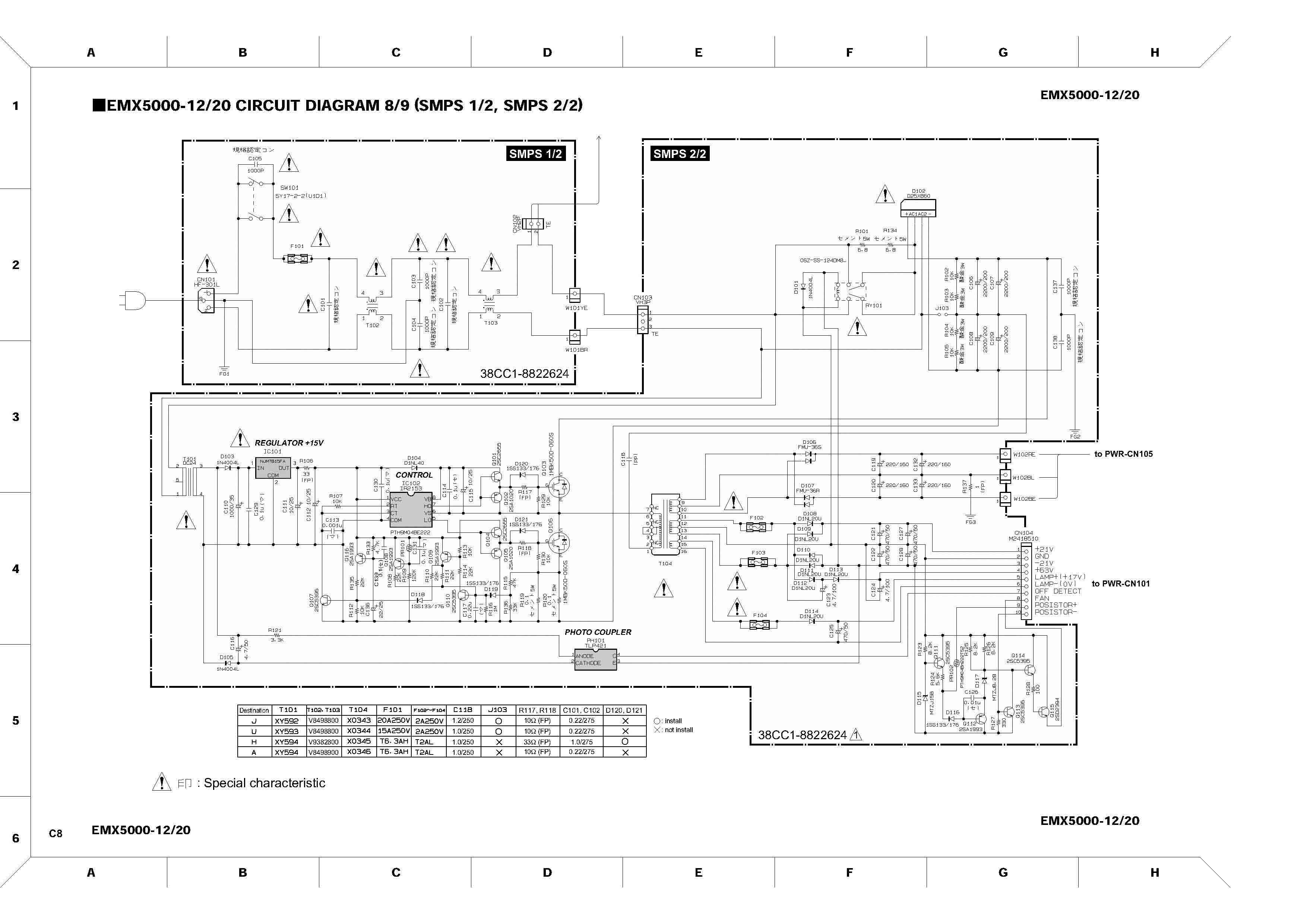

Hi Steve,
...thanks for adding the link to your newer version with larger creepages.
@ All:
Safety is a hot topic in offline SMPS.
No matter which country you live in and which rules/standards are applied there - all safety standards require large creepages between primary and secondary which feds your amp. Typical safety standards have a lot of similarities and require double or reinforced isolation of the secondary side audio supply vs primary.
In Europe EN60065 is the relevant standard.
Depending on the very details of your circuit most offline SMPS for audio power amplifiers end up in a min creepage requirement in the range between 5mm and 8mm.
- These creepages also must be realized inside the transformer design.
- Furtheron there are requirements on the min thickness of isolation or min number of layers. Heavily simplified rules of thumb:
Min thickness in case of single layer isolation is 0.4mm. If mechanically or thermally stressed go for 0.5mm at least.
If the material is thinner (i.e. isolation tapes), use at least three layers.
P.S:
With high rails on the secondary such as +/-90V you are again in the dangerous zone, even with perfect isolation vs. primary, because the amp can deliver high voltages at the speaker terminals ==> using isolated speaker connectors alike the Speakon connectors from Neutrik becomes necessary for a safe installation.
Disclaimer:
These informations are a rough simplification and not sufficient for a fully safety compliant design.
Careful study of the safety standards is necessary.
Besides the obvious safety standard (like EN60065), further special standards for safety relevant components like transformers and optocouplers may apply.
No guarantee on potential errors.
In case of doubts, consult a specialized safety engineer or test house.
