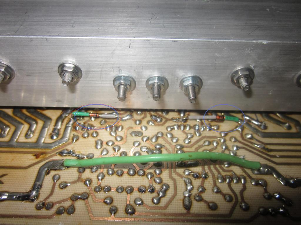

Hi..Engel..no..no...new pattern..H900tef used original layout H900. Like this:

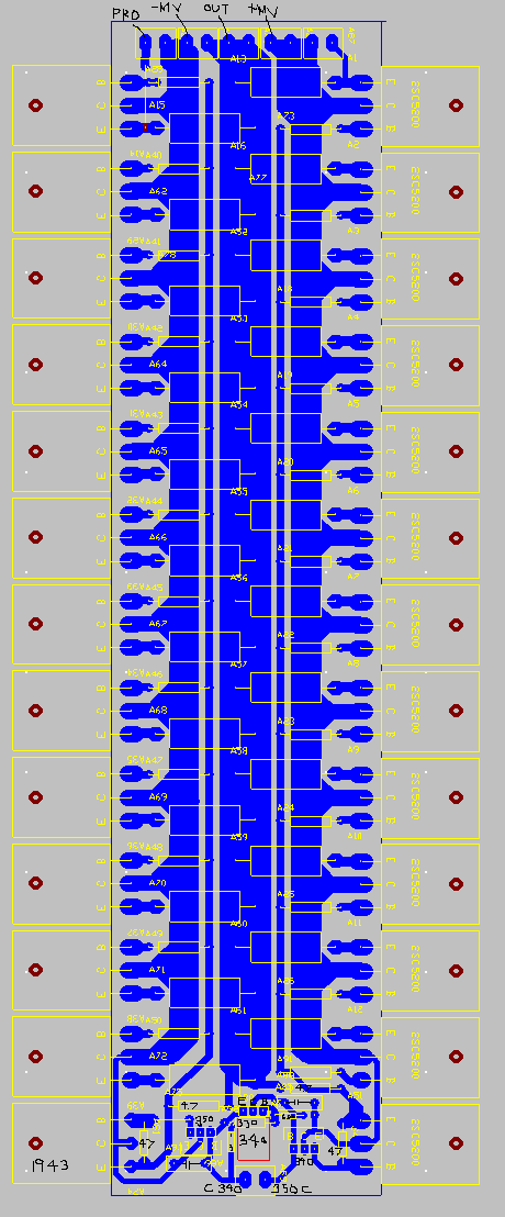

can somebody share tripple ef lay out
hopefully 7 pairs or up
hopefully like SOERDJANTO pcb,''BUT FOR SHARE,NOT FOR SALE''
IRVYNJAY lay out of step can be use for lay out like soerdjanto and chestap style of output layout and also vertex lay out,i see this output lay out advantage of consuming space to prevent long heat sink,
