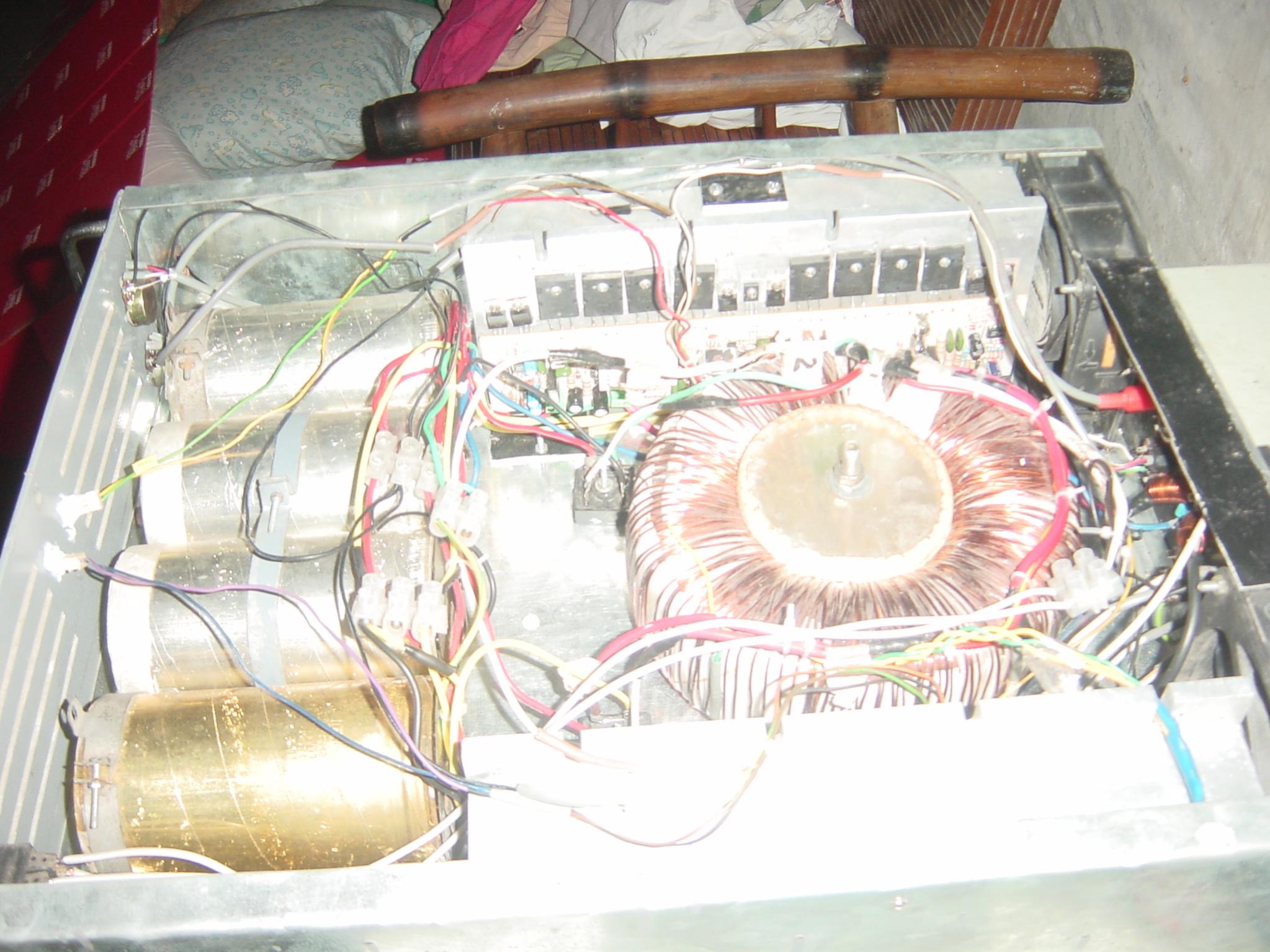

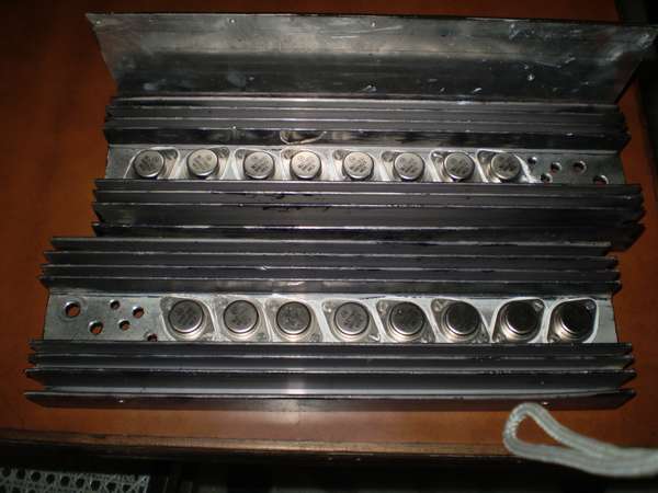

nice work, can u take high quality images of ur amp and share it.
cant see mjl transistors.
what is the dc volt ur providing to amp?

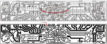

h900 with dirty sound noticed on hi's
i try replacing the op amp but still sound is dirty, i then found a broken track see attachment,other builder better make their track heavier or thicker,now the amp is sounding very clean both channel are working sounding clean.
feeding 50-100hz no load the amp give me about 90vac,well i'm happy with that comparing to my old prevoius amp in ab lower power but higher heat dissipation,h900 is running very cool.
