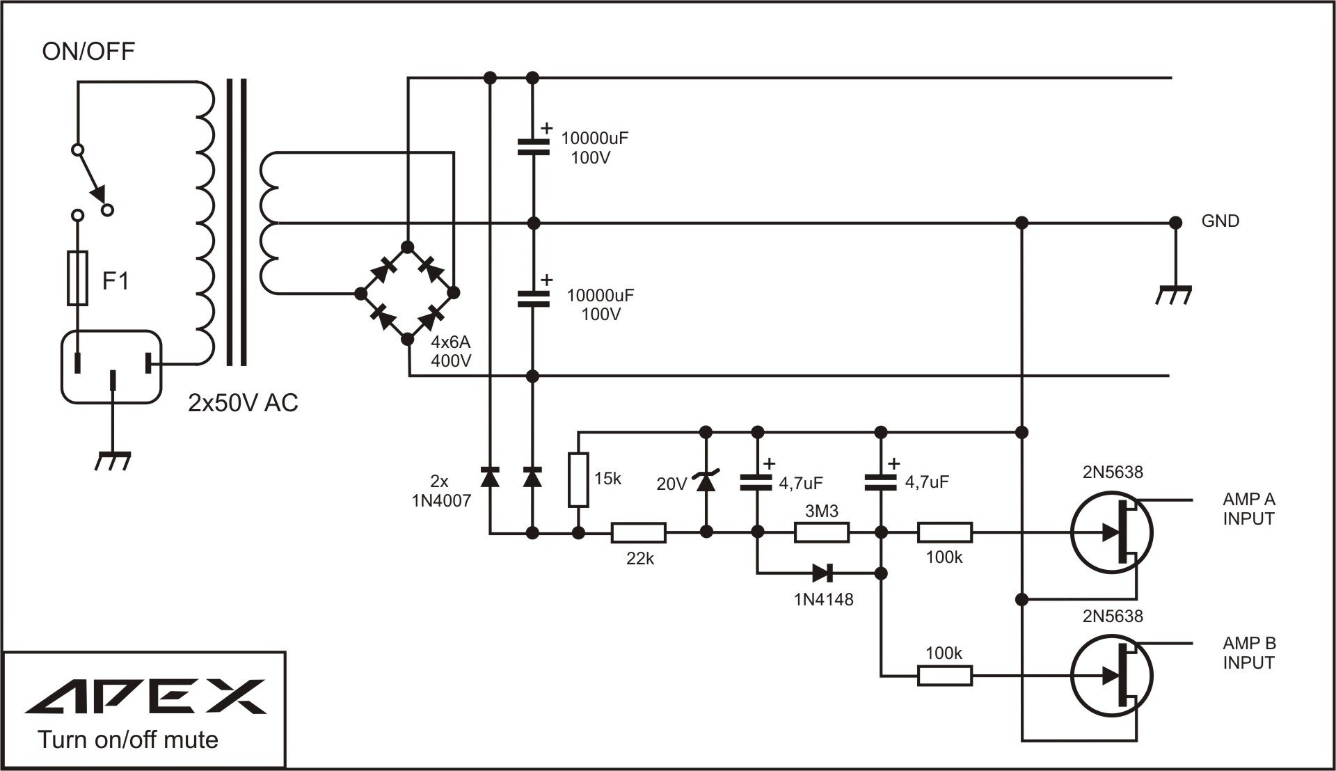

Hello,...
there was for longer time schematic from Apex for mute turn on delay with shorting inout to GND via Fets
cant find this schematic, can somebody post ?
Which schematic............?
it was small circuit shorting input to GND with Fets for Turn on mute
schematic below .....
Alex.
if you have circuit description too... this will be great to finished my project
thanks
