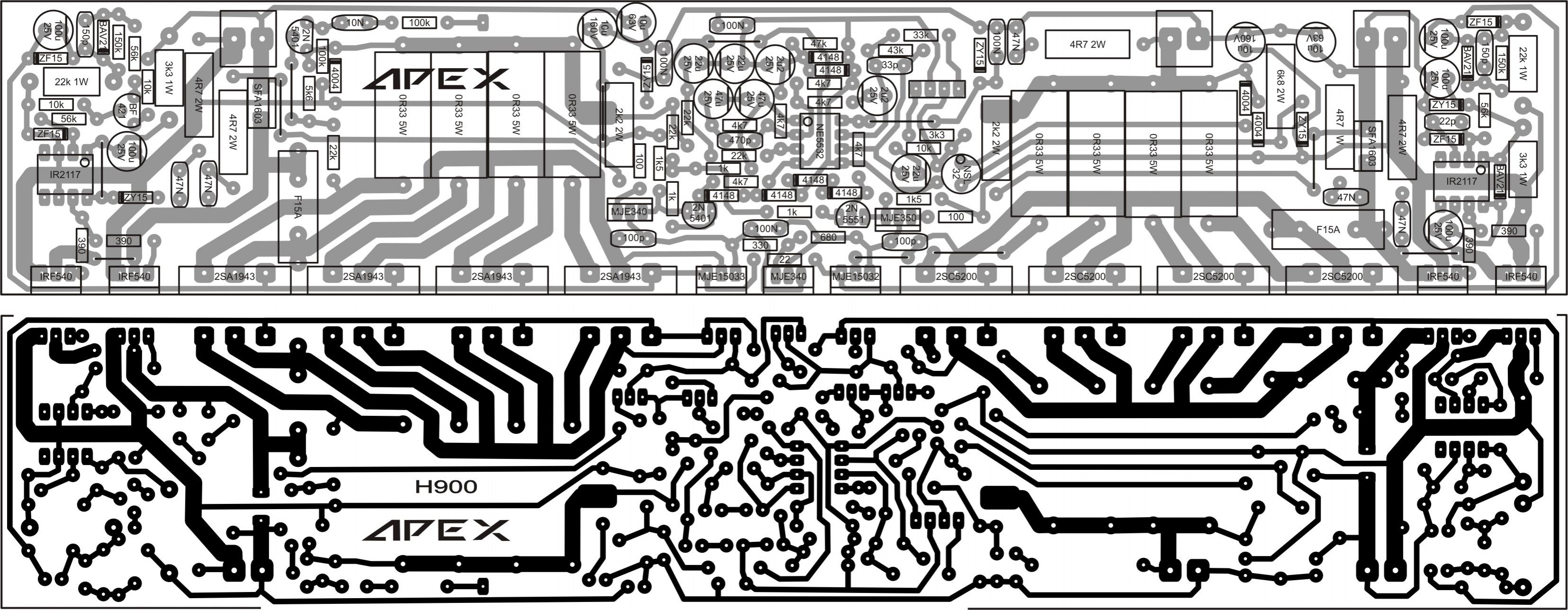

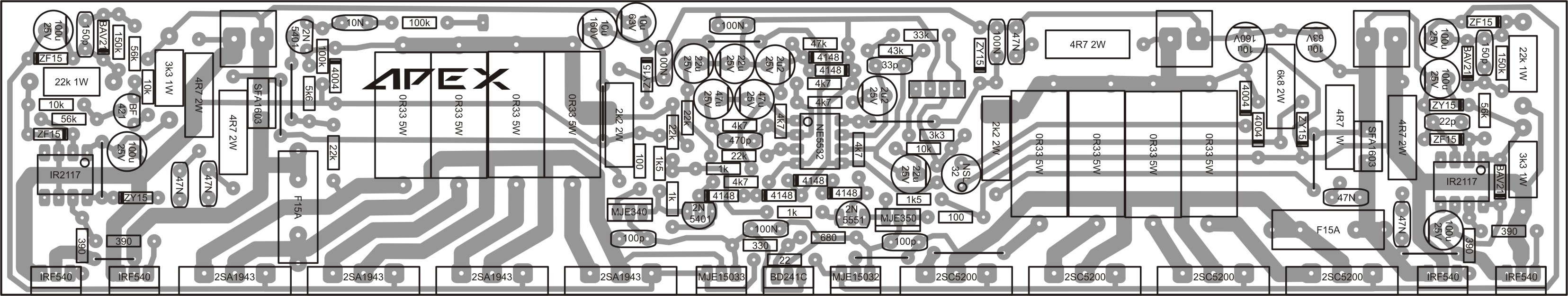

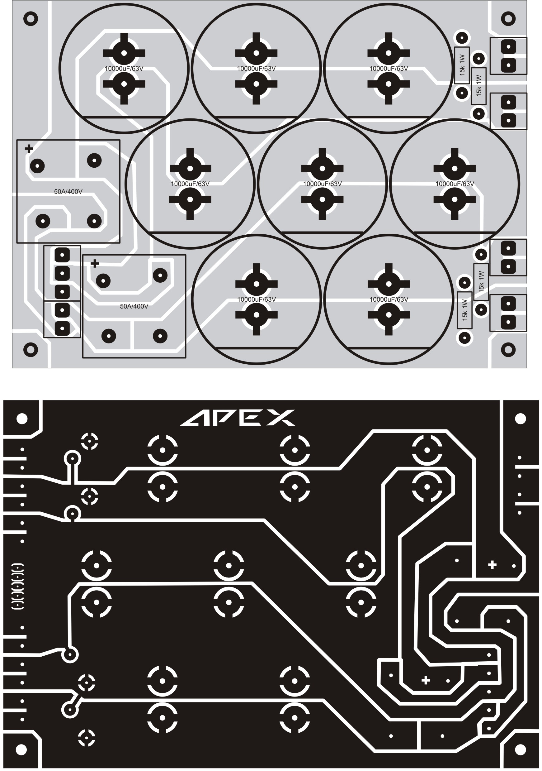

hi apexaudio
greetings trying to make your amp have almost made pcb pattern lots of
hard work you mentioned protection circuit has it a different pcb or can any other
dc protection circuit be used as i have some protection circuits ready
1 for commutatordiode can 2 byg 80 diodes be used in parallel
2 advise me output tranistors mjl 21194 mjl 21194 or 2sa5200 1943 wich combination shoud i use
3 power supply schematic would make things easier as i am making h class first time
4 should i use high speed bridges or normal bridges
5 any tips while making would be useful
thanks for your circuit and support
thanking you
andrew lebon

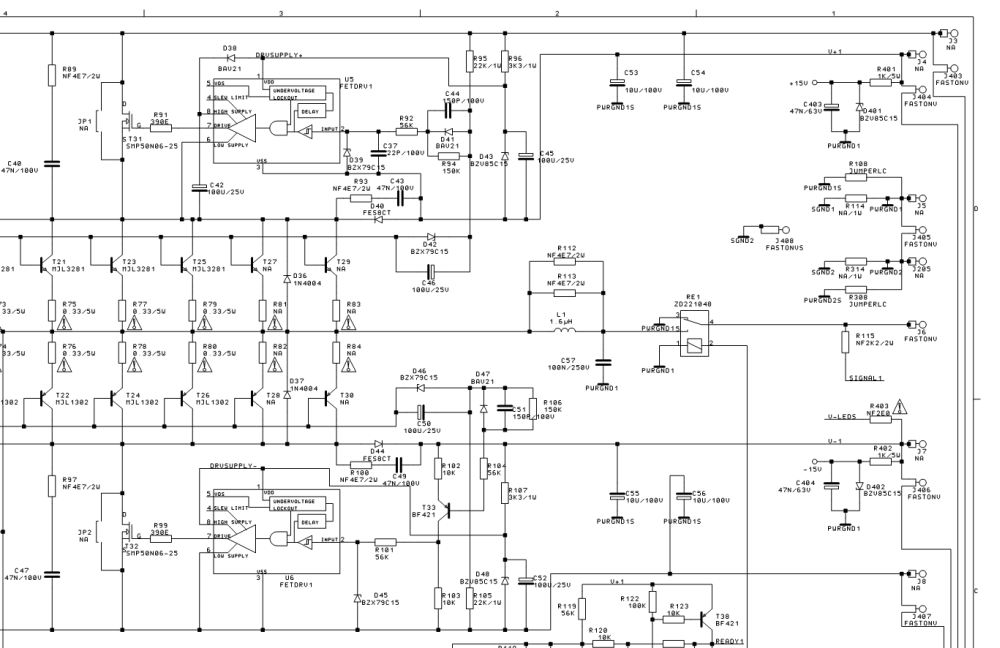

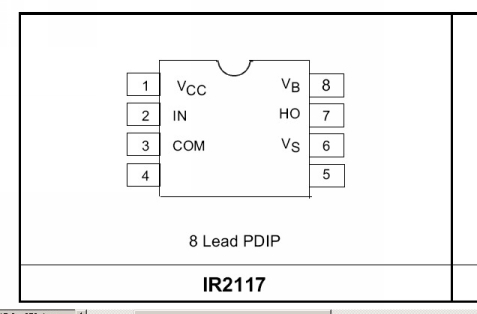

Hello apexaudio
To know more about the IR2117, I've download the spec-sheet, in this document the pin 3 are the ground, in your Apex H900 the pin 3 are named VSS, is it the same ground pin with VSS name ?
I presume that the 4R7 resistor and 47NF cap across the SFA1603 are to reduce the switching noise of that SFA1603 ?
Thank
Bye
Gaetan
Thank
Bye
Gaetan
This is a floating high-side gate driver. It uses two supply voltages: Vcc to COM, and VB to VS. VB to VS voltage is usually generated through a bootstrap capacitor and diode. This capacitor is charged when the MOSFET is turned off and it keeps the floating part of the IC powered when it is turned on. Capacitor value determines the maximum time it can be kept turned on.
Certain rules have to be followed: The most important one: VS must not go below COM, altough negative transients are allowed with some restrictions. VS can temporarily go 5V below COM without problems. Additionally, VS can go up to (VB-VS) volts below COM but any change in input signal will be ignored during this time.

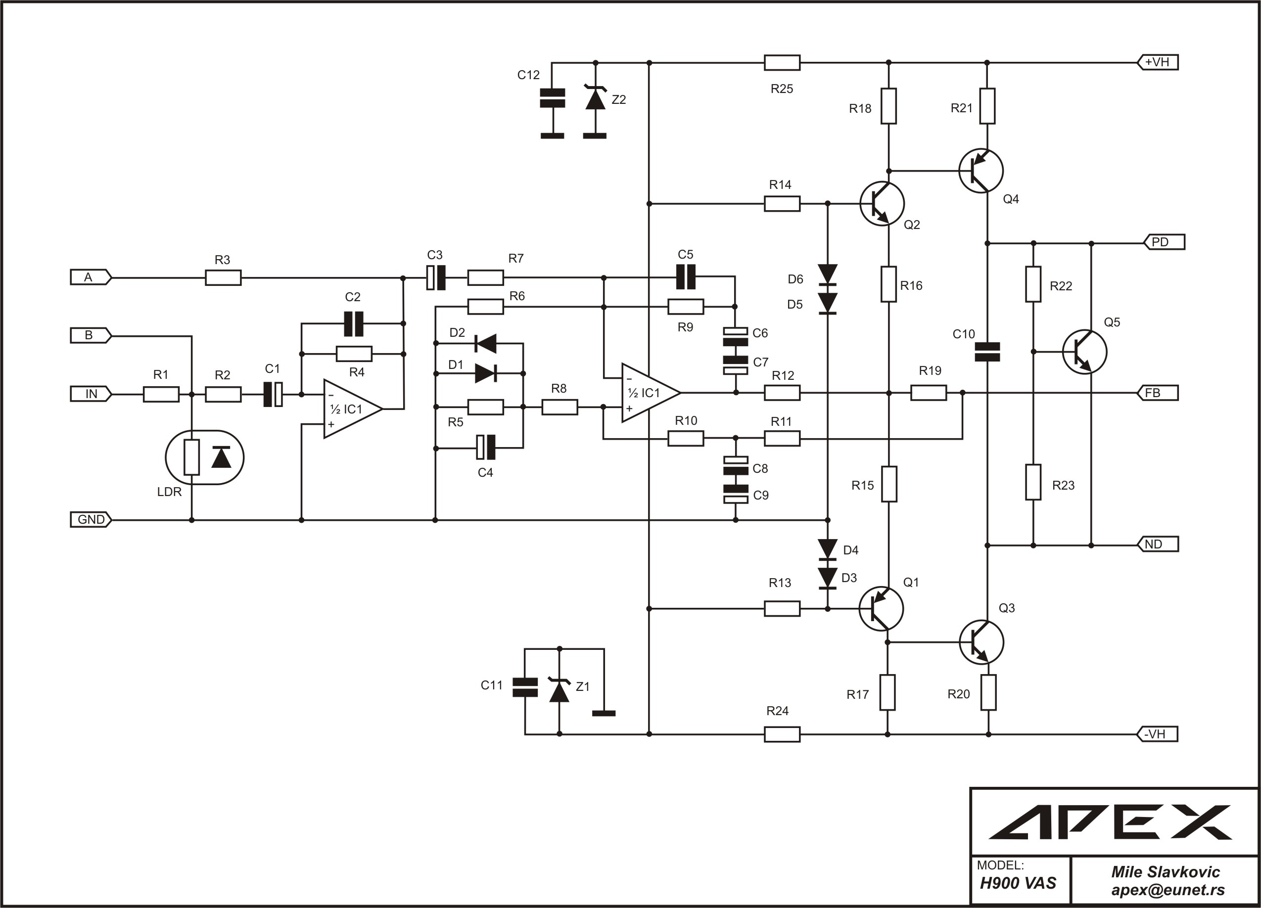

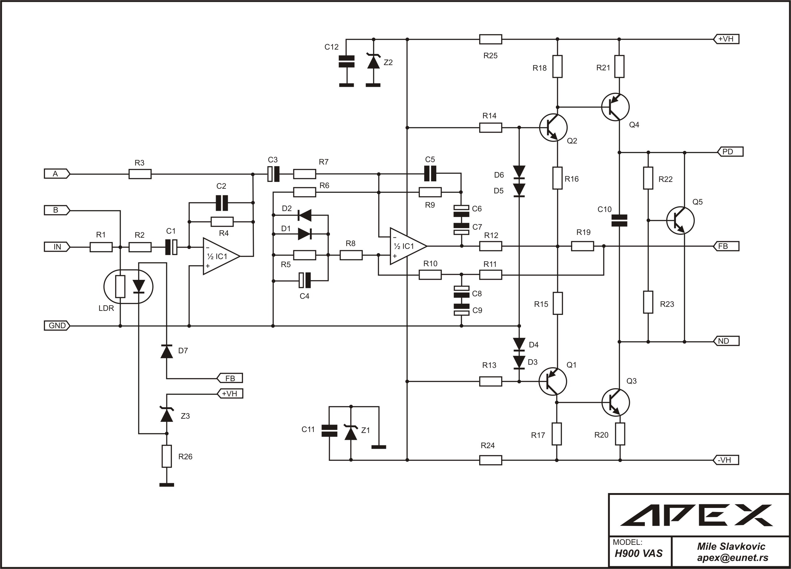

H900 VAS Part List:
R1-3k3
R2-10k
R3-33k
R4-43k
R5-47k
R6,R7,R8,R9,R13,R14-4k7
R10,R11,R19-22k
R12,R15,R16-1k
R17,R18-1k5
R20,R21-100R
R22-680R
R23-330R
R24,R25-2k2/2W
C1,C8,C9-22uF/25V
C2-33pF
C3,C4-2,2uF/63V
C5-470pF
C6,C7-47uF/25V
C10,C11,C12-100nF/63V
D1,D2,D3,D4,D5,D6-1N4148
Z1,Z2-ZY15V
Q1-2N5401
Q2-2N5551
Q3,Q5-MJE340
Q4-MJE350
IC1-NE5532
LDR-NSL32

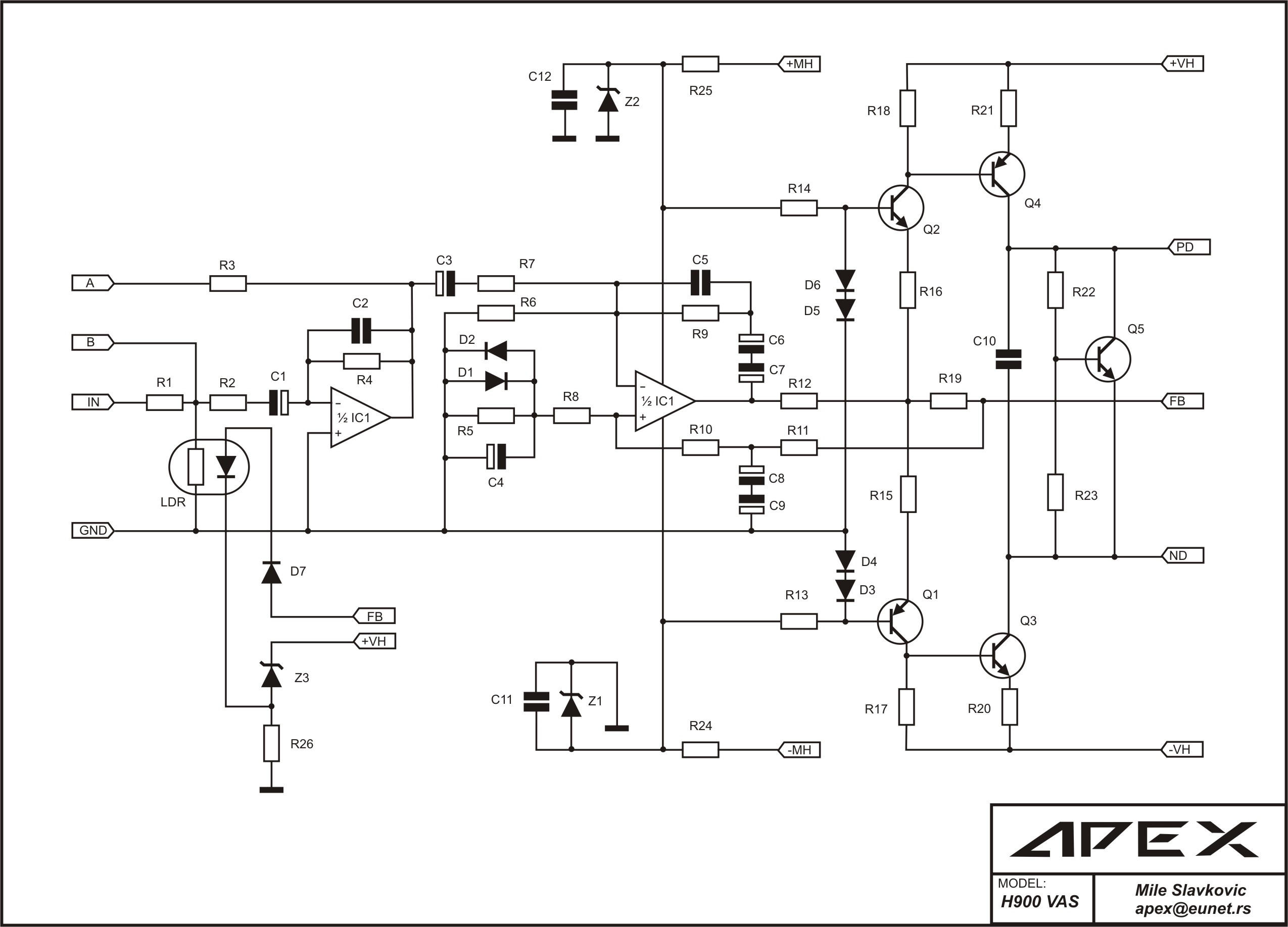

This circuit is for example, I will post limiter (LDR) driver circuit and protect circuit.Hi Apexaudio,
It seems LDR is incomplete as a function.
- 900W H-class PA Amp with Limiter
