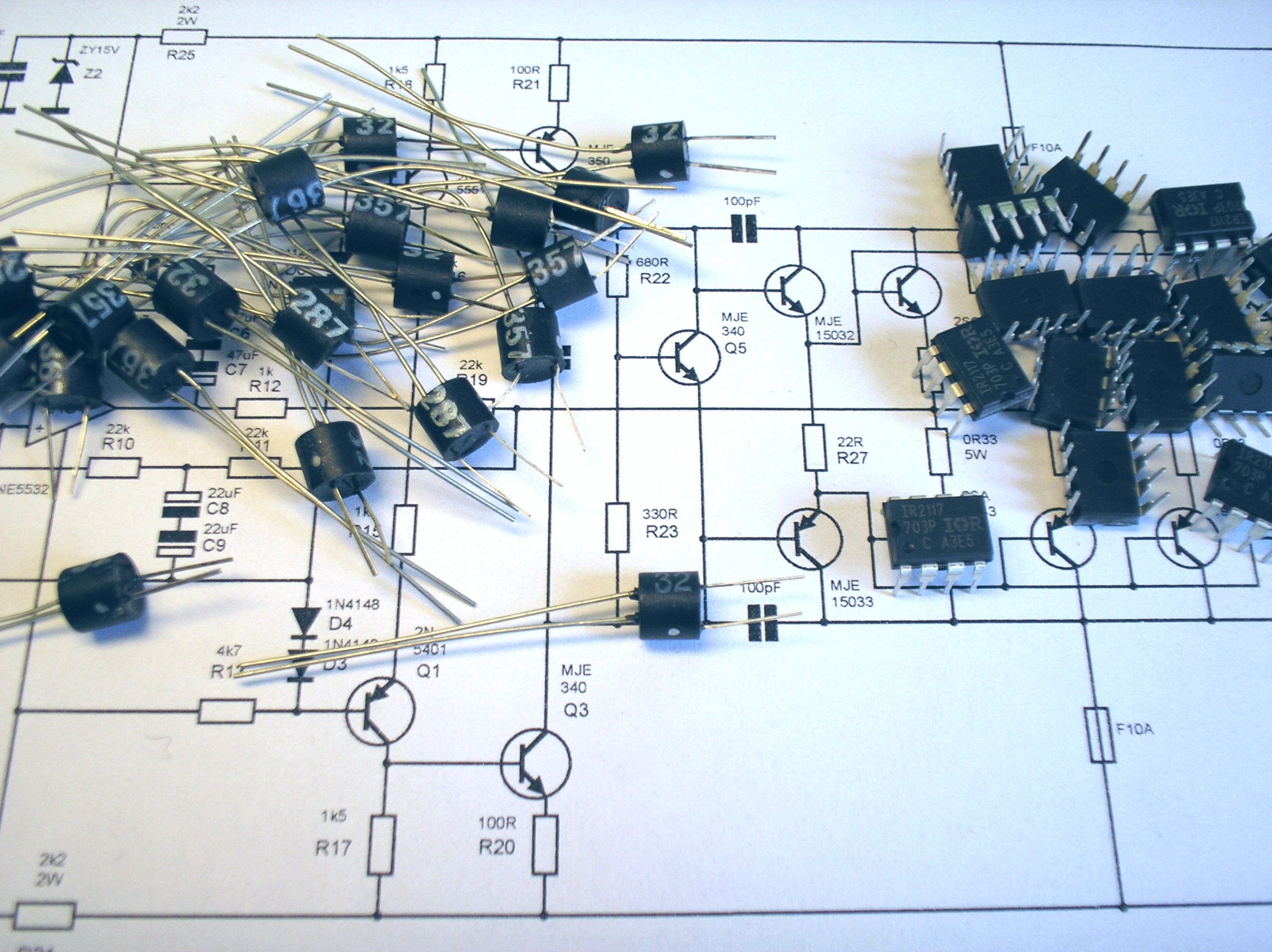

h900 would be very interesting
i have to use what i already have as of now
do you have the link of this supplier from australia?
i already have the pcb for h900
and other parts
except this nsl32 and ir2117
but i'm not closing doors upon building h900
as of now since h900 and b500 parts are almost the same
its not that bad for me to go for the b500
as apex told me
b500 can give 2x450w @ 4 R
55-0-55ac pair of 20,000uf using a big torroid
good luck to your h900
i will find my way finding this ir & nsl
at the same time building b500
regards
Good luck with building B500, this is much superior amplifier more than look like. Using OP amps in this circuit as AC bufer and DC servo is adventage than similar design, and give beter muching, beter offset than bad descrite diff. This is PA amplifier with HI-FI sound.h900 would be very interesting

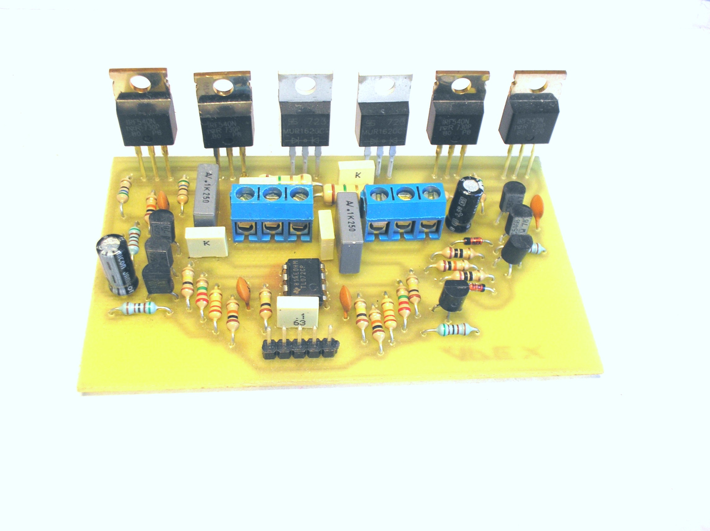

Hi, Apex..I want to confirm about layout PCB step driver with TL 072, I crop the picture and with code colour red in the bottom side. Is right value 47pf not 0,1uf??

Right value is 47pFHi, Apex..I want to confirm about layout PCB step driver with TL 072, I crop the picture and with code colour red in the bottom side. Is right value 47pf not 0,1uf??
http://upload.kapanlagi.com/h/20100414092340_APEX_Hclass_Power_DriverMON2_4bc5272cc7a92.jpg
I can give U idea how to use step driver using tl072 with B500, but I have no any pcb for amplifier with integrited this step driver. U must design PCB by yourself.apex,
