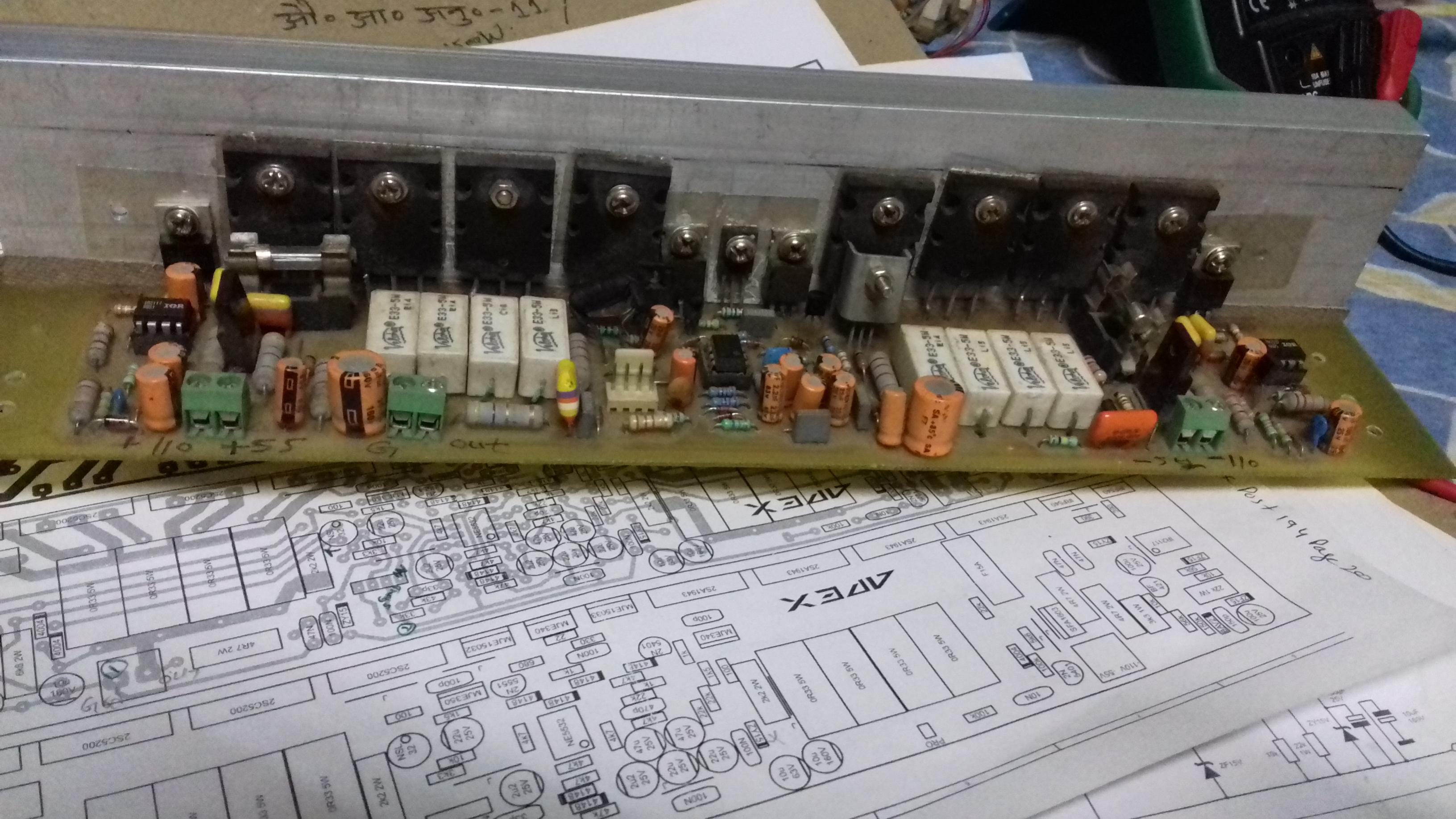

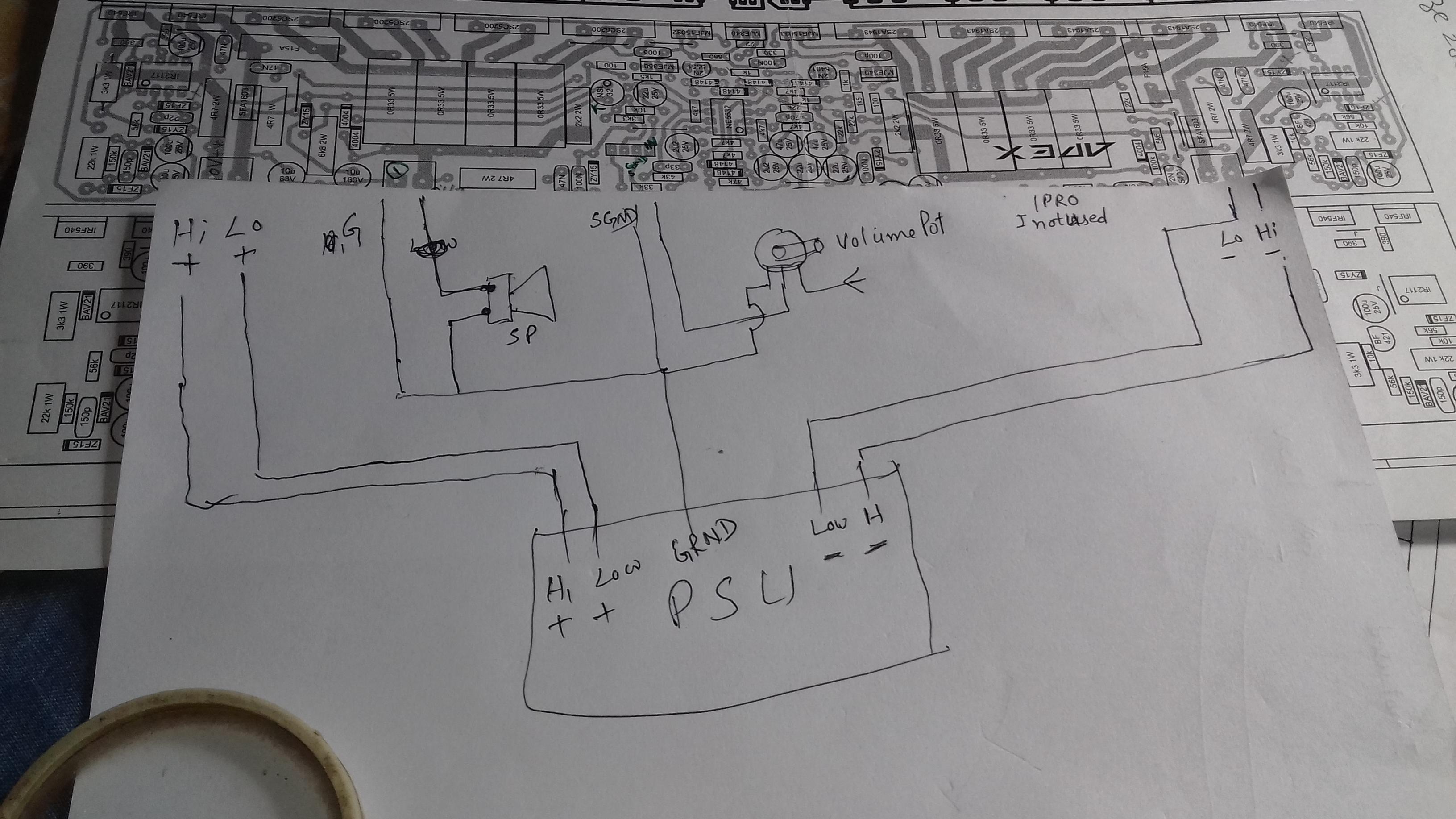

In my h900 2sa1943 heated and suply is as following
Positive side.67dc(high side)1.3vdc(lower side)
Negative side 27vdc(higher side)31vdc (lower ) please solve me
I think oscillation,
I remember there are no capacitor in scheamatic at drivers transistor between b and C
Try 500 pf for each and look again

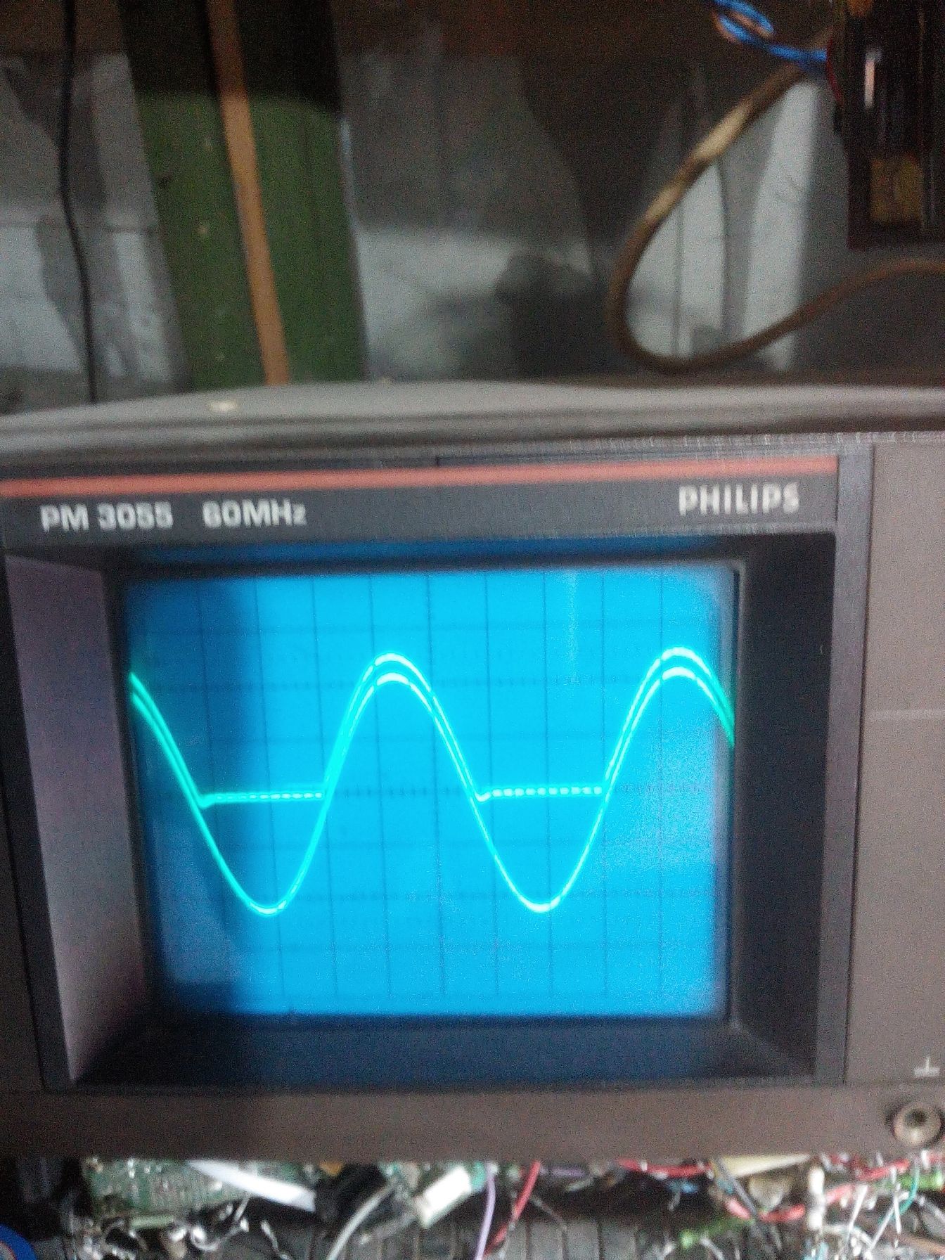

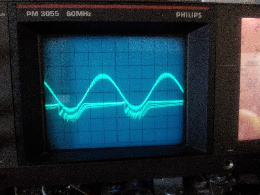

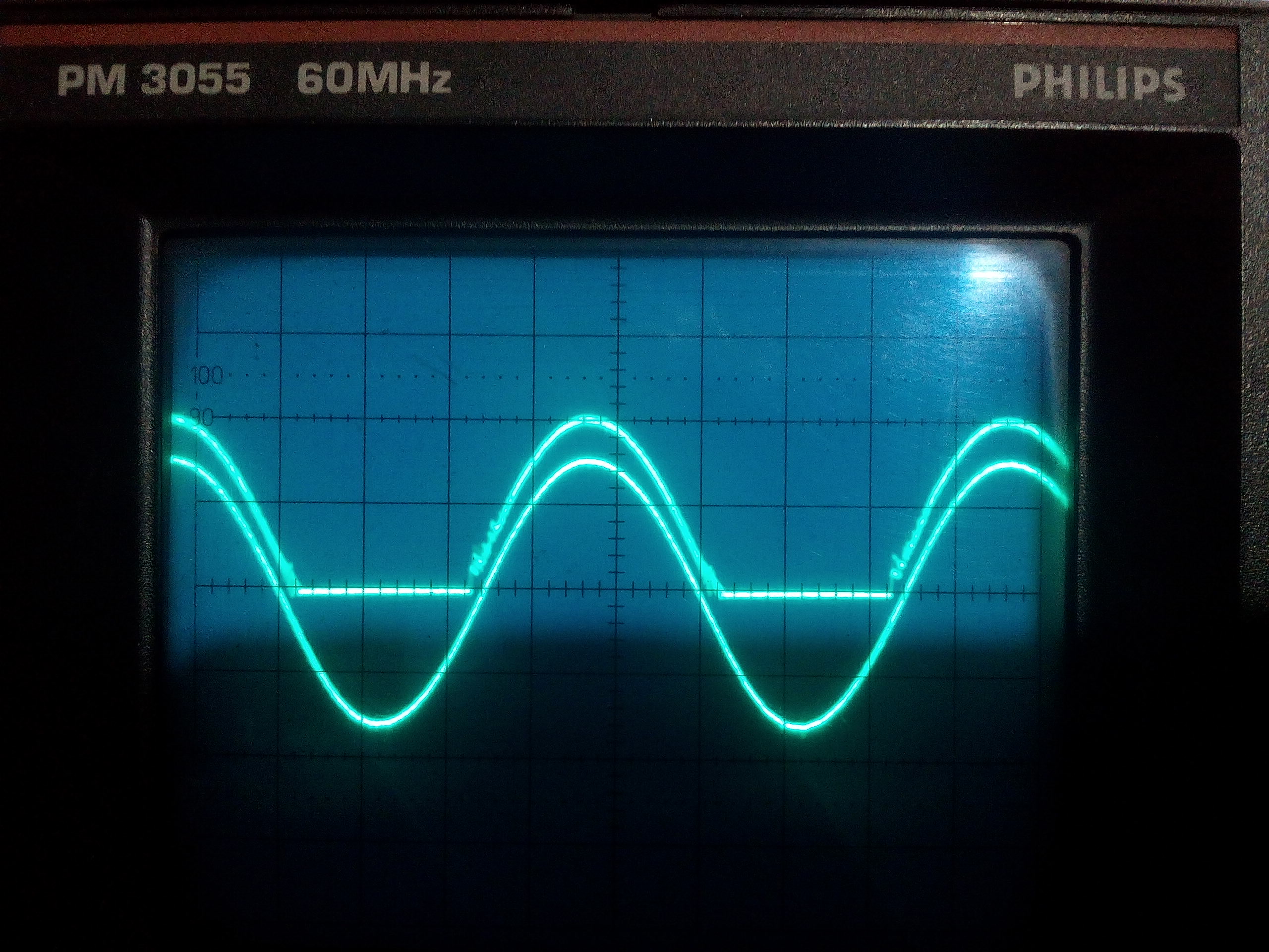

First TD1800,second Labgruppen.
Any idea why TD1800 look worse ?
Long time already and I cant see positive feedback working DIY TD1800 without issues
The amplification must be smaller and I think it is a mistake when designing the wiring.
Anyway, I'm just an amateur and I don't know much.
I repaired a yamaha p7000s, and the output signal looks perfect with no artifacts.
I'll try to take some pictures with the P7000s output.
Because the VAS stage is connected to the modulated voltage. It must be connected to directly to the HV.

ok, but I dont understand,...why APEX not fix with a update ?
Exerybody will get frustration when build ant final test will be a nightmare
Same for me. It would be a very small change, and big improvement.

For me, I need to know, does TD driver circuit work reliablle ?
I want TD driver add to reliable proven class AB PA amp design
I want only use TD driver circuit, APEX TD1800 circuit amp I dont use

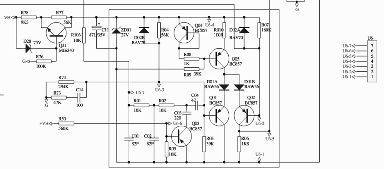

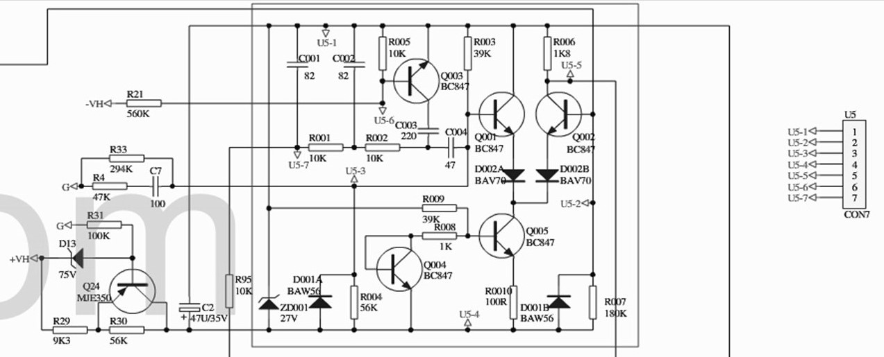

I tried and as you said, but no results.
I this scheme the amplification part is about the same as the TD1800, but it still works.
I remember about 10 years ago I repaired something like this (Mackie).
For NMOS,
I think the Labgruppen auto-oscillator is the best.It's more complicated, but it's much more efficient and it works for sure.
The rest of the scheme exists on the net (right here on the forum).A little mistake PWMNATD=PNP,PWMNPATD=NPN transistor.You can also try the downconverter from yamaha, it's much simpler.

OK. For me it is not logical to use the VAS from the noisy modulated psu, instead of clear 140V DC. I see how Mackie did, but I would still give it a try with TD1800...
