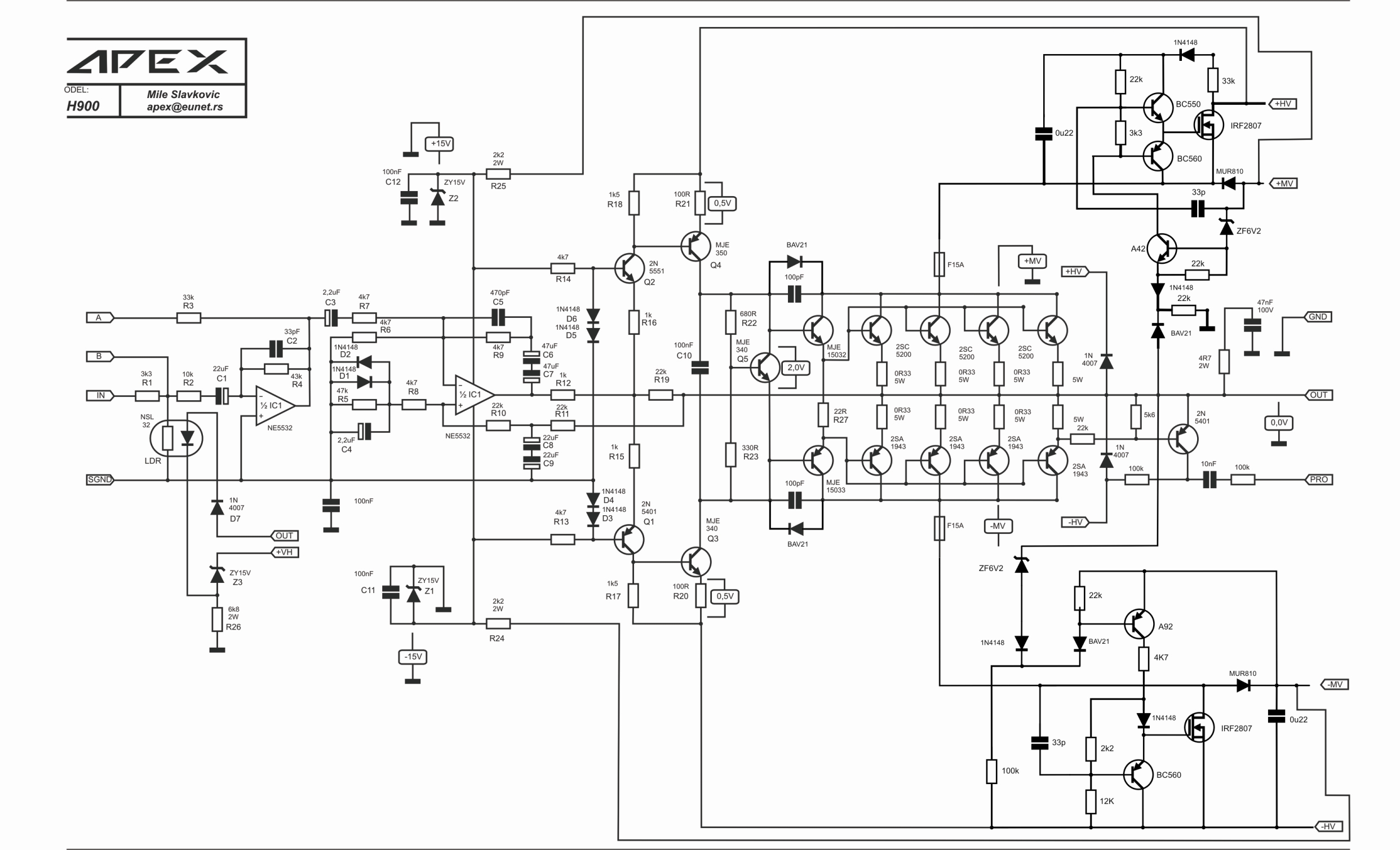

Load 2.667 ohms. 3 8ohm speakers in parallel. Is there a way of making the stepper to switch to the higher rail even when the preamp is at low volumes? Mine only switches when at maximum volme, i.e almost where the signal starts to clip. It's like first it exhausts or rather exploits the lower rail completely up to
audible clipping then it starts climbing to the high rail. This is usually the time i hear and feel the way a car engages the other gear for the speed climb. The speaker starts to get some extra power. Can this phenomena be harnessed before the amp reaches higher volume dial? My preamp is at its max gain. I mean i only require 279 mV of input to drive amp to its full power. Are there components i can change to make it more sensitive sir Apex?

amp cann't clip without high rail if you use apex clip circuit and hv rail switch near 30v so no chance of clip before rail switching to hv. something wrong.

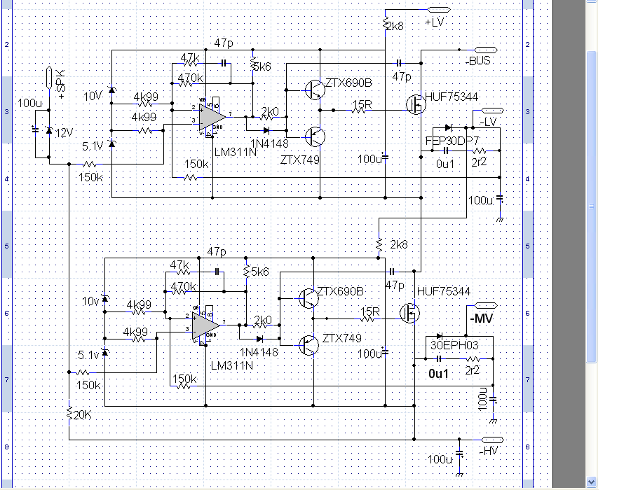

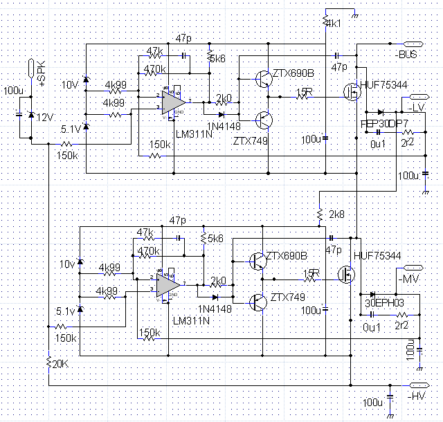

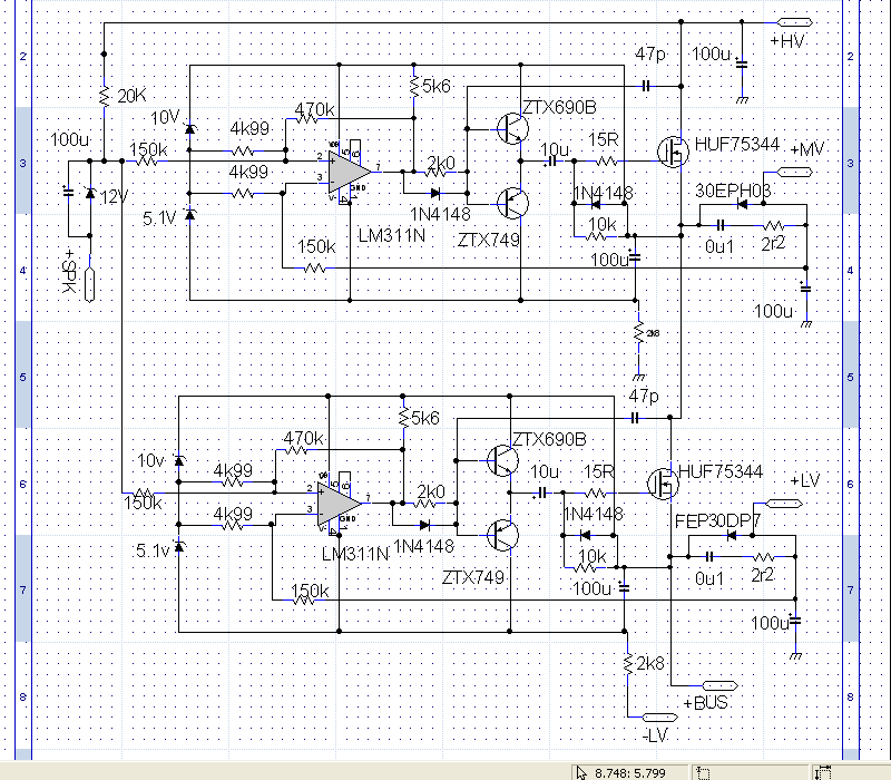

The 47 pF caps on each rail switch keep the slew rate under control. It increases the switching time - but not enough to make it ineffective at audio frequency. Switching losses will be noticeable at 20k, but are you going to put that much into your compression drivers? It helps reduce the commutation noise, as do the .1uF/2.2 ohm snubbers. The other thing that slew limiting does is reduce di/dt - to the point where TO-247 package and typical PCB inductances are practical. Too much inductance combined with too fast switching and you get spikes across the PCB traces that last only a few hundred nanoseconds but are deadly. These commutators are the variation of the QSC switch that I use on some of mine. Uses the 311 - so they're an option in places where the IR drivers are difficult to find. The basic amp schematic that I use is similar to Apex's (with the opamp in the input stage and EF outputs).
Corrected from post 246. Anyone doing class H should be able to figure it out, but...

hi rohin discreet or lm311 as gate driver which is better with this class h design
900W H-class PA Amp with Limiter - Page 154 - diyAudio lowside.png53.5 KB · Views: 1,343
900W H-class PA Amp with Limiter - Page 154 - diyAudio highside.png47.8 KB · Views: 1,351
900W H-class PA Amp with Limiter - Page 25 - diyAudio lowside_correct lm311 driver.PNG36.1 KB · Views: 1,490
900W H-class PA Amp with Limiter - Page 25 - diyAudio lowside.PNG53.5 KB · Views: 1,364
900W H-class PA Amp with Limiter - Page 25 - diyAudio highside.PNG47.8 KB · Views: 1,397

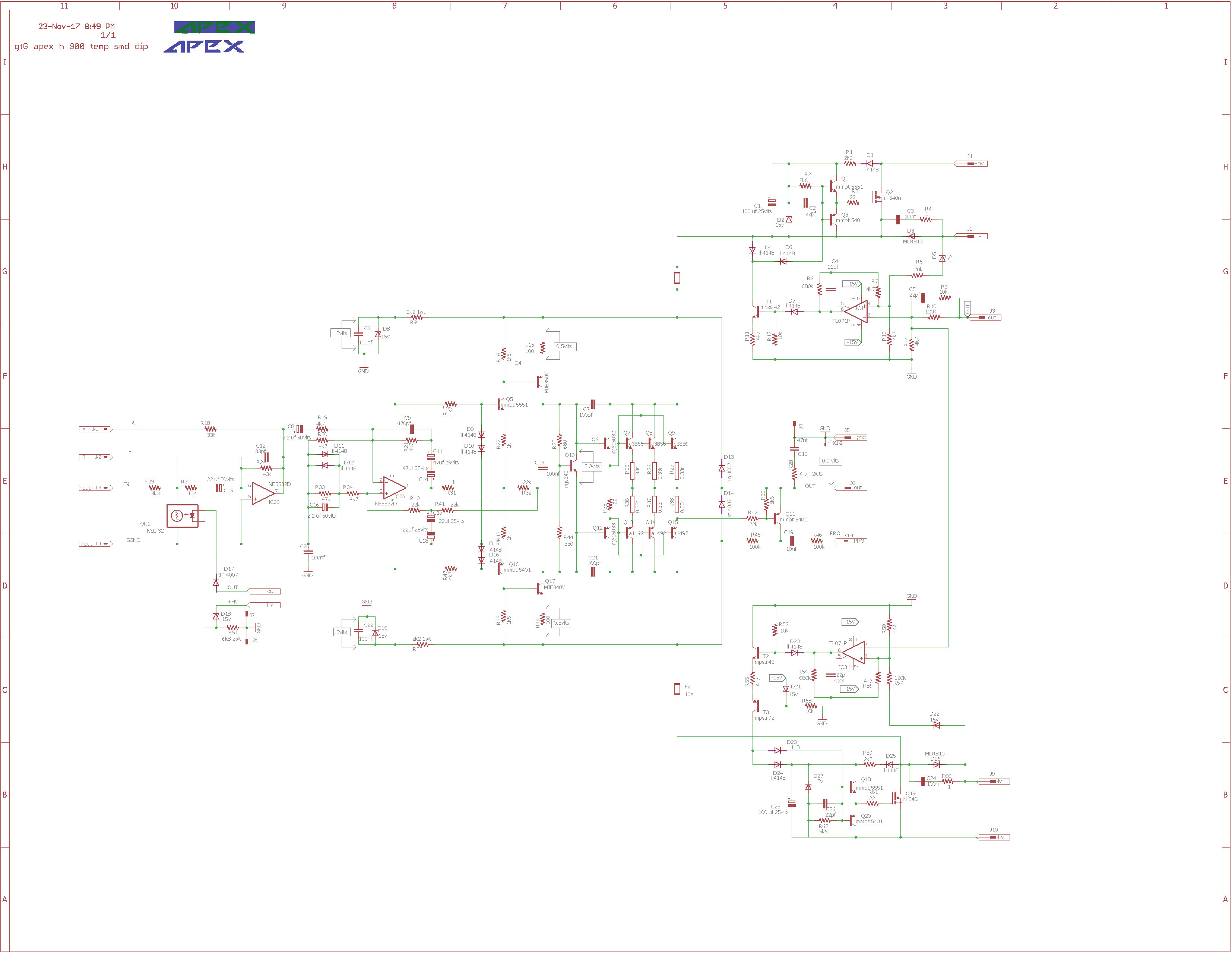

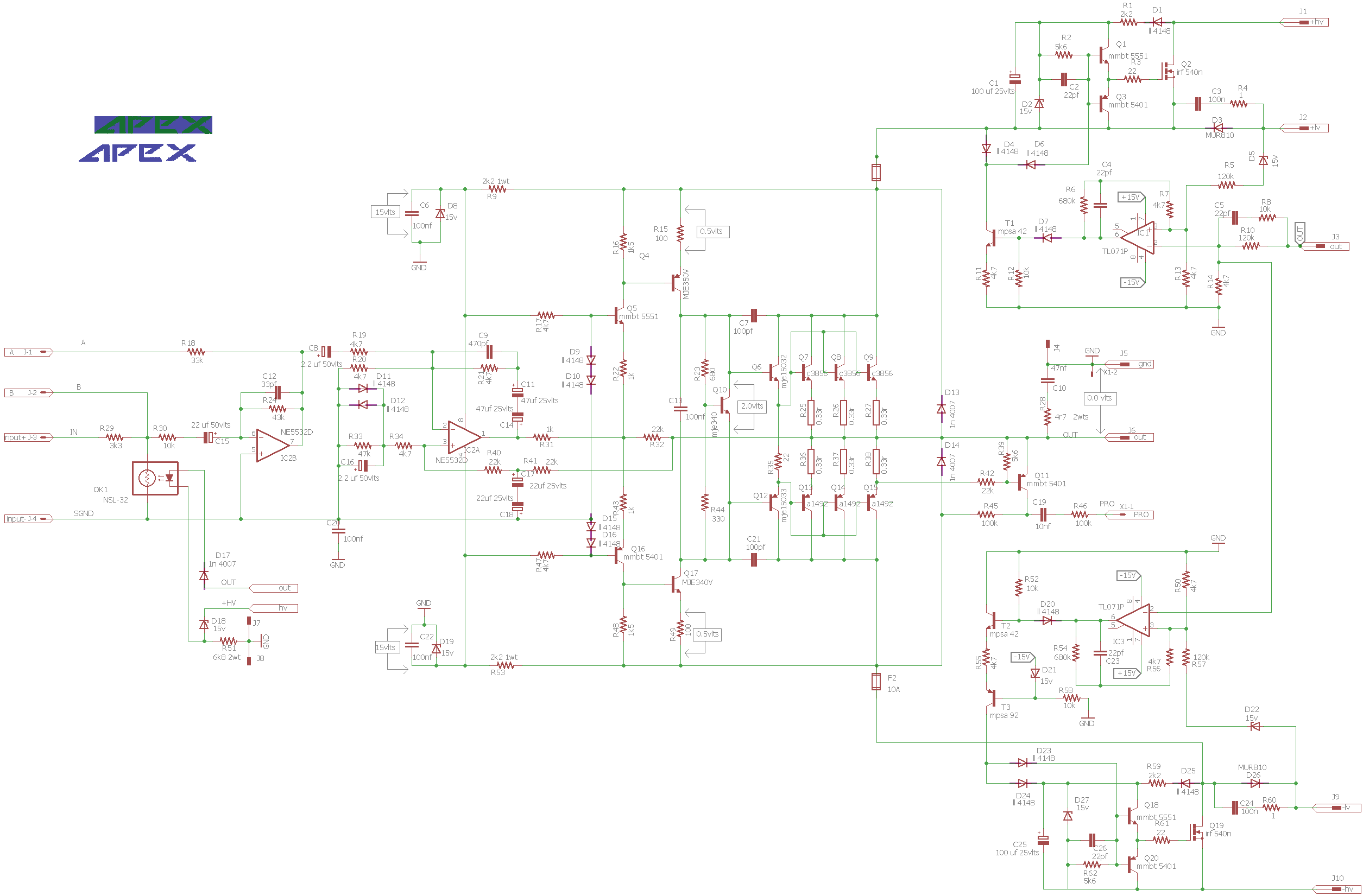

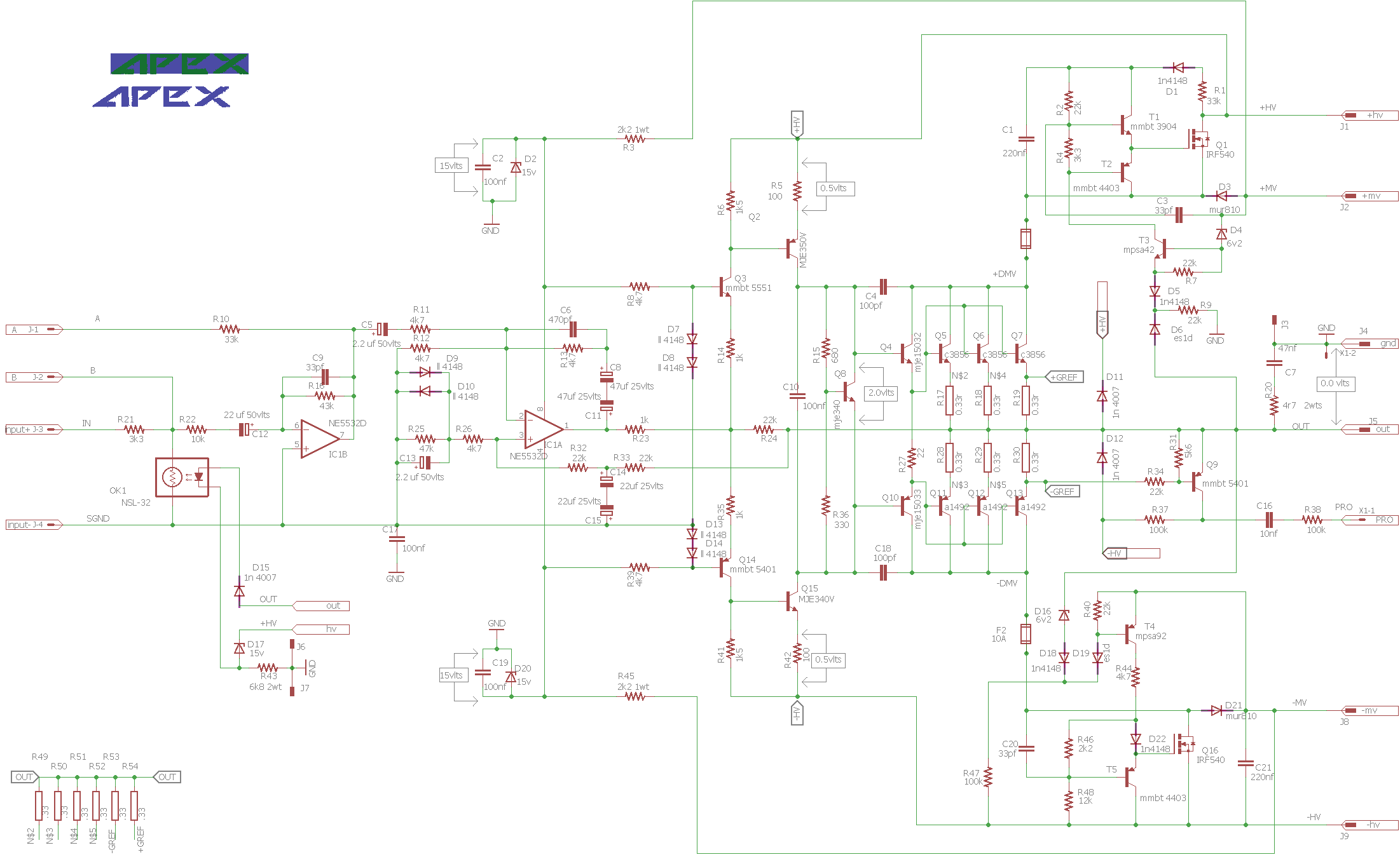

hi all i have settled on discreet mosfet driver using mmbt 3904&4403 as gdt, and three pairs output bjt.
on the two tier version. the three tier one i will use lm 311 . my choices are based on availabillity of materials.
it shall be a two tier class h, the voltage maxx shall be +/-45 , 90 vlt dc
the fets i will use either irf ,z44,z46,z48, 1010, 1407 e.t.c
please all check if there is any errors on schematic or what can be improved to the schematic. thanking you all in advance diy stewin

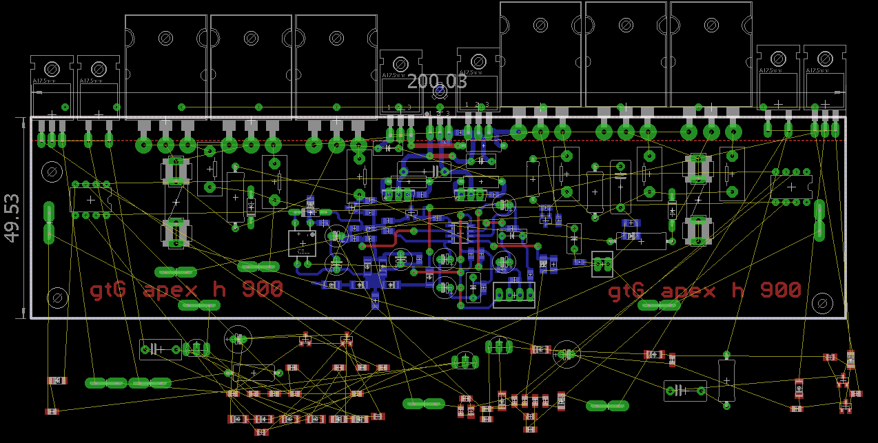

Hi sir,rohin
this apex discrete stepper is not working properly,negative side suddenly increased rail
please post clear photos of your project.
