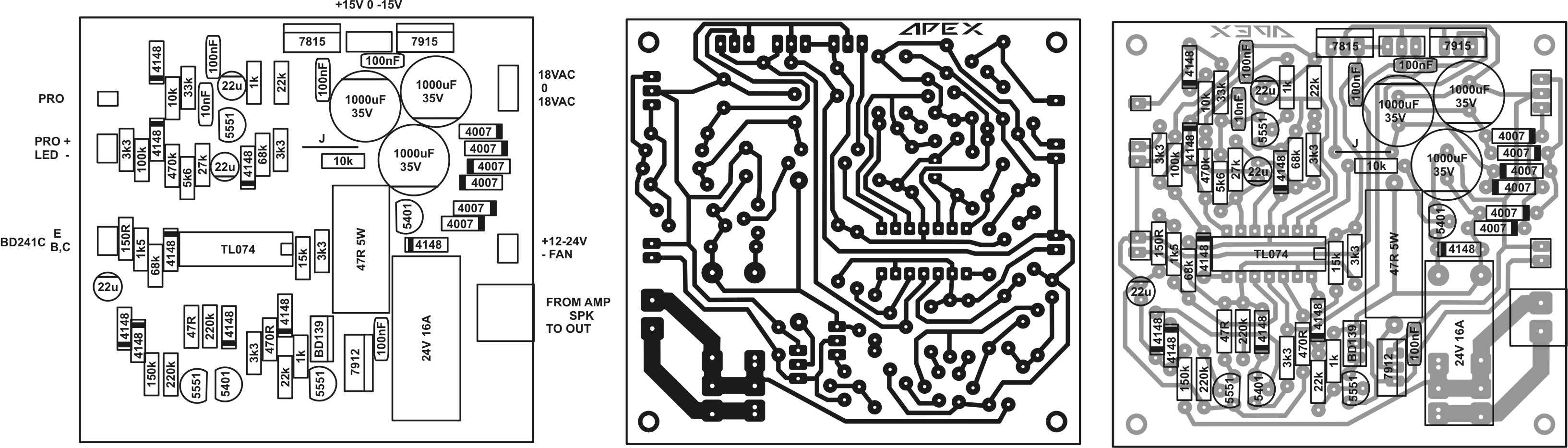

mr mile i've made your ultimate protection (PA protect)so far it's good i tested dc detect at 1.5 volt relay disengage and re-engage quickly however the protect led is not as good i expected but not an issue, what i want is can we adjust the high speed fan 45-50 degrees instead of 60 degrees? and the rest is ok. thanks mile.

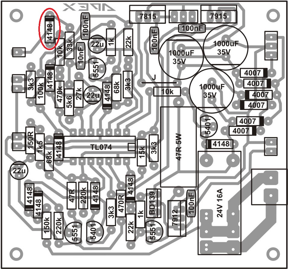

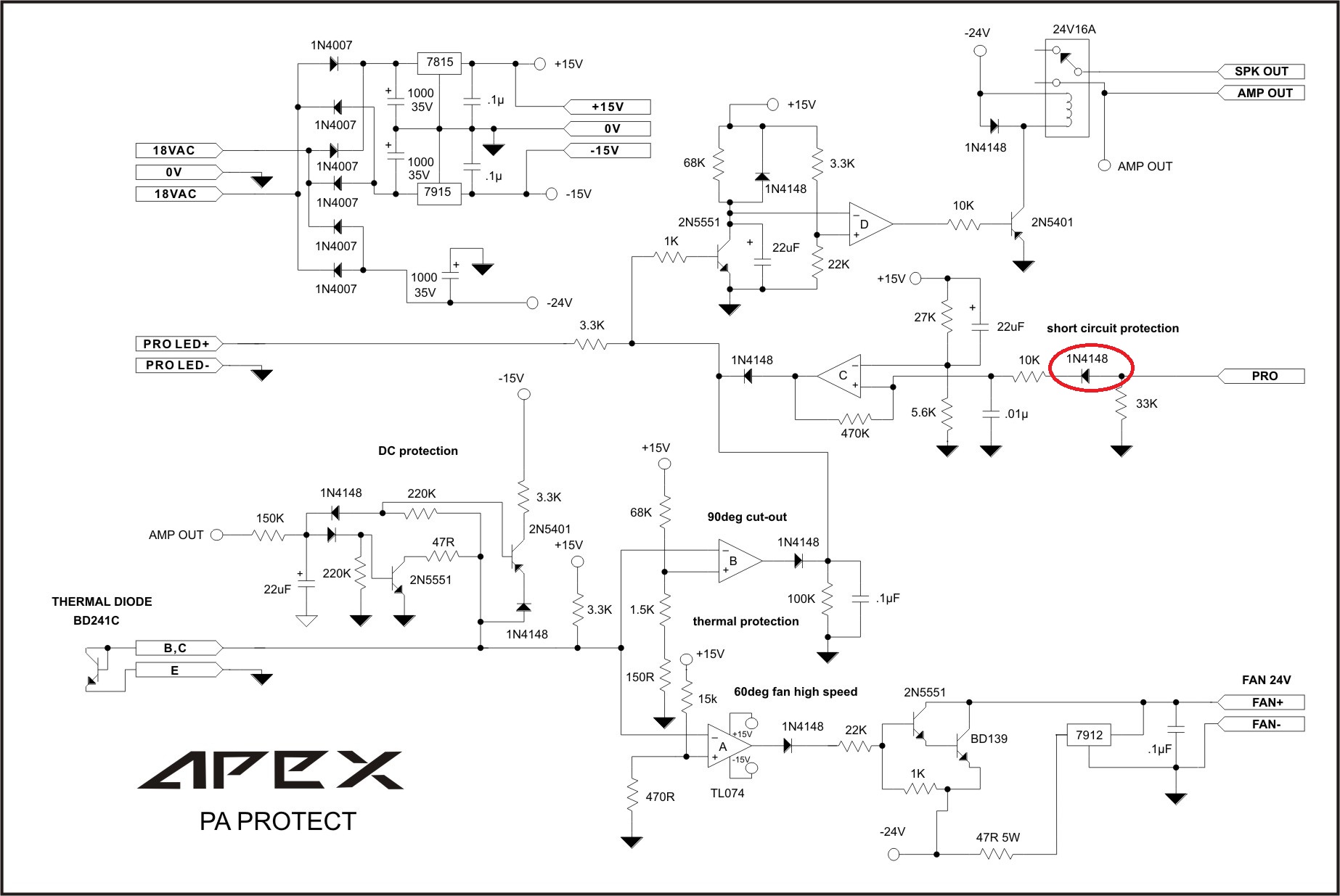

sir mile, i have a question about your design of pa protect for B500/H900. i've seen there's a difference between the schematics and the layout pcb that you've made. the difference is the diodes polarity (4148), i had marked with red ellips on both pics. my question is, which one is the correct polarity (4148)? the schematics or the layout?
PA Protect component layout.

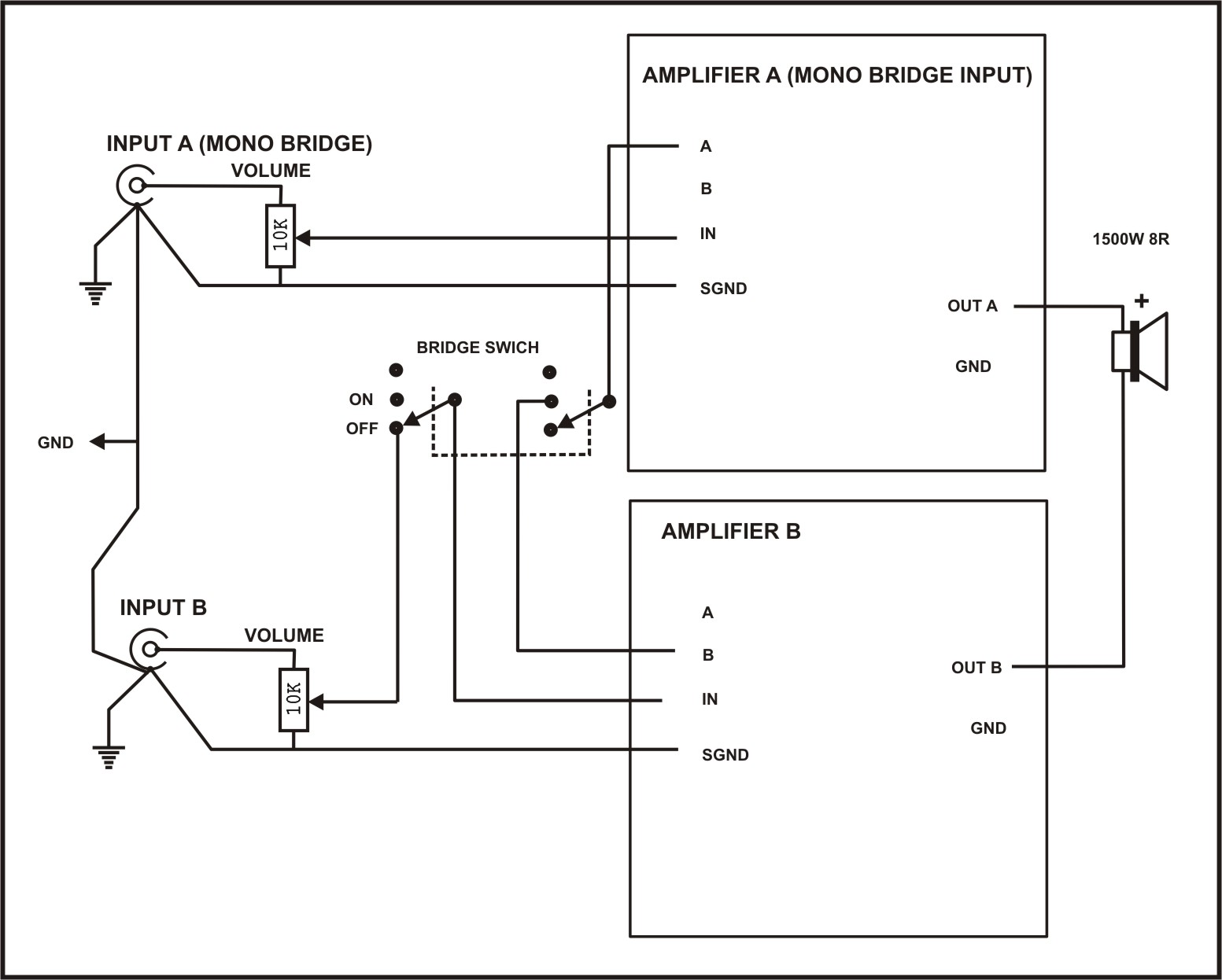

I have a question about bridge mode , i've found a schematic on the internet about bridging this amplifier , my question is when according to this schematic the channels are bridged the signal input comes only from one channel not from both at the same time , but since bridge is meant usually to drive a high power speaker in mono mode shouldnt there be another switch that switches together both inputs A and B?
no my idea was different yes I have signal coming into one channel while the other receives the inverted signal from the first channels OP.
the question was about whether I can simply connect the both incomming channels before i feed them further down into the channel A mono bridge mode.
see illustration in the attached schematic.
thanks.
thanks.
