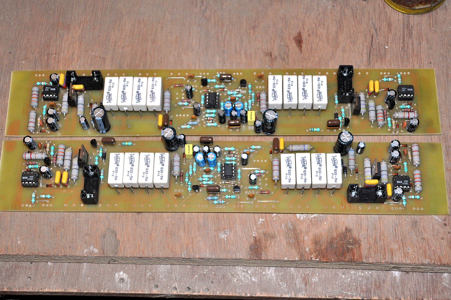

Guys!! I fixed problem as you told me to do!!! Thanks for all your help! I check PCB over and over again. I saw one of my track, does not connected to my 1934 transistor, I solder track and start up amp with 220v ac bulb in series, there my one channel play 100% rite, with out any problems. But I have to thank all of you who help me. @ Gantex, yes you rite I'm new here at DIY. Guys I must tell you, with tears in my eyes, my biggest wish and dreams, was to be like your guys. But according my Parents, broke up, I'm the eldest one who have to leave school, to take care of my Mum and younger brothers and sister. That's the main reason why I can't go further to study for what you guys are now. But I appreciate much of every one of you who help me solve my problems with Electronics. Sometime I feel not to disturb you guys, but I'm excited to see what I do with my hands, must work. But still thanks you guys.

Hi can some one explain me more, what is the function of the ldr and what does it mean. Because I saw that on H900 and B500.
in NSL-32, there is LDR & LED inside the component.
LDR is light dependent resistor;
LED is used to produce light for LDR
LDR reacts to light:
more light, less resistance
less light, more resistance
in B500 or H900, when output signal is high, LED will glow more, LDR will decrease resistance, and because LDR forms a voltage divider it will decrease input signal.
imagine that this NSL-32 is similar to an auto-brake in car, when car runs faster, the brake will activate, and will slow down the car.
