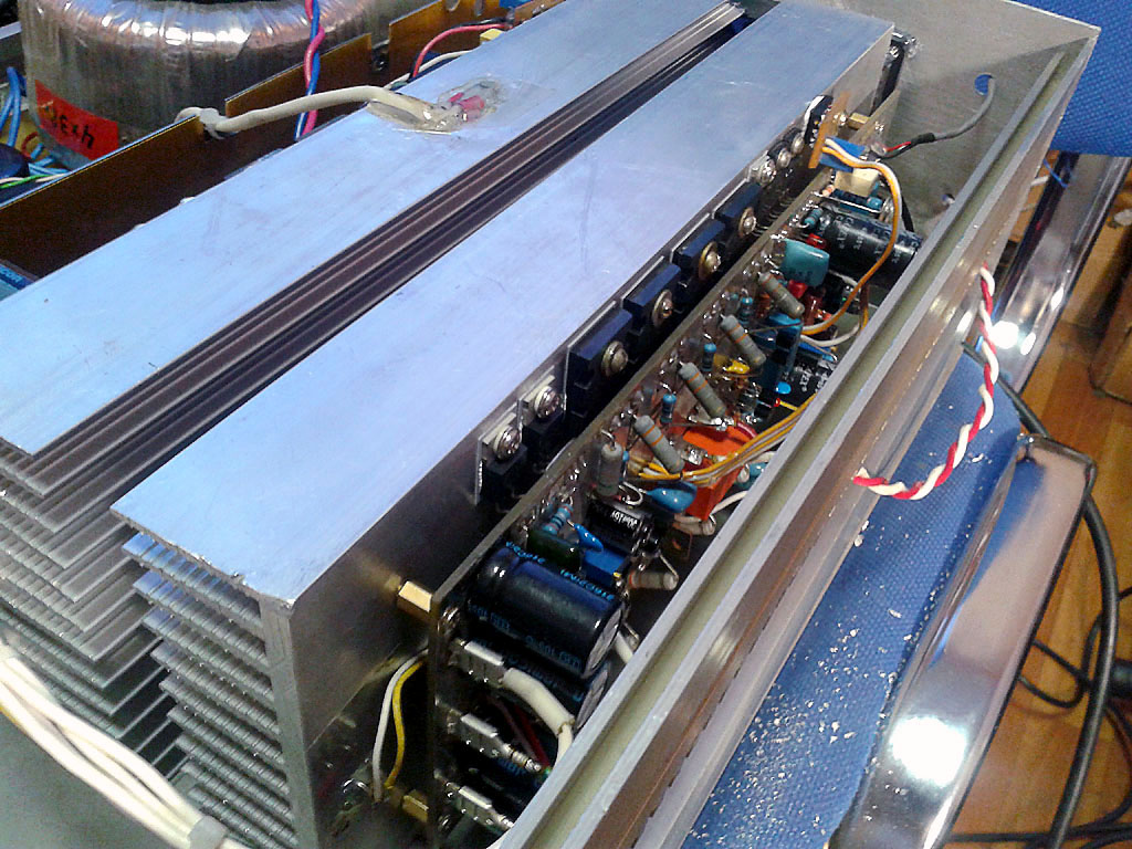

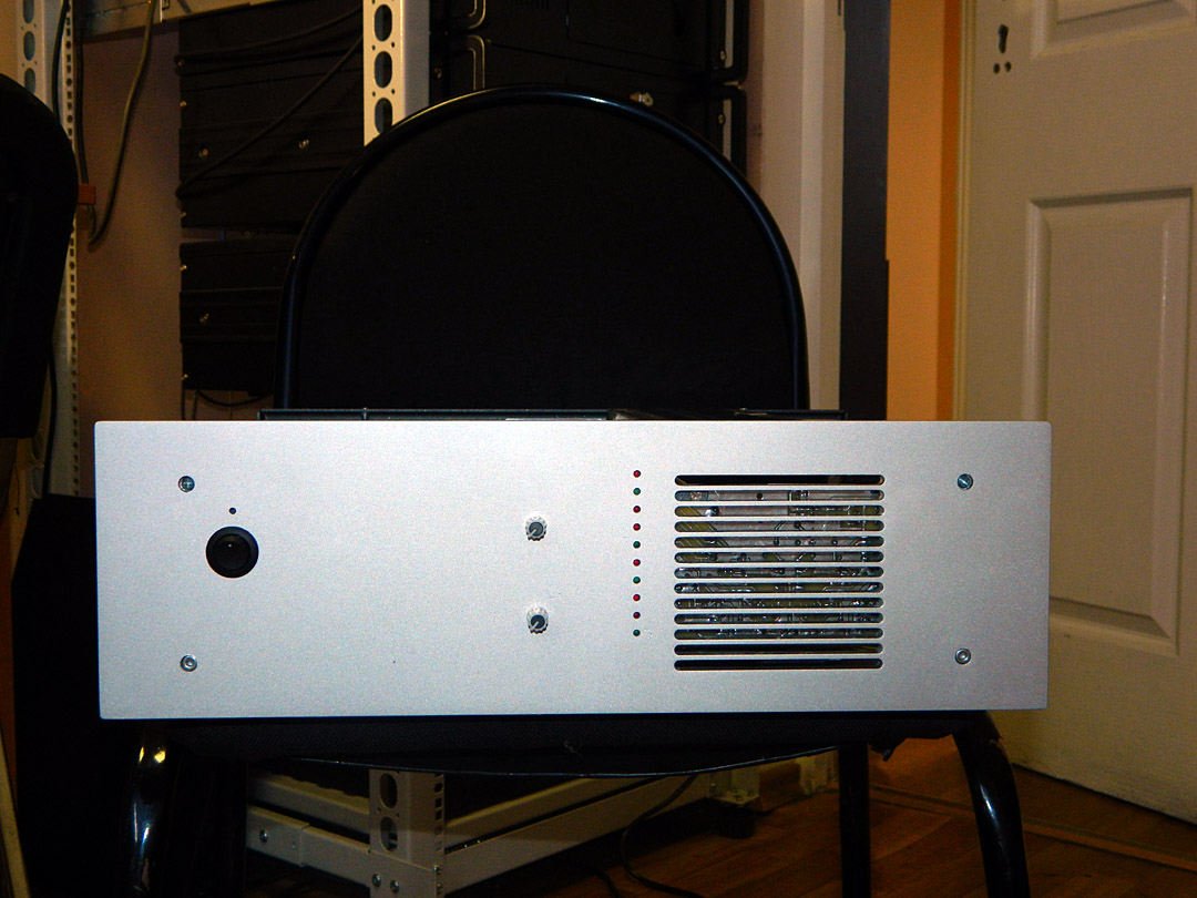

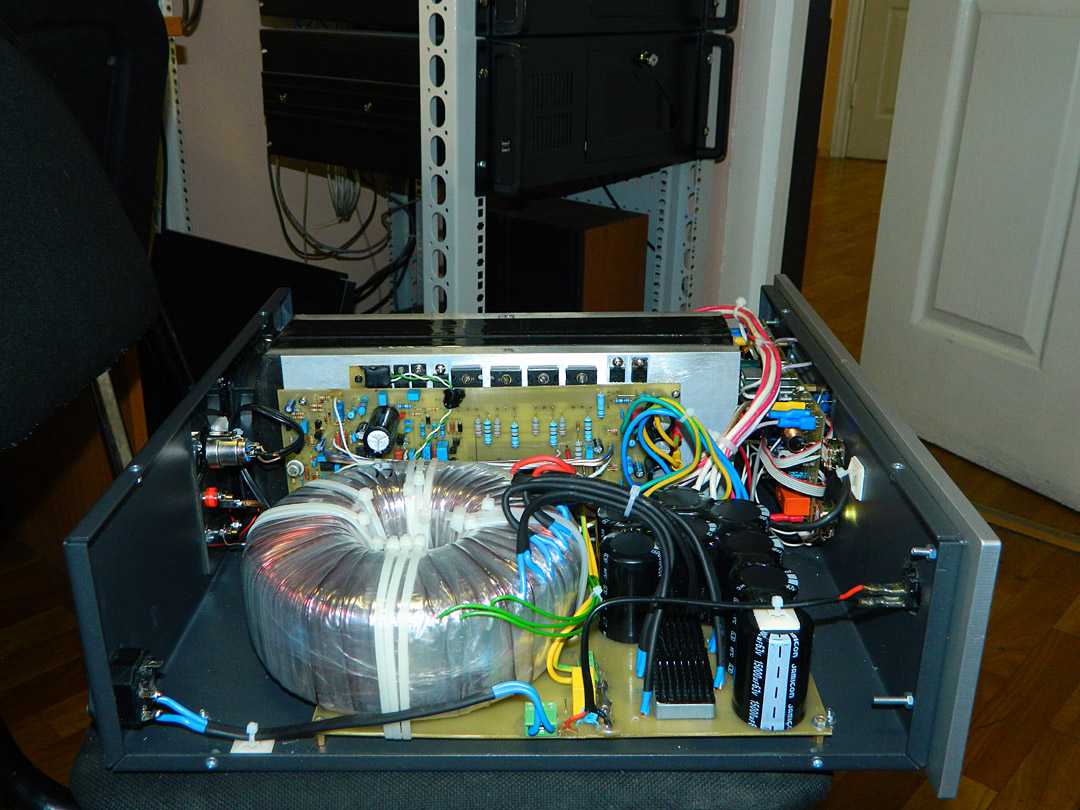

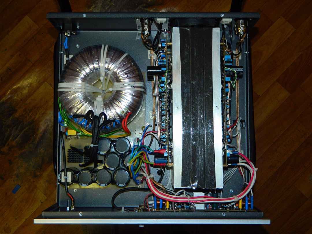

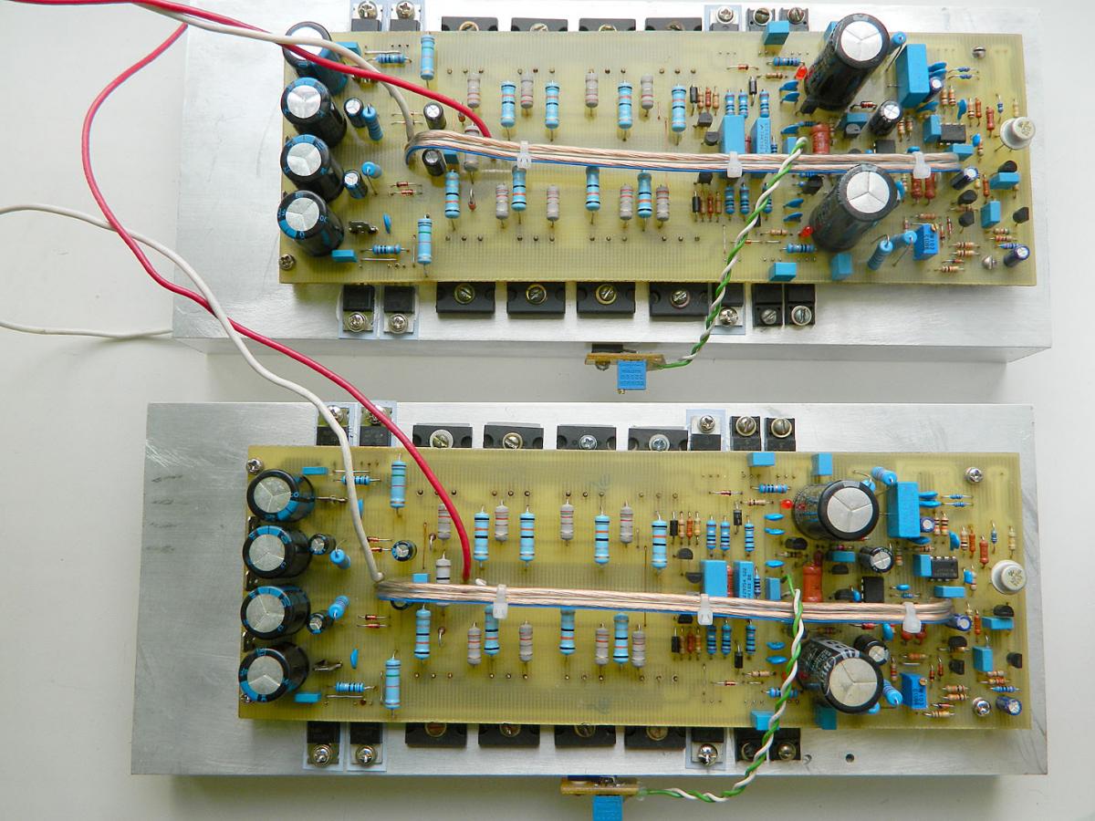

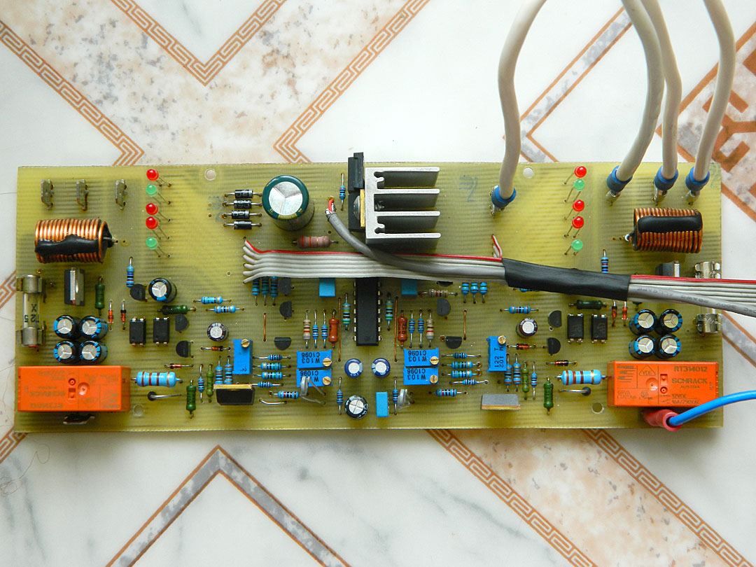

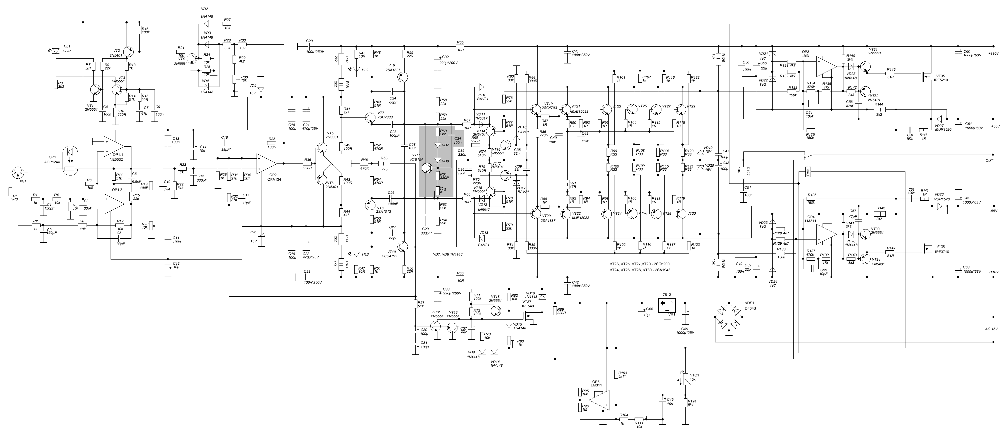

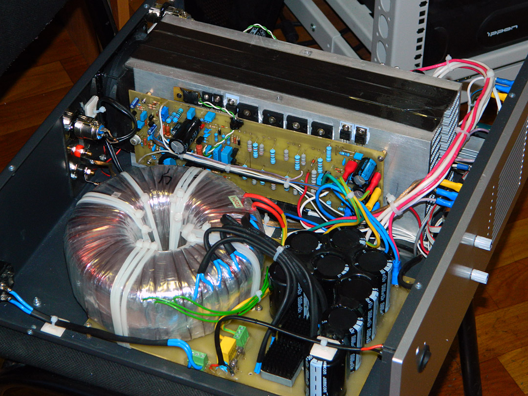

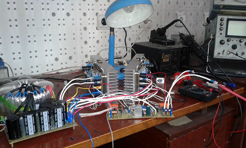

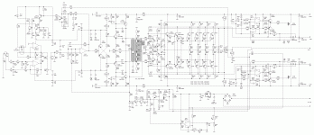

Hi all!
This is not my first amp, but it's a first two-rail amp in my series called "Nataly".
Specs:
Nominal power - more that 900W, 4Ohms
THD on all frequency response - less 0,03%
THD on 1kHz - less 0,005%
This amplifier was made and discussed on Russian forum: V.2013 Äâóõýòàæíûé PRO-óñèëèòåëü â êëàññå Í
Project homepage (in Russian language) - ????????? ???????? Nataly - ????? ?? ????????????????
With respect from Russia
Vadim Mogilniy.
My nick on Russian Sound forums - Waso.
Hi all!
Specs:
Vadim Mogilniy.

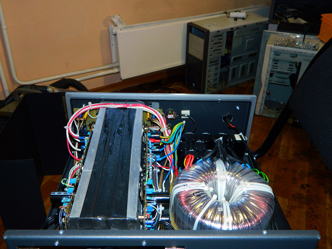

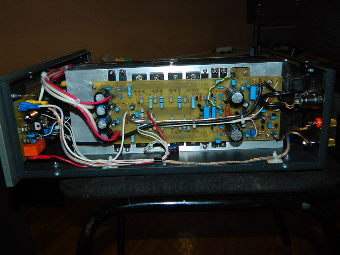

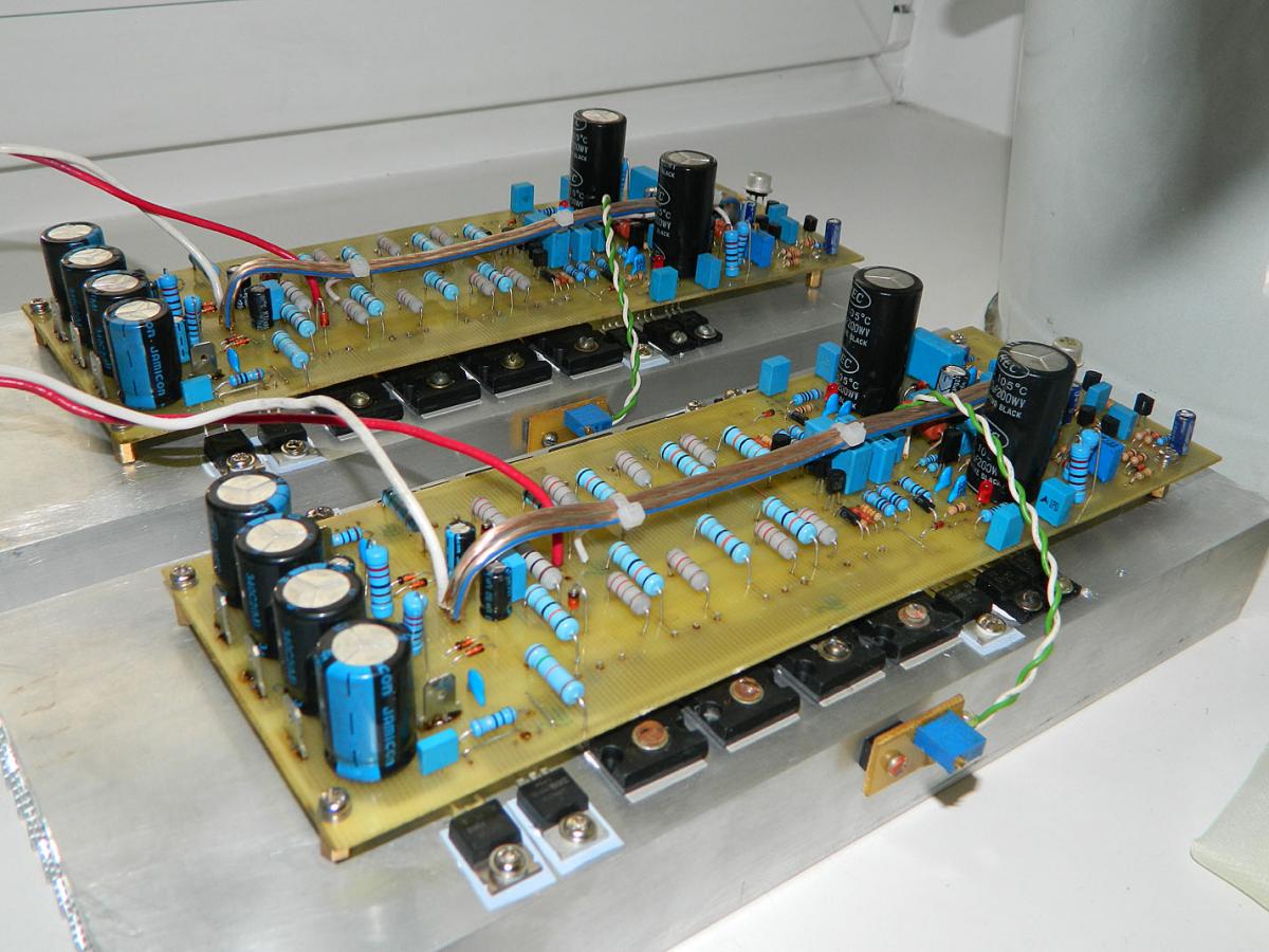

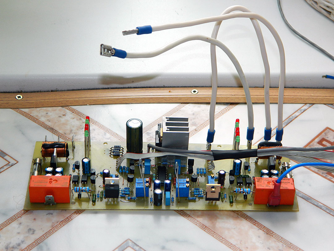

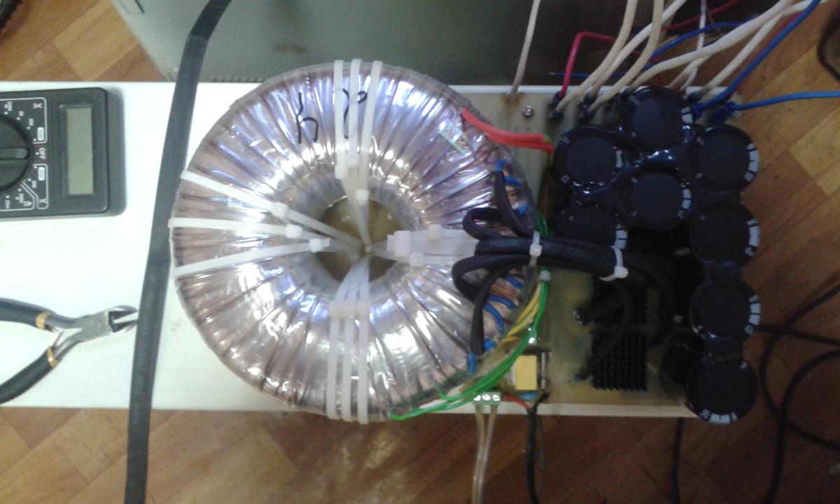

More photos...

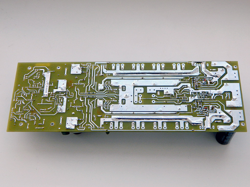

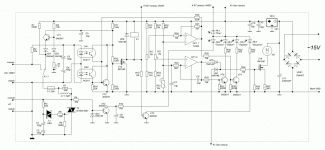

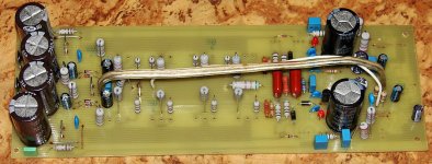

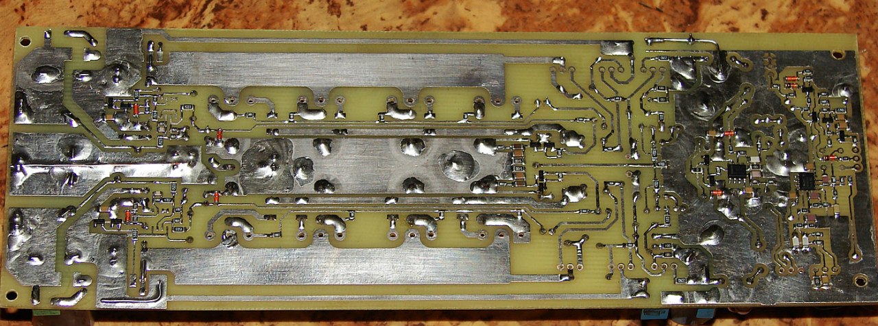

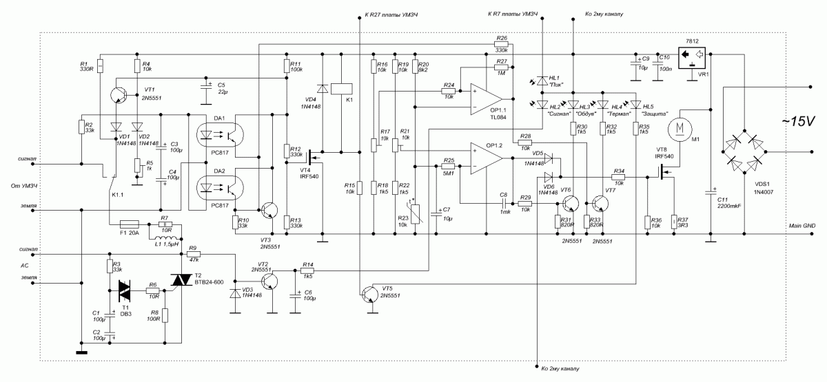

Russian opto-pair AOP124 may be changed with VTL5C2, VTL5C3 with difference of pins. Russian transistor KT815 may be changed with BD139, 2SA1837, ets...

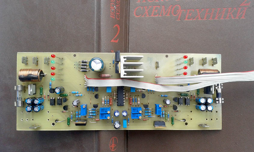

Andrew hi!
You interested about full limiter as soon as or limiter as amplifier part?
I have some ideas about it, with LM13700, prototype PCB is in my hands But now I finish a third dual-level amplifier in H-class. It is more important.
PS. Is there any progress with the your construction of the my Yamaha-D7000 clone amplifier?
PPS. G-class amplifier was tested too, it has a nicely sound as H-class, because class G is free from power switching interferences. Both devices leave no chances of many similar devices on the sound. If you choose OpAmp OPA2132\2134 instead NE5532, sound will be even better. Same thing for replacement OPA134UA to the OPA827, OPA1641, OPA132.
If you need a stable RMS level, you need a limiter based on true-RMS detector, for example, http://www.thatcorp.com/datashts/2252data.pdf Main part in compressor is a level detector, my scheme is a peak-level compressor.
