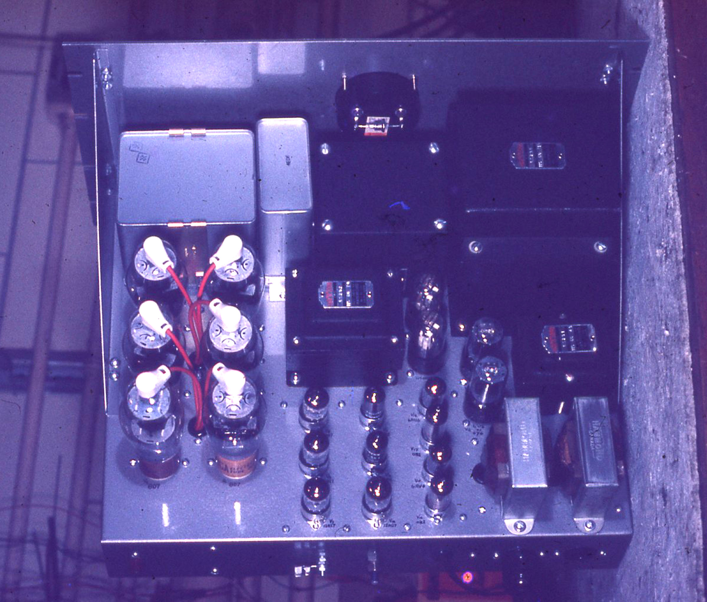

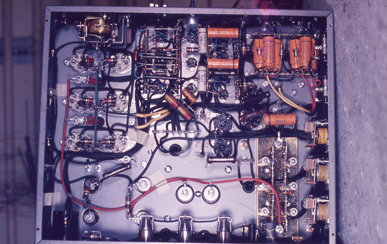

I designed & built power supplies for magnetrons, klystrons, photo tubes & on & on. All that left behind when I joined HP sales in 1965. Only a couple of photos, this one for a magnetron, it is constant current & manages 1.6 KV at 0.25A. Many general purpose PS for the lab as well. And a 4.5KV, One amp brute, regulated. The rectifiers where a full bridge of 7136 Hgs, a tad larger than 866s. It powered a continuous wave cooking magnetron that powered a gas discharge in a glass vessel. Part of an experiment, I worked in the Physics graduate lab at U of T on the way to the P,Eng.
