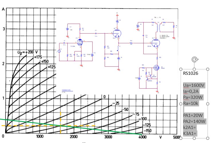

Ohh man, This is a very old post from 2006 :-D I have planned to use the 845 with 75% max power dissipation and 1kV anode voltage. An Interstage was required but very expensive, the same applies to the output transformer. 10k and 200mA DC.
I never started the requested 833A project, but I have made experiences with the RS1026. It is a Power Triode like the 833a. I find the RS is more usable than the 833a. A1 operation for small output power is possible and I got it for free^^
I use this Operating Point I think (it was 2009):
Ua=1600V
Ia=0,2A
Pa=320W
Ra=10k
PA1=20W
PA2=140W
k2A1= very very high
K3A1= low
This high power dissipation is required because this tube has no getter but zirconium parts I think. To drive I use a 211 as Cathode Follower (60W, 60mA), the RS need 50mA Grid Current for max Gain (An interstage transformer with stepdown ratio would do it better but I have no one). As a preamp, I used a D3a as a triode, later as pentod for more k3 to get an more balanced sound.
With this configuration it gives 12W in Class A1 and round about 60W in Class A2. The measuring results after the 211 were OK but after the RS very bad It could be a problem with the high DC current in conjunction with a to small air gap in the output transformer).
When listening to music then a completely different picture than when measuring (only in mono).
I hear it with LP and a DIY RIAA am with two 5654 pentods per channel. The Speaker was an B&W 803.
Motörhead - Out of the sun: Lemmys Voice Range A revelation
Dire Straits - Brothers in arms: wow
Unfortunately, with an power consumption from 1000w for a couple I did not continue at this Point.
I have learned here that poor measurement results have nothing or little to do with the sound that I like.
