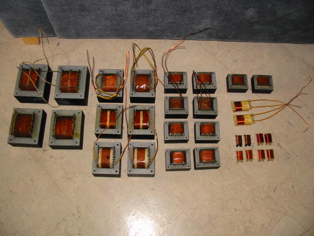

Hi Sickss,
last year i finished my 833-amp. Not PP but SE. With a nice twist: ultra-parafeed.....in order to get rid of the massive amount of saturating DC in the OPT.
It is a full-range amp, and not just for the bass-region. Although the bass-output is immense. Talk about real authority here !
Jusy like you i was looking for a good transformer-supplier; if possible in the Netherlands so i good really SEE what the quality was. I had good experience with Heart (established Dutch firm.....doing this business now for 3 generations....very low profile).
They did almost all my transformers/coils for the project. And that's more than 30 pieces.
The output is an EI150-affair weighing in at 12 kg. Not because i needed that huge core (ultra-parafeed....no DC), but because i wanted a very well designed coupling between the 7 primaries/6 secondaries. With my 1400 V/200 mA that means large diameter copper.....large transformer.
Just for fun i inquired what a huge 833 PP-transformer will do:
- custom designed PP833;
- EI-180 transformer;
- stacked height=100mm;
- Armco 0.35 iron;
- combined 7-layer model (just like mine);
- isolation class 4 (kapton foil + Kraft-paper + vacuum impregnated;
- secondaries as 30 cm leads, etc, etc.
====== € 369 a piece ex VAT/shipping/etc.
Certainly not cheap.....but i can assure you that this is real quality.
I'll enclose some pictures.
About the rest of my design: A2-class (positive grid driven), 1400 V on plate, 5 K OPT, 100 Watt output, no feedback whatsoever.
The high voltage is not the most essential part.....take care of the 20 Ampere inrush for the filaments ! Seconds later it will stabilise to just 10 Ampere.......
And it does sound great !

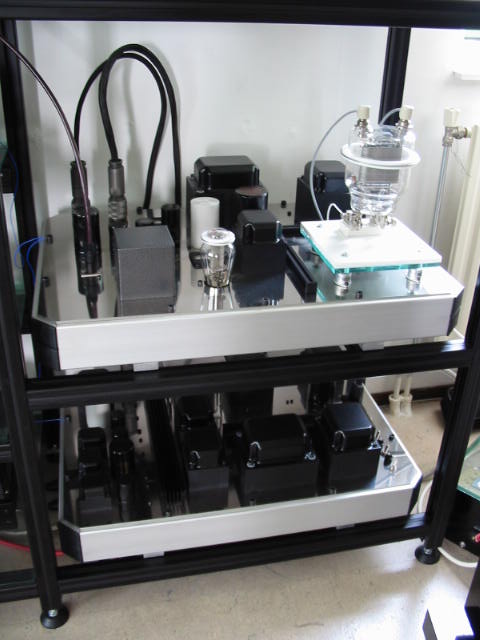

Hi Sickss,
As promised a picture of my 833 amp. Not for only bass-output.
Your design: PP 833......what is the speaker you're going to drive. Or are you planning to power up a stadium ?!
Picture only one channel: upper part audioamp. Lower part the external power supply.
Reinout

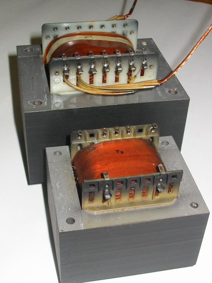

Sorry Sickss,
just as Jeff Mai noted....it is in euro's. € 369 is (exchange rate 1.3 - ish) around $ 480 US. Certainly not cheap.....but i do hope you never thought that a 833-based amp was going to be cheap in the first place.
I can stand for the quality. To be honest i delivered special kapton-foil to the company to be used in this design. Normally the isolate primaries/secondaries with the good/classical Kraft paper. with their vacuum impregnation and 12 hours hardening (!) in an oven you get a real solid transformer. But the Kraft-paper is only good for 1 kV. In order to go to higher voltages.....they standard multiply the paper to come to the required isolation class. But that will take up much winding room....so less space for copper winding....so thinner wire (ratio's will be fixed)....so resistance.....AAAARRRRGGHHHH.
I bought a roll of Kapton-foil. Extremely thin....but good for 7.5 kV ! And ordered my transformers with a mixed combination of Kraft-paper + Kapton-foil. The foil for the isolation; the paper for soaking up the laquer which after the over treatment will be as hard as a rock.
When you want those trannies.....i'll "donate" the Kapton-foil for this project. It is bloody expensive but i like to see more 833-amps around.
Th picture shows the EI96-size interstage (interstage 300B to 833A) and the EI126 output transformer.
"Your" EI180 is twice the size......please do count in postage.....
Simple question from my side: i believe a EI150 will do nicely. large enough diameter copper; no DC (PP-design)......
Leadtime can be fast enough.....the company is not really promoting these products (there is much more money to be earned as importers/distributors of audio-gear) so if you want to proceed......i offer to be your middle-man. It works always better if there is some "pressure". No money involved !!!!!
If you want i'll find out the difference for my pricing (will be 369 without VAT) and your USA-pricing (can be without VAT ????).
Reinout
