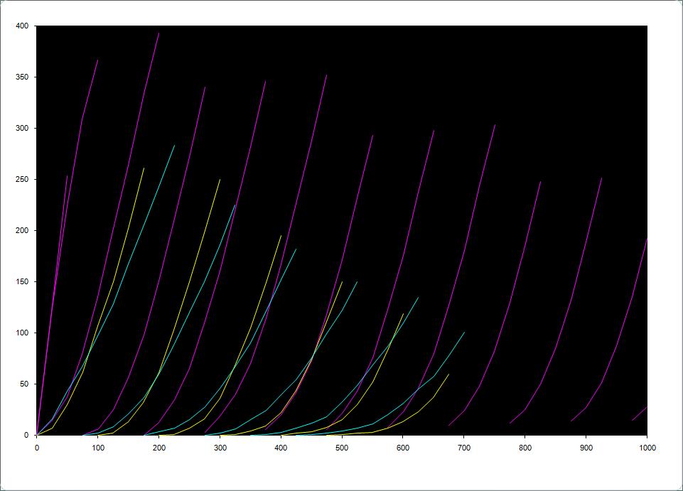

Why not run the screens as intended and use some plate to grid feedback? Turn those pentode curves into triode-like curves without loosing efficiency.
Curves in the image are:
Blue - KT88 triode connected, mu = 8
Yellow - 300B, mu = 3.8
Pink - KT88 run as pentode with 20% plate-to-grid feedback, mu = 5
Note: KT88 pentode curves don't contain any positive control grid voltages. Pentode efficiency is maintained.

That pink trace looks very interesting and useful. I have always tinkered with triodes so I do not know how to hook up a "pentode with 20% plate-to-grid feedback". Is it just normal pentode connection + standard feedback resistors (using a resistor in line to the grid then a second from grid to plate, along with a dc blocking capacitor)? If not is there a tutorial or diagram you could point me at a so I can learn? Thanks.
The only problem with plate-plate feedback is that Zin will be in the ballpark of a few kohms, Zin=Rfb/(Gm*Rload+1).
It can be a little problematic but but you can try finding the right hiGm pentode driver at high current, do not use triodes.
You find it all in RDH4 pages 332-333, fig 7.31. You can easely adopt it to PP.
10-20% FB is a good idea to get triode characteristics as Spreadspectrum indicates. Pete Milletts latest PP is an example. Read his text where he also mentions the important distortion-cancellation taking place in this type of amp.

It is great to get some real-world reports on this. I am going to have to try playing around with some of these topologies. The RDH4 didn't seem too positive about plate to grid feedback (as opposed to plate to plate) but it wasn't clear to me why. I guess I may need to find a lower output impedance driver, though.
Hey Torrence,
Now I got curious, I might have missed something important.
Plate-plate or plate-grid is the same in my world if we by grid mean G1. If it means G2 we are talking triode-strapping. Havent found any negative words there except that they for obvious reasons didnt recommend using triodes as drivers.
RDH4 shows fig. 7.30, where there is direct feedback from plate-to-grid, then discusses the 'improved' circuit in 7.32, which looks to me like plate-to-plate feedback, although I guess it depends on your point of view since the plate is also AC coupled to the output pentode grid.

Aha, you ment that one. They are, as you say, AC-wise the same depending of component values. But in the text to 7.30 they use Rg as part of the NFB.
The 7.30 one is useful together with an IT and is then exactly what Schade proposes.
7.31 is what Baby Huey uses and 7.32 is off course the "commonly" used.
There is more interesting reading in the BBC book of feedback, also to be found at Petes site.
