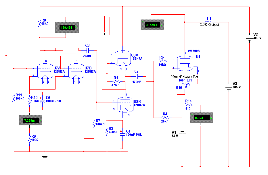

Now remember your paralleling the input tube, so your load doesn't need to be as high as a single. :)
I'd go with a 43k plate load resistor, 450v B+ (giving the plate roughly 190v) and ma at roughly 6mills.
Follow that up with 1 more 6sn7 (or other dual triode) as cf for both channels (raising the heater), should be all set.
I would agree though, no feedback and UL or Pentode may have your output impeadance just a tad high, but try it first.
Sounds about right. Those look like measured voltages. 8 volts on your 1150 ohm cathode resistor is very close to 7 ma. That current across 30k is ~209, so 192 volts plate to ground. Your B+ is 900 volts. The max driver plate resistor you could use is (900-192)/0.007=101.4 kohms. With 60k on the 813 grid the AC load seen by the driver goes from 20K to 37.6K, which should buy a nice decrease in front end distortion without changing the tube's operating points. Pick a comfortable spot in the middle somewhere. You should double check the plate curves to make sure it still provides the required swing however. If that's a borrowed design there's also the possiblity the driver's distortion was tuned to cancel the 813. FYI.
With the 813 at 900V/100mA, Vg is going to be somewhere near 80V. A 6SN7 doesn't have enough gain.
This tube also sounds it's best with a driver capable of supplying some heft: a trioded pentode driven by the 6SN7 perhaps. Grid current can also be a bit of an issue if you drive them within a couple of volts of Vg=0 so account for that in the design.
Because I ran mine PP into horns, I didn't nedd the power usually only using a few watts max, so i found one of the 12HL7/12HG7 pentodes to be excellent as the gain/driver.
Edit: above applies for triode. Why bother with UL?
Now I've never built an 813 amp, someone mentioned there easy to drive, but if there anything near the
requirements of say what a 300B needs to drive it, you may find my original 300B circuit somewhat useful?
Since I put this together it's now an E80CC driver to the 12BH7 to the 300B. It works nicely with plenty of drive. :)
Just some food for thought.
You could run your parallel 6sn7 front like you have with a dual triode backend like the one in this scheme for drive.
Just throwing it out there.

By looking at the biasing on the 813 I'd say you need some drive.
You could use my basic 300B schem (your parts/voltages) and sub your 813 in for the 300B, you don't need the 300B to.
Your Parallel 6SN7 with 450v and 43k pate load to a 12BH7 (Like the scheme) to your 813 output section should be fine.

You have to decide how much gain you need; what are you going to connect to the amplifier? If it's a CD player, then given that they deliver 2v rms maximum, then I should say that you will be marginal. With a c. 40k anode load you'll probably get A of about 15 from your 6SN7, so you will probably not have the gain you require. I would probably use a 6072 (µ = 44) and the 6SN7 as a cathode follower.

With a pre-amplifier, you should have enough gain with the 6SN7; but make sure that you can swing enough volts on it. An active load might be a good idea, as you will get gain close to µ and low distortion.

With an active pre yah you can get away with less and push the driver tube harder, but for me if I'm building the
thing I'd rather go the right direction in the first place, with a nice low distortion high drive low impeadance front end
it should sound better as well, might as well give it it's best chance to shine, at least on a nice project like this one here.
If your bias is say -85v you'd need double that to drive it full, not saying you need to drive it "full" but get it up there a bit.
The bias on the 300B is quite high, look at some well done 300B circuits as well to see how there driver schemes workout.

Look at something healthy for the pentode driver. Remember, when rigged as a voltage amplifier, it is going to be a *VERY* easy load. Fix g2 with an appropriate shunt regulator. Look at high-gm TV sweeps, perhaps the 6CB5A or 6CD6. They will all take the kV plate supply and if you source B+ from the screen tap you can do some interesting stuff feedback-wise. 6CB5A with a 10k plate load and a 75V g2 supplied with an 0A3 will net *LOTS* of gain...:)
