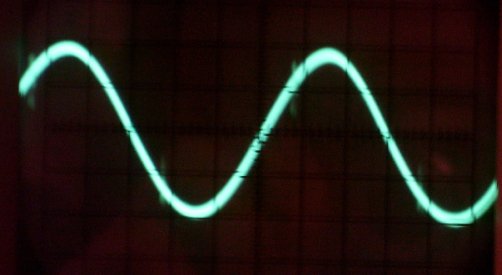

"I had such a glitch that caused nice ringing on 30 KHz, couple of years ago. Ringing was of quite high Q, and started on frequencies below 100 Hz approximately; when frequency was higher it did not ring. Most probably, when driving with frequencies closer to saturation (Edcor specified 20 Hz on full 100W power), something in M6 iron caused it to increase leakage inductance."
The Edcor P-Ps that I have measured have very high leakage L on the outer 60% winding on one side. Did the the Zobels help before they burned out? I assume there were two of them, each from B+ to plates. You might want to measure the frequency response of each side (separately) of the primary to the loaded output too, you might be in for a surprise.

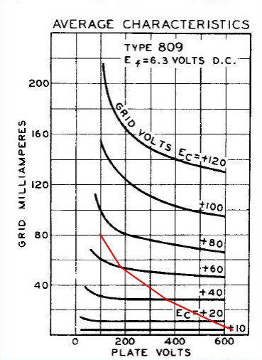

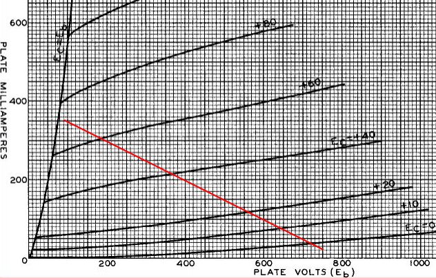

"is this a project worth pursuing? I have 4 pairs of new RCA 809's and not sure what else to do with them. And if I do build, do I transformer it or mosfet it or perhaps sell the tubes cheap and cut my losses."
Well these tube are big enough that driving a Mosfet with them in class AB (- grid bias) would be a little silly really, mainly just for show. Going into positive grid V will require some Mosfet followers to drive the grids, high drive signals from the driver stage, and looks like an expensive HV B+ setup and OT. Curing the glitches and crossover problems is somewhat of a research project, although I'm sure they can be tamed, it's mainly a question of which way is best to proceed. Not a beginner type project in any case, will need some decent test equipment. I myself refuse to work with any Xmit tubes over 500 V B+ simply for safety reasons. Lots of cheap Sweep tubes around that will put out good power at low B+, high current.
Solving the glitch problem though is still open territory in DIY, since Mac type OTs are not abundant. And so many OTs have obvious problems with this for at least one side of the primary.
