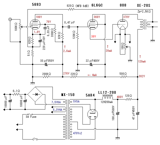

After a little googling I come up with this japanese schematic using a 6L6 as cathode follower to drive the 808. Notice that the cathode of the pentode is directly connected to the grid of the 808 and as far as I understand the current passing throught 6L6 act as grid current for the 808. I have never seen this again and I do believe it is worth to try it just, to see how this thing "plays music".
Unfortunately I have to use a pentode on this configuration (I hate pentodes!!).

Well, the pentode in this case is strapped as a triode. ;-) Actually, pentodes generally make better cathode followers than triodes.
I note that the circuit uses NFB, presumably to get the output impedance down. The 801A amp that I'm using had global NFB and cathode feedback to. I ended up disconnecting the global NFB, because I preferred the sound witout, even though the bass was a bit "looser". I left the cathode feedback in though.
If you build it, let us know how it turns out....
