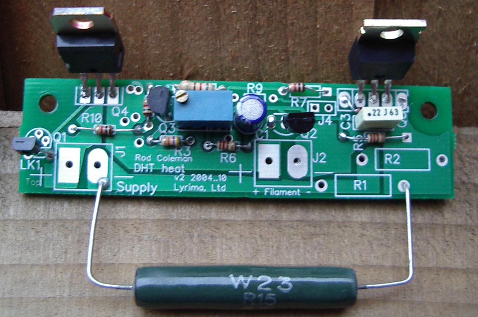

You'll probably want a nice clean filament supply for the 808. The mu is pretty high and a little bit of ripple will really be audible. 30 watts for a filament is more typical of tubes with 100 watt Pd like the 845 or 211.
I did a bit of playing with a regulator chip from Micrel, the MIC5156 MIC5156/5157/5158 Super LDO™ Regulator Controller. It drives any large mosfet as a pass device for the regulation, the only drawback is it needs a second higher voltage to properly drive the mosfet gate.

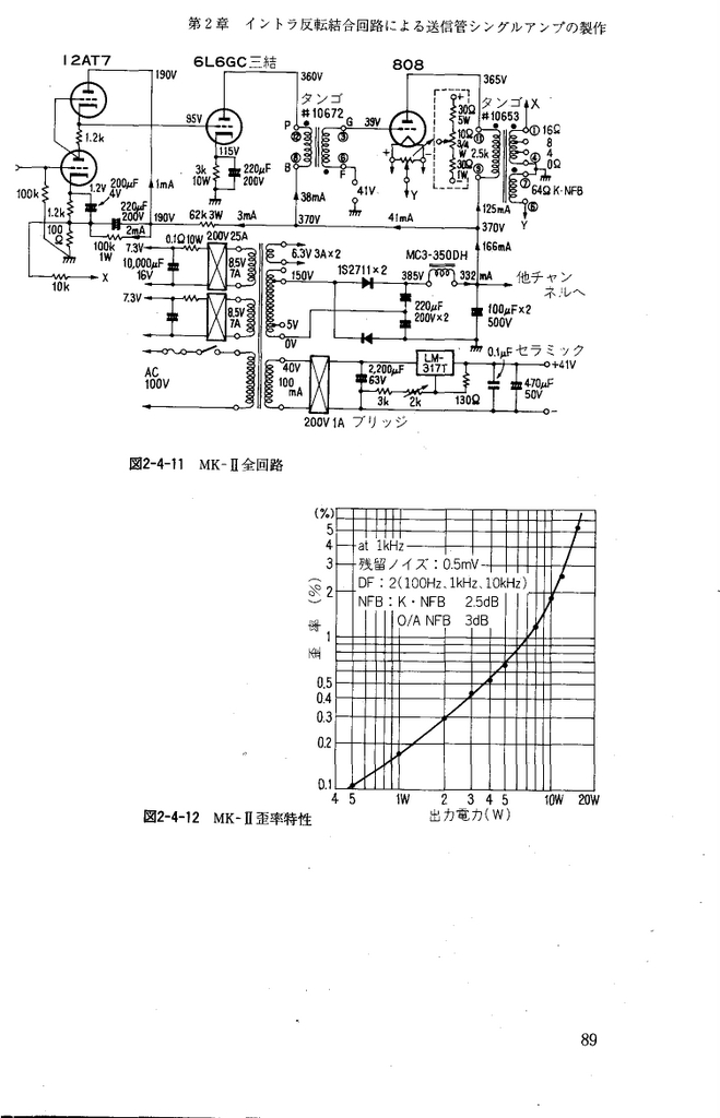

Somewhere I used to have a page bookmarked that was in japanese but had tons of schematics for oddball tubes. They had a few designs based on the 808 and had a switch for running with an 812 as well. I was going to build one but the numbers they posted for power output vs distortion weren't too impressive.

It's true, the ripple will make itself felt. With a carefully designed Regulator, the feedback for the filament current does not get mixed-up with the cathode current. I believe this is best implemented with discrete transistor design - which can eliminate the need for the noisy bandgap reference-voltages found in IC regulators.
I have a purpose-built Regulator for the RCA-808. It's a discrete design with ultra-low self-noise, and has a control-loop which makes no contact with the filament. Available as self-assembly kit, DIY friendly. Plenty of DIYers on our forum have expressed their pleasure at the difference to the sound.......
Further to the link I posted at No. 14, I refrained from commenting on the designer's input valve choices on the grounds that he is obviously jolly clever and no doubt has reasons for his choices.
I would not use 12AT7 and especially not 12AU7 as he has in his designs. SImple alternatives would be 12AY7/6072 and 6SN7. I see however that the 838 design which is perhaps relevant to this thread has 77v rms (+40dB) feeding the grid of the 838. I once built a very low distortion driver stage providing this output - I measured 0.063% this driving a 30k pad. The stage used a 7N7 (what else!) followed by a pair of E810F (7788) pentode cathode followers. The stage did require +ve and -ve HT supplies but was designed for DC coupling to the output valves (in this case triode strapped YL1071).

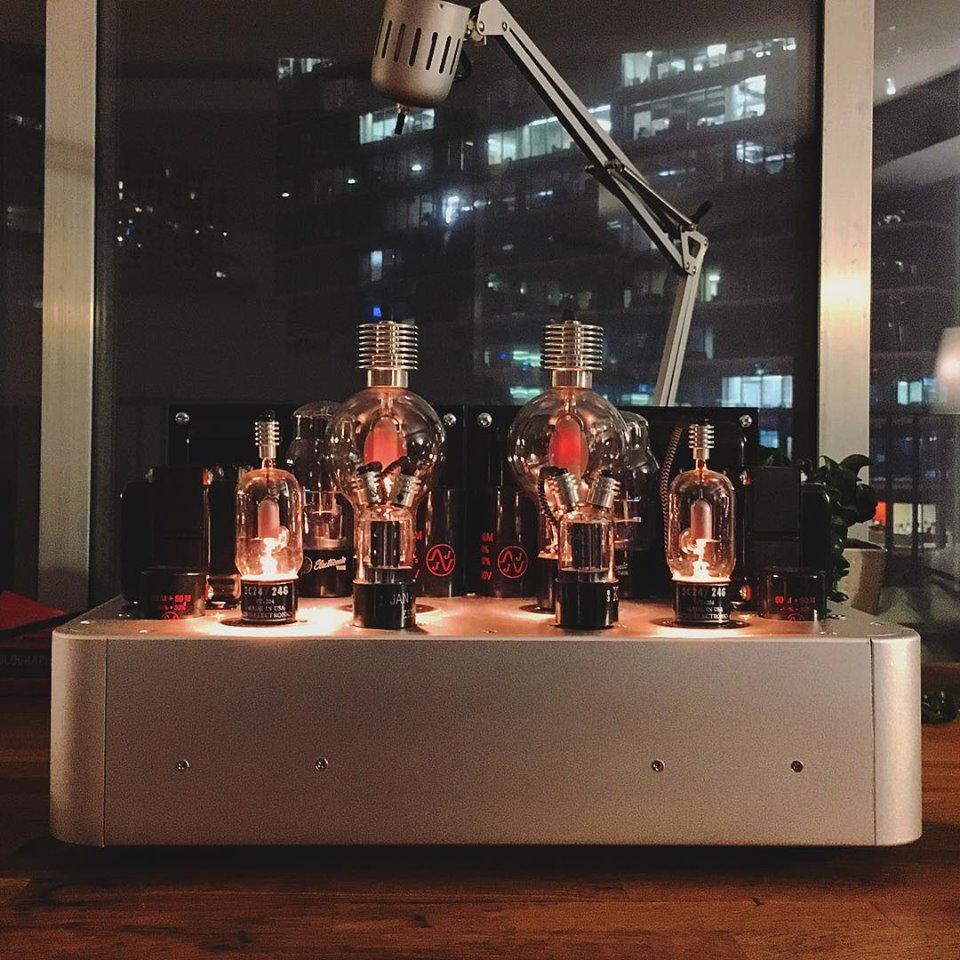

Here's how it turned out.
Sorry this took me three and a half years to build. Anyway, here it is. Huge thanks to this forum and to Rod for his DHT regulators. The thing sounds great.
You guys were all really helpful and I can't wait to build whatever comes next.
PS, yeah, don't touch the caps. Seriously.
