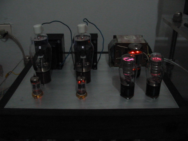

FWIW, I built the Gordon Rankin 807 and I like it, but I busted my 6072 which caused me to retire the amp.

Hi all,
I just thought you might be interested in how I spent my Sunday. I have just completed the circuit part of the conversion of my parafeed RH807 from CCS loaded to Choke loaded. Its still on the test bench with crap speakers, so its to early to say how it sounds really.
I used microwave oven transformers as my plate chokes. Surprisingly enough they work fine. I had a few worries for a bit because I was losing response from about 300hz down. I tried putting another choke in series with the MOT to see if it was lack of plate inductance, but that didn't clear it up at all. I messed about with the plate to plate feedback to no effect. Finally I remembered that my output transformers (modified mains toroidals) need to be wired up with the primaries in one direction. So I reversed the connection and hey presto the response is nearly flat down to 10hz. Response is good up to 35khz where it starts to trail off - which if my memory serves me well was how it performed with the CCS load.
I have the screen of the 807 with a voltage divider and a 100uf bypass.
In my tests I thought that the bass roll off might be attributable to the pentode connection, so I wired it up for triode strapped with no series resistance, it helped a tad but not much. There was a difference in sound though. The triode strapped version sounded a bit smoother, though not much.
With the choke load I am able to use more plate to plate feedback. Before I had 150K, any more produced a resonant hump in the sub 100hz bass response. I am now able to use 100K without any hump.
Overall I am very happy with the result so far. I will report some more when I have finished the case and auditioned in the main system.
