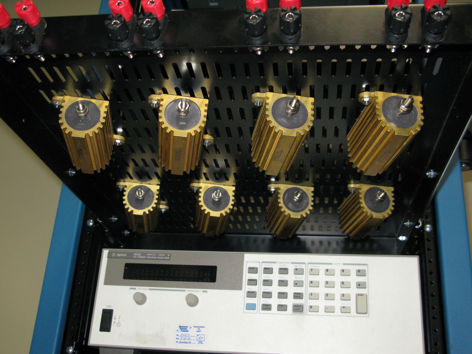

800W Load - Rackmount
I bolted everything to the underside of a slide out shelf...
When not in use, slides fully into the rack, dissapears, and
becomes a normal shelf. But havn't wired anything yet.
The front is organized for series & parallel bus wires to go
through the posts sideways. The hole in the side of each
binding post is the same size as the hole in front.
So, anyways: This is Qty8 of 4ohm 1% non-inductive 100W.
Lead times and prices on >100W were unreasonable, so we
settled for several 100W that can be reconfigured as needed.
These Dales came from Newark.
I used bolts that would normally be countersunk, such that
the top shelf surface is still reasonably flat and unobstructed.
Nice work.
I think such resistors expect some surface heat transfer to make full wattage. Don't know if they will do full spec with just freeair dissipation. A bit of heat sink compound between resistor and chassis will definately help. Just a thought. Also, if you are going to opperate in flip up attitude, a small plastic or sheet metal tent over each resistor will help promote chimney effect free air cooling.
Doc

I suppose it depends. I have some high power resistors like that bolted to a large heat-sink and on sustained high power tests the sink gets really hot. I am sure that you could easily increase the total sustained dissipation capability by using a better method for cooling, but whether or not this is needed is another matter entirely.
If it needs more of anything, it will get more.
For now, this is probably slight overkill.
Don't go over-imagining that I would use this
at full power 24x7. Its for production testing,
not solid weeks of burn-in or characterization.
Our customers have their own labs for that.
If you are building a load for sustained use,
those considerations are probably relevant.
I have 8 of these same resistors mounted on a BIG piece of aluminum extrusion that is about 3' long. I have it wired dual channel with 4x resistors wired in such a way that i can easily get 8 ohms @ 200 watts, 16 ohms at 400 watts or 4 ohms at 400 watts. Or I can do 8 ohms at 800 watts single channel.
I have run some pretty big amps on this load bank and i have yet to get it even hot to the touch! and i have hit it with over 2000 watts for short periods of time.

I'd say the instantaneous or short term power handling figure for these types of resistor is fairly large, especially if the resistor is cool when the large power dump is applied.
If you look at the data-sheet for this product, you will see figures quoted for power exceeding rated specification vs time.
For example they will handle 5 times rated power but only for 5 seconds, or 25x rated power for 1 second. So in other words you can easily do extremely high power burst testing without any issues. Obviously the duration will be linked to the heating of the internal power element and the higher short term power figures being related to the fact that the heat cannot escape quickly enough through the casing, so no matter the size of the heat-sink, the power element will overheat if the overload condition persists.
