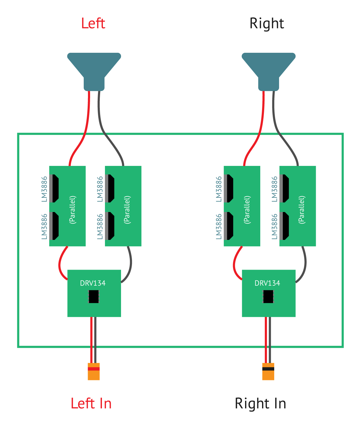

I have exactly 8 x LM3886s and 2 x DRV134 floating around in my collection, and I'd like to put it all together into a single, monstrous amplifier.

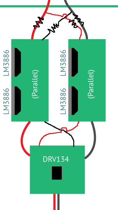

My idea is to create 4 duplicate parallel (PA100) boards (each with 2 LM3886s). Then, using a pair of DRV134s, bridge them together in pairs for each speaker, like in the attached image.
I see @danielwritesbac mentioned this setup here, but has anyone given this a shot? I can find plenty on the "standard" BPA200 and PA100, but in this layout is there anything I should be aware of, pitfalls, problems?

Your idea is pretty good. Building four boards and testing them before cobbling everything together is a very good idea. Run the amp on ±28 V and you'll be fine, even with a 4 Ω load. If you want to get up to ±36 V, you'll need three LM3886es per side to support the output current. That's basically what I do in my Modulus-686. I then add error correction to drive the distortion to levels way below the noise floor, but that's beyond the scope here, I think.
There are many pitfalls: Stability, decoupling, power supply sequencing, DC offset balancing just to name a few. I suggest starting with my Taming the LM3886 article series: Taming the LM3886 Chip Amplifier

Question: When building the LM3886 boards, would there need to be any difference in construction between the boards driving the positive signal and the boards driving the negative signal (i.e. any polarity considerations)? Or is it just the case that I'd feed the corresponding output from by DRV134s into identical LM3886 boards? Obviously, if I could make 4 absolutely identical LM3886 boards that would be ideal.

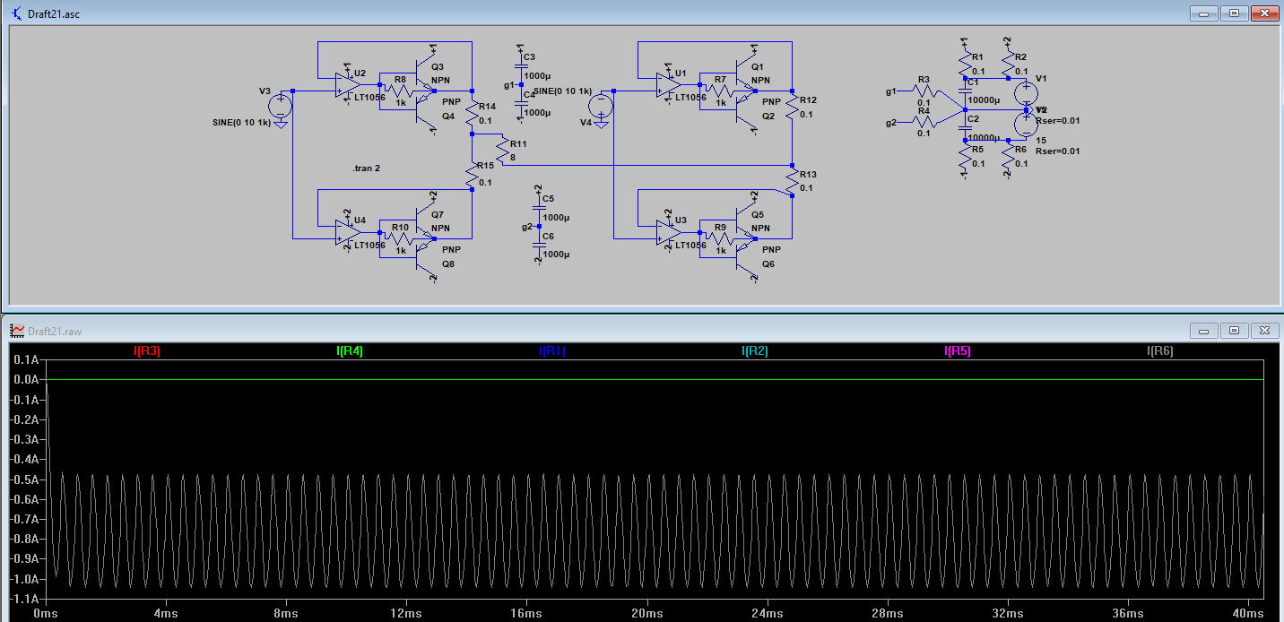

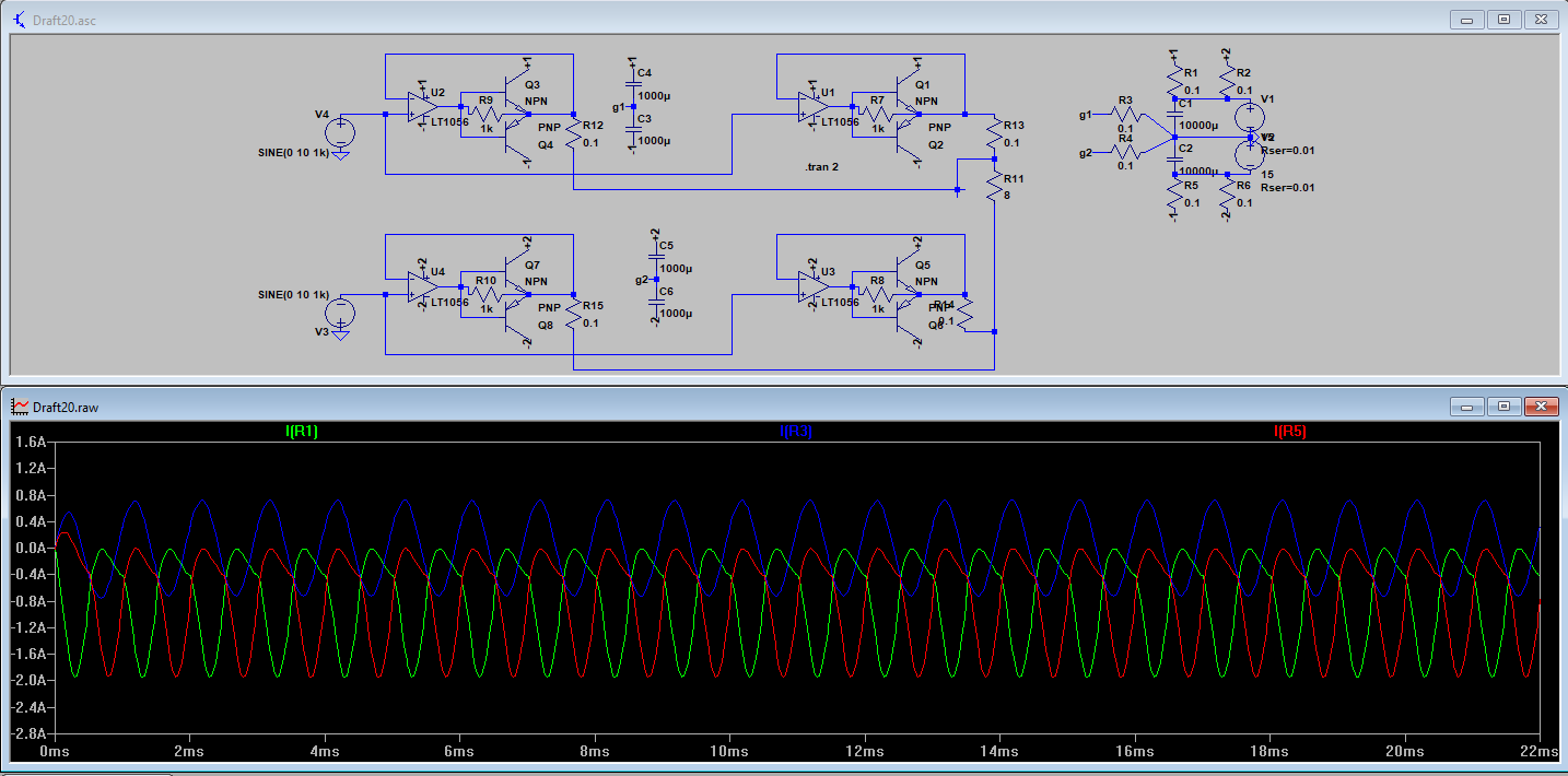

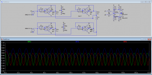

@audiolapdance: actually, the two way of doing it aren't completely equivalent. There are way less circulating currents in between the boards and power supply using two bridged pcb rather than two parallel pcb.
Here are the simplified sims. To simulate two pcbs, two "amps" are using the same supply (+1/g1/-1 r +2/g2/-2). Those supplies are tied to main caps through 0.1r resistors to visualize the currents. There are bypass caps (1000uf) on each "pcb".
If using two pcb with // amps, there are quite heavy currents circulating in the wiring between the pcbs and the psu. If using two pcb with bridged amps, they are much reduced.
Would it matter in real life ? No idea to be true. I attach the asc files in case someone wants to verify I didn't mess up the sims.
