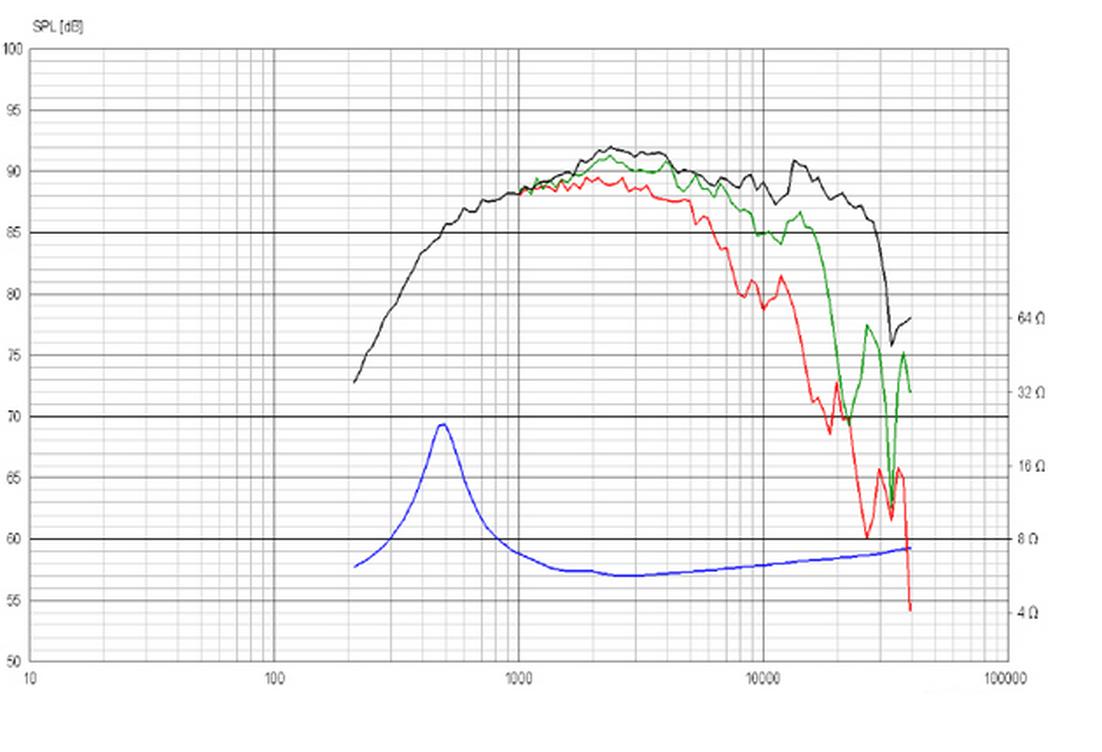

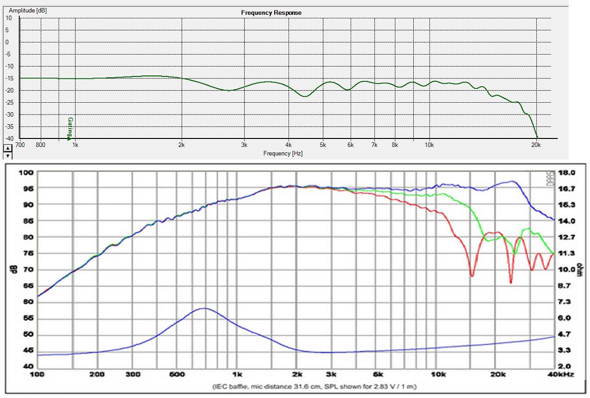

Another update, going back through the flurry of speaker builds for the last couple of years and mic testing.
This is a little unusual, the tweeter has a dip at 4.500hz (top graph), I'm curious if that is a placement/cancellation issue?
The SB29 graph (specs) looks a little different now also.
