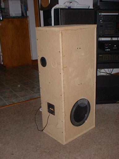

ok, welli calculated evrything and started the project at 7:30 pm... finished at 11:30 pm...the glue isnt even totaly dry yet lucky me i had evrything i needed at home, as proper vents and conectors and stuff for the XO
i still have to cover it with something, maybe some veneer.
i tested it... and whoa.... this thing sounds awsome(with the mid/tweeter speaker not shown on pic, it usualy stays on top of the sub woofer),
about the best ive heard yet,
the system will have 2 woofers like this one and 1 mid/tweeter speaker on top of each woofer,
thats a rear/side pic of the sub, the front is not seen here

its a driver i bought for very cheap in some surplus store, but its very good...measured it and did the box. 2 cuft is massive... one thing im worried about, i used a 2" port diameter, tuned at same fs as driver, and its around 1.8 inch long (not sure.. gotta check.. at school now) theoriticaly its fine, what im worried about is it's surface,
i'll maybe try to use 2 2" ports for a larger ports surface (you can see on the pic that this was my original plan)
