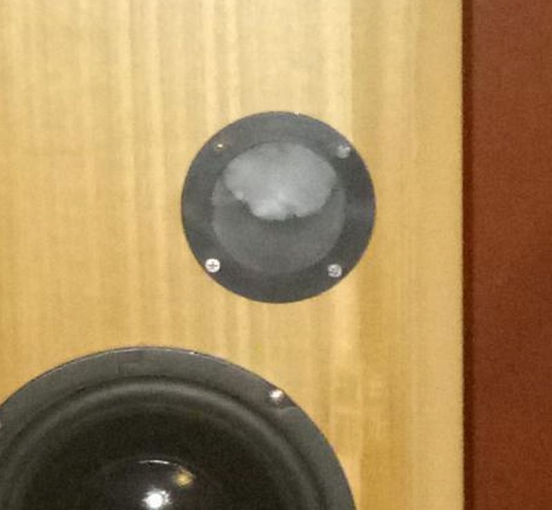

Hi, I'm after some advice or comments.
I built some cabinets to suit the Jaycar CW2136 drivers many years ago. Cabinet volume is 33ltr, 66mm port at 165mm length. They sound OK, but I'm looking for advice about some better quality 8" drivers that I could use to replace my existing ones. Drivers suitable for my existing 33ltr cabinets...
The lower driver in the picture is in a 40ltr separate compartment, and is driven by a separate 300wrms and (sub signals only). The sub is fine, just looking to improve the 8" driver and possibly the tweeter as well. Speakers sound very light sounding and lack bass without the sub woofer being active.
Thanks in advance.

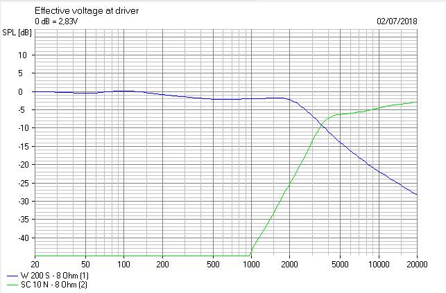

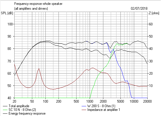

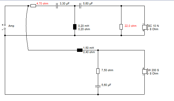

I have rustled up a crossover that does the right things with almost any well behaved 8" bass. Because I have tried it. I'd assume the 1" tweeter is about 90dB loudness. That is easily adjusted later.
I've used some of your existing capacitors to save money. If the tweeter is a quieter 87dB type, lose the 22R and replace 4.7R with 2.2R.
Cheap Non Polar audio electrolytics will be fine here. 10W wirewound and ferrite cored 1.5mH. Air core 0.2mH.
This will have far more bass than your current set up. I always fold component connections rather than cut them short. Makes components reuseable. Which saves money. I also keep a stock of wirewounds. Say pairs of 1R, 2.2R, 3.3R, 4.7R, 6.8R, 10R, 15R, 22R. They are cheap and it saves time. :)
You can build crossovers on a piece of hardboard. Or a PCB. You will need some speaker cable, of course. modest 5A does for me. Have a go.

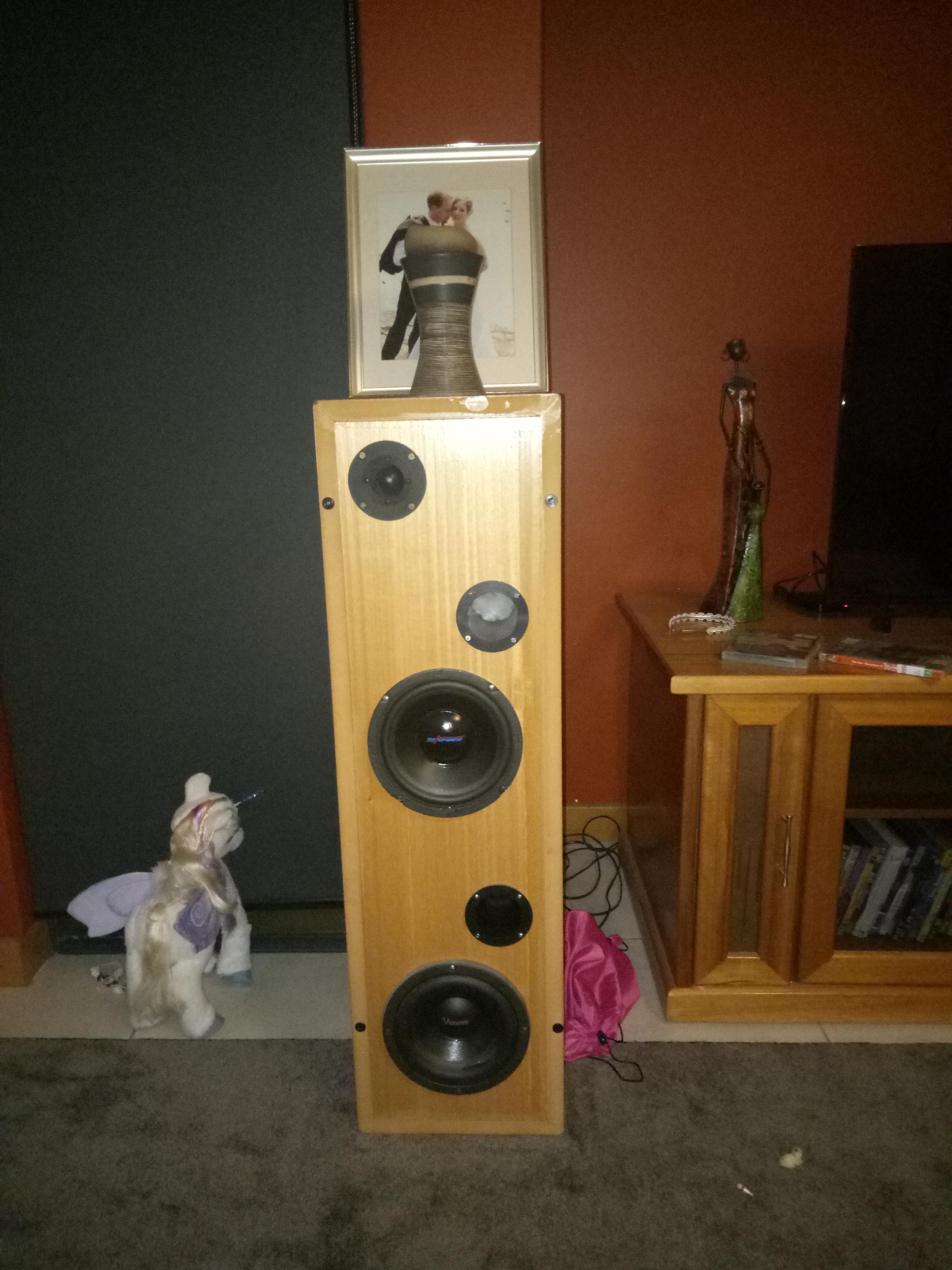

687319d1529236762-6-8-woofer-system7-wlm-la-scala-clone-jpg
I've just got the parts for my newest build, above. I'm looking forward to this. The previous one was good anyway. But always room for improvement. :D

Hi Steve; this is not a critique-I’m trying to learn the dark art of crossover design. What type of crossover is detailed in your schematic? It doesn’t resemble the schematics I’ve seen for a third order Butterworth as an example. Also do you use any online calculators or do you use longhand and formulae?
Thanks in advance,
Nigel
It's a circuit that works well with high inductance woofers, but Troels uses it with more regular woofers in the TQWT with an added 5kHz breakup notch that I didn't really like: TQWT-
First order with impedance correction.
