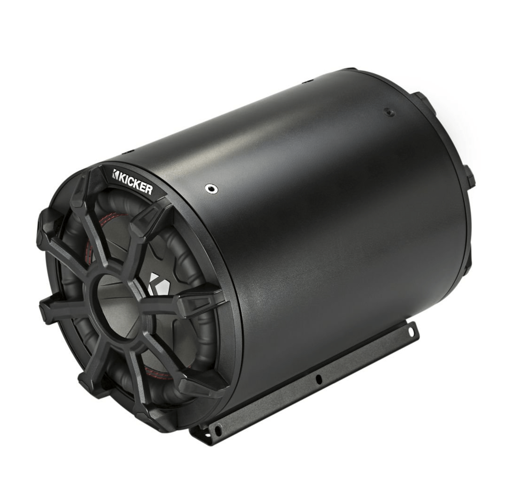

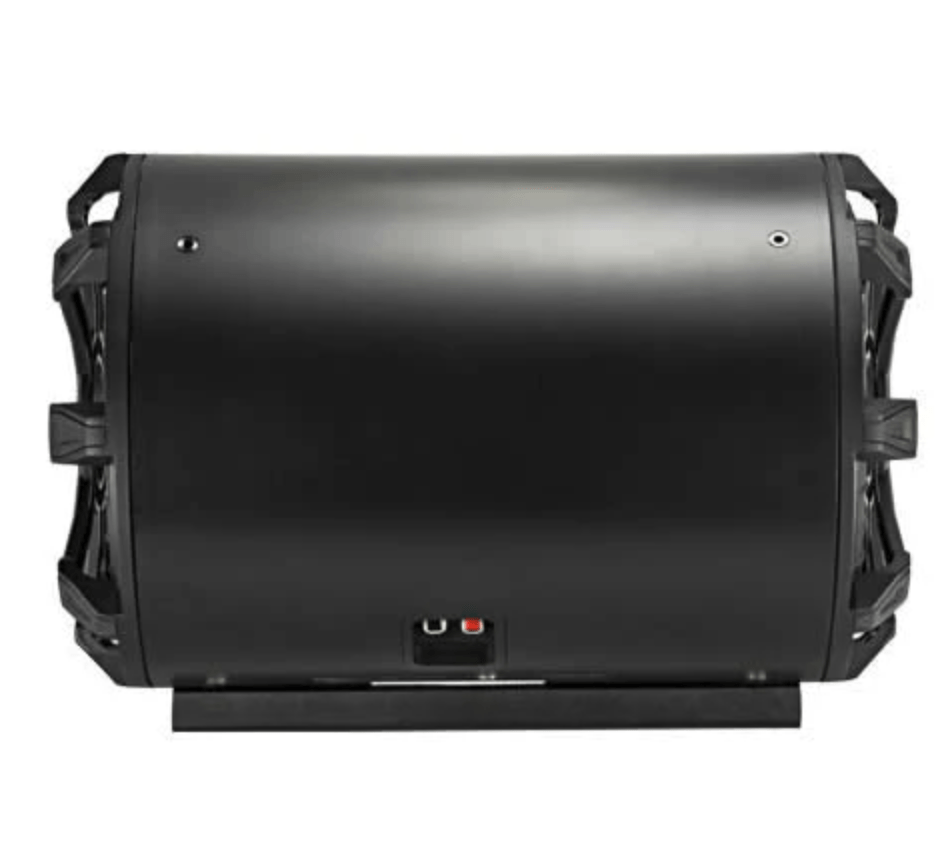

I just came across the Kicker TB8 (photos attached) which is basically what I'm looking to build. It's a compact bass tube with an 8" driver on one end and an 8" passive radiator on the other end that happens to fit within the allotted space in the car.
I'd like to design and build a DIY version like this Kicker design but using better components for better power handling. I'm just having trouble finding the right driver and passive radiator for the project.

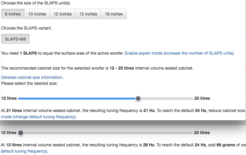

https://www.earthquakesound.dk/wp-content/SLAPS/index.htmlAny thoughts on my driver/radiator selection and what I might be missing?
According to their calculator, the SLAPS-M8 is so heavy the Fb in a 21 Liter (.75 cubic foot) box is 21 Hz, dropping the box to a tiny 12L raises the Fb to 28Hz.
The SLAPS-M8 specs you linked say it has a "preinstalled 160g mass", removing some (or most..) of that mass should bring the Fb up to 30Hz in a .75 cubic foot net enclosure.
The specs also claim the SLAPS-M8 has a 3.5" Xmax, which would be 7" peak to peak, not possible with that surround.
Even 3.5" peak to peak, an Xmax of 44.5mm, seems high for an 8" PR.
Looking at the rear of the SLAPS-M8, it seems likely that 3.5" is a misprint for 35mm peak to peak excursion.
That would be around the same displacement as the Dayton UM8-22's 16mm Xmax, the SLAPS-M8 might run out of excursion before the UM8-22 does.

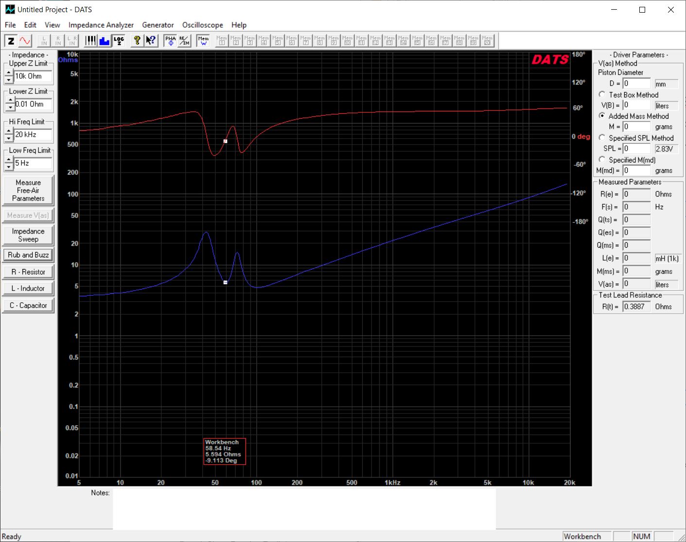

I have a small sub I'm still building on. I uses a TB W8-740P and a SLAPB M8 Without added weight ... so not like the picture above ... no screw going through ...
The drivers are mounted in a 10,7 liter box.
I just made an impedance measurement to verify mu assumed parameters used in WINisd. It matches quite well giving a resonance around 58 Hz. See picture.
In WINisd I'm using the following parameters for the M8:
VAS = 32 l
Fs = 30 Hz
Qms = 7
Sd = 189 cm2
Xmax = 20 mm
Totally agree the 3.5" Xmax,pp is not possible ... that is why I have set it to 22 mm

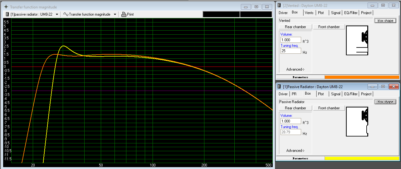

Here is 2 designs using the Dayton UM88-22 in Isobarik configuration.
Orange Line =
1 Cubic Feet, ported, Fb 25 Hz, F3 response 21 Hz
Yellow Line =
1 Cubic Feet, Passive Radiator, Fb 28 Hz, F3 response 25 Hz
Passive Radiator = SLAPS-M10 with 140 Grams of mass added
When you select your project in WinIsd
use the Iso-barik (compound) option
Orange Line =
Yellow Line =

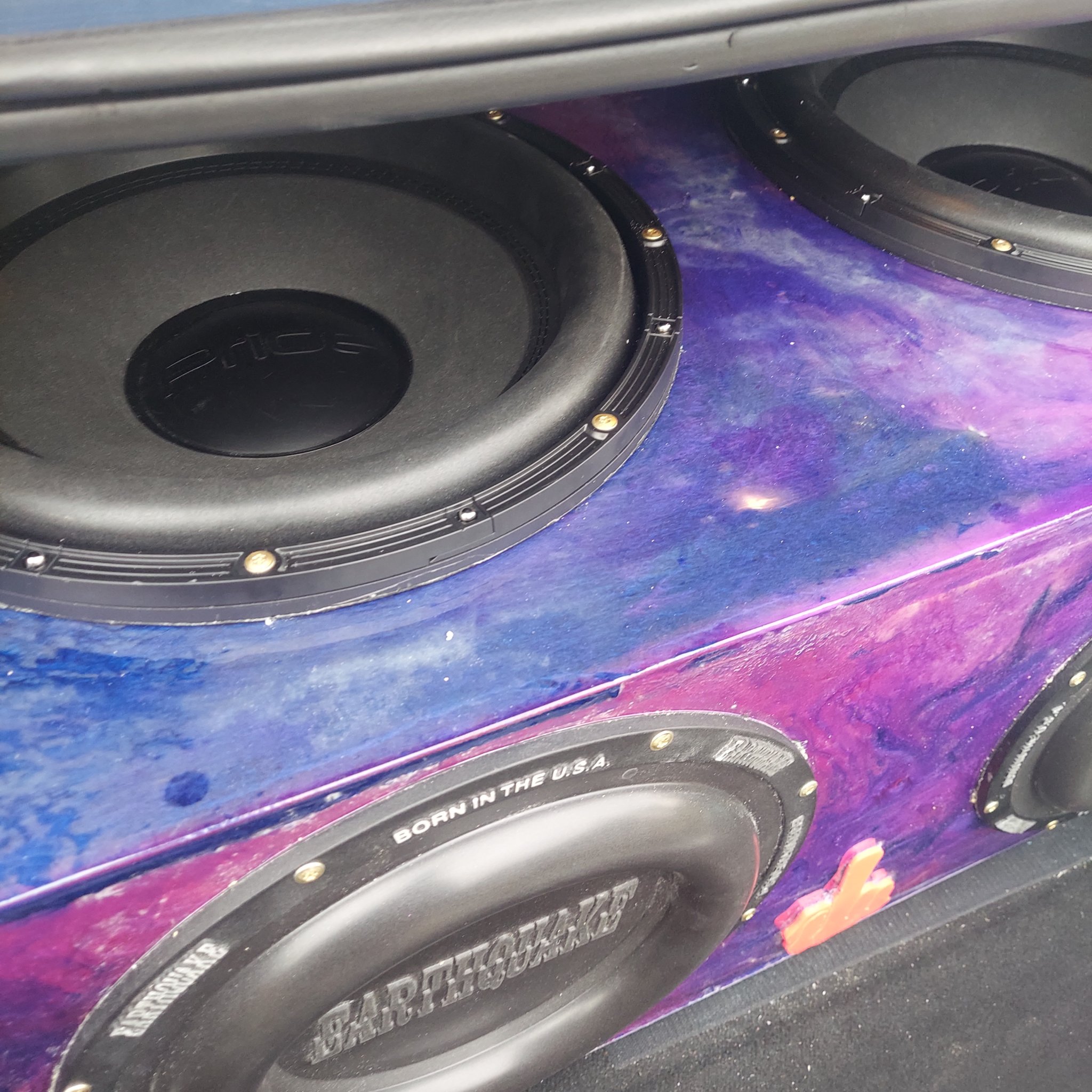

Did this turn out well? Just did another PR Box and it sounds awesome. Used 4 SlapsM12s...
jassky's Post #11 on 2022-08-06 was his last post here..
Did the tuning on your SLAPS M12s come in as their charts predict?
I didn't use the weights. It was too low. I like to hear my music and feel it. Read somewhere without mass it was 30hz. They would definitely do better
in home theater or a smaller box in car audio. I also took out the Prides (Qts .66) and replaced with Earthquake DBXi 15s. It was good with the Prides but much better with the EQs.
