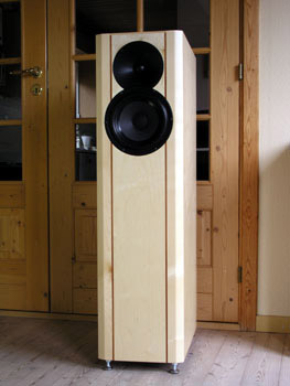

Troels Gravesen, Denmark DIY Loudspeakers website:
"BestSpeaker I ever made.. "due to the large midrange driver, 8", and the large wave-guided 34 mm dome tweeter."
"Some people question my statement that the DTQWT is the best speaker I've ever made because I've made quite a few speakers since then and how can I still hold this opinion despite Jenzen D, etc.? Well, the DTQWTs can do things none of the other speakers can do in terms of overall dynamics due to efficiency, mid-tweeter integration and because they don't have a crossover in the critical midrange. These are the three main features. The DTQWTs can play a piano, an oboe, a flute and a saxophone louder than any of the other speakers partly due to the large midrange driver, 8", and the large wave-guided 34 mm dome tweeter. Size matters and regardless of the quality of a 5-6" midrange driver there are limits to how loud they can play. The Jenzens all have less dynamic head-room due to these limitations although satisfactory for most applications (average living room size). The DTQWTs can be played to satisfatory levels with my 45 watts SET amps, something none of the other speakers can do and my 6C33 valves sounds better than my solid state amps. And some mistakenly think the DTQWT are only suited for low-wattage valve amps because they were developed for this, but any good amp can be used with the DTQWTs, they may just not sound as good as they could if you had a good triode amp. There are reasons people bother nurturing valve amps as some require regular service, but we don't get it all for nothing. So, the DTQWTs are still my best speakers regardless of cost and specific areas where some of the others may excel. All speakers are compromises and fortunately the amount of speaker designs seems unendless and there should be one for your taste too."

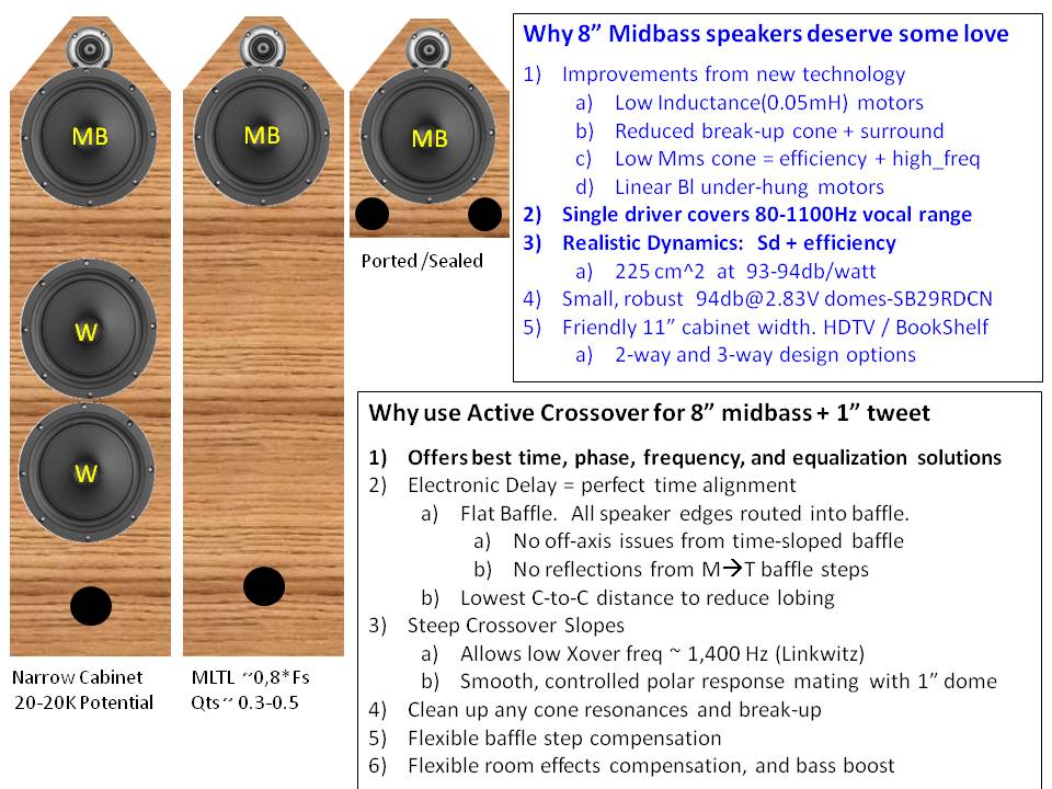

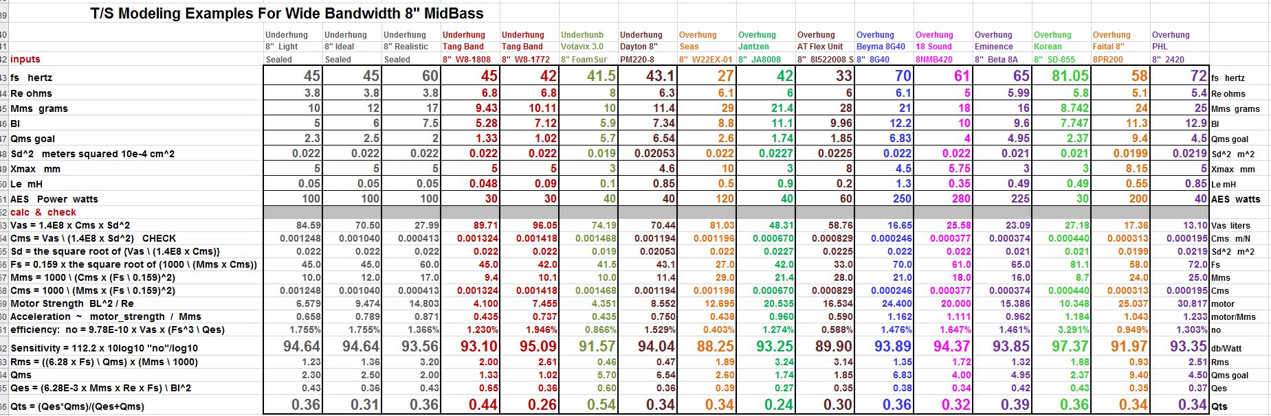

One of our favorite speakers because it "gets vocals right" is a 2-way using a Tang Band W8-1808 without the whizzer cone in a 4 cuft MLTL, and a SP29RDCN dome tweeter passively crossed LR4 at 1,400. I have been using this speaker with an old PC to get an education on digital crossovers, and have found digital time alignement a noticable improvement over passive xover. Active xovers can optimize the 8" + 1" union, with or without support woofers.
