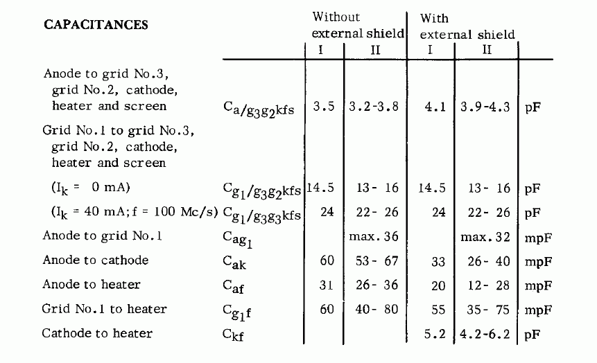

From E810F SQ datasheet:
For D3A tube, that is 'Anode and grid No. 2 to grid No. 1' Cag2/g1. Is it actually Cag value?
And what about Cag1? There is no value for Cag1 in datasheet.
Does anyone know how to calculate Cag value for 7788 tube?
Did you perhaps not understand the post you quoted? You are interested in triode mode? Do you not understand the difference between a triode and pentode? The 2.7 pF is Cag when shorting g3 to cathode and shorting g2 to anode. The 3.3 pF is Cag when shorting both g2 and g3 to anode.
