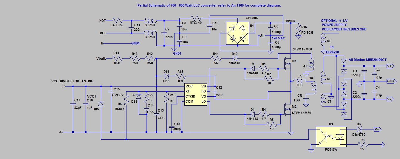

This is as much as the primary power stage can be simplified without safety issues or malfunction.
There are a few equivalent variants ("isomers") obtainable by exchanging parts that are in series, or by moving one part from one mains wire to another (as long as there are no EMI issues by doing so, another standard rule: "the square wave goes first to the inductor").

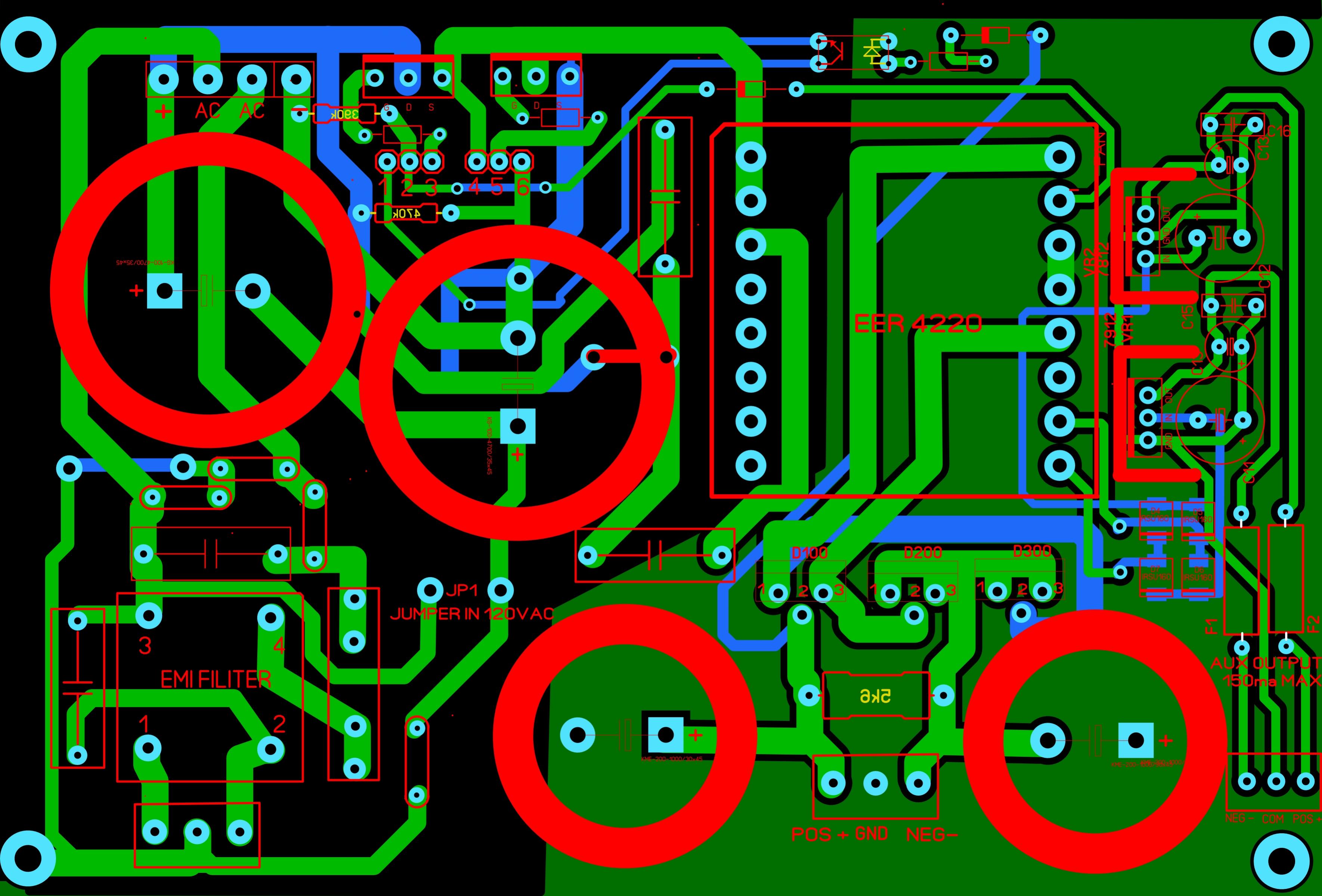

Recommended distance between mains leads before/at CM filter and across fuse: >=4mm.
Recommended distance between HV/switching/GND nodes at/after diode bridge: >=1mm.
Distance between nodes of primary and secondary sides (including mounting holes): >=6mm.

I am checking with Christophe Basso now to see if the LTspice models are valid for this controller.
Would be nice to provide a LTSpice Model for the NCP1396 as well, the one I use for years.
Check FAN7688 and associated app. note AN6104. However "scientific poking"/"carbon copy" method does not work neither in audio world nor in PSU one.
Try to replicate reference design to begin with.
Simulations usually create false impression of simplicity.
Tweaking off the shelf PSU for a different output voltage is not straightforward.

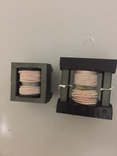

I recommend starting with an unregulated LLC-design operating at a fixed frequency tuned to series resonant frequency of LLC tank. So it does not matter which LLC-controller is at hand. This is the switched mode replacement for toroidal transformer supplies, i.e. output voltage follows main voltage directly with some 100Hz ripple, at quite a low output impedance. I built several of these with output up to 500W. Most heat was produced by secondary rectifiers, so the next step was introducing synchronous rectifiers to reduce heat sink dimensions.
Then you have the choice between a transformer with "integrated magnetics", i.e. loose coupling for sufficient stray inductance, or a separate series choke - making compact transformer design easier.
If short circuited/overloaded the no protection/feedback series resonant circuit will blow-up. The same will happen in case of improper timing like trying to operate below resonance due to capacitive impedance at the inverter. Moreover resonant frequency does change, depending on load. Self-oscillating thingy which follows the frequency intrinsically is not that easier to play with.I recommend starting with an unregulated LLC-design operating at a fixed frequency tuned to series resonant frequency of LLC tank. ...
