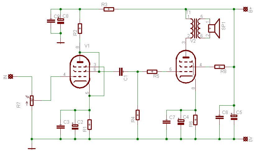

What is the purpose of the second half of the 6sn7 in your design ? I'm a newb , but it looks like it doesn't do much of anything in the way of amplification . Perhaps provide LOTS of feedback ?

Stop bothering about feed back
The only one in this amp is obtained by returning the cathode of the 6V6 to the LSP output !
Unless you consider that a cathode follower IS a 100% feedbacked stage . . . and yes . . . it is

Oh ! Forgoten the unbypassed cathode resistor in the 1st stage.
The second half 6SN7 is here to feed the screen of the 6V6 wth some current.
