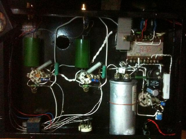

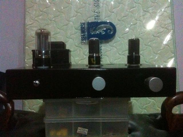

Hi, I have completed the 6V6 line amp built, indeed the sound is big!
I have used Salas' standard line circuit with a 6L6GC shunt regulator. Using the parts that I have, B+ is 292V, 18mA through the circuit.
Thanks Salas!
Hi, I would recommend you use a higher load value in these conditions. Try adding 2.7K 3W-5W resistor in series to the 5K anode load one and tell us if it got better or not. Pictures would be nice too.
I have been messing with the circuit today and have learned a few things -
I have got some hummm, but I think it's a wiring problem. It goes away when the pot is turned all the way up or down, and worst at the mid-position.:confused: :confused:
I think I also have some filament hum, as they are AC for now. I will put together a quick and dirty regulator for them tomorrow.
My 6V6 pre works fine AC heated, perhaps you should have a look at the routing of your wiring?

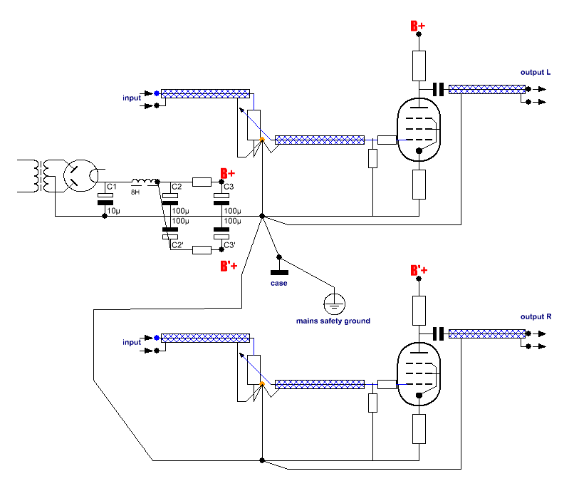

Here's a pic I made for someone else, suffering from grounding issues. Maybe it's to your service.

Do I see a GND Loop there ?

Tinitus: The RCAs must be isolated from a conductive chassis indeed.
Would you break up the signal ground and take it to the star directly?
Roberto: In reality the lines you made red are one and the same. Starground(s) and chassis connection is made to the capacitor that has the lowest ripple current to keep large loading currents from the ground. Star topology is used to prohibit larger currents to interfere with smaller currents. Exhaustive runs of grounding cables seem to work contra productive, possibly because of the extra inductance.
New scheme:
I suppose thats the point of having a starr ground, if there is one
though I prefer to look at it like multiple starr gounds, along the same string
often you see tube amp builders have one(and only one) solid core wire going through the whole amp, for all ground connections
and you often see the signal ground isolated from chassis/earth by a small resistor, or maybe a thermistor(look at NelsonPass DIY)

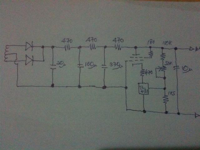

Not much difference to the way we configured it as you now got it. Don't bother much. Just order Mills 7.5K MRA-12 anode resistor for substituting the combo resistors you now use, when able. Is there a schematic you can post of the tube reg you use, and some pictures of the preamp if possible?

Nice, thanks. Effective solutions for box space and cost. Congratulations for finishing it. Those green Russian output capacitors were marrying happily with FT-3 0.1uF Russian Teflon bypass in some older experiments I did, maybe you can try if you got any. I should see to run a spice sim about the 6L6GC & TL431 schematic if I can get the models. Is the heater reg voltage source or current source?
What amp and speakers you drive with this preamp? What you had before in its place?
