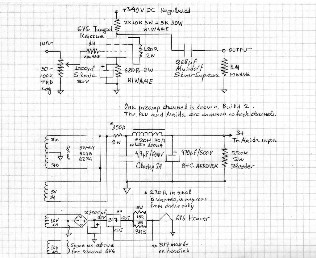

Comprehensive Schematic.
Hello,
Some people emailed me asking for a comprehensive schematic of how I made it, with final PSU etc. So here it is. Although it is explained in the thread, its better to be in one picture.

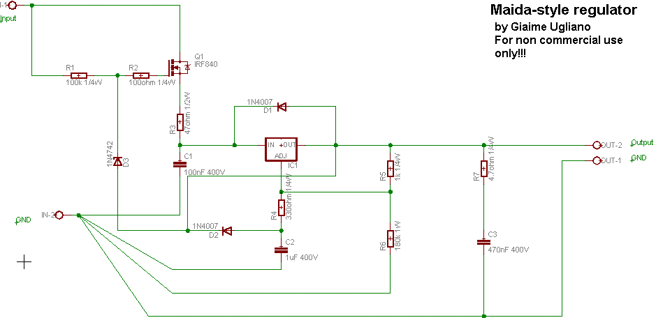

The Mosfet Maida style regulator used can be seen here. I made it point to point on perfboard though. You must calculate its resistor divider voltage setter for 340-350VDC. Details on how, are in the given link.
*The 15R became 20R 2W after new tubes got run in and draw less for 6V+ heater voltage.

Has anyone had experience with the circuit shown by foboleyns above. This is a triode mode variation.
Using the screen as an "anode" and AC grounding the real anode is something I've seen done with 6AU6 but not with higher power pentodes.
The theory is that the AC Grounded Anode completely surrounds the other tube elements and so should give some improved noise performance.
Can we expect any other improvements, that is, in linearity etc.

I have in mind to do that experiment on first opportunity, as I have seen it in some underground Japanese, but the thing that puts me off a bit, is that we create a much wimpier tube in that way. I want strong current in this preamp for example. Plus we should expect a different set of load lines.
I will repeat Ian's question then. Has anybody reviewed that topology?

I don't need it to deliver elevated current to the certain load. I had tested the certain setup with as high as 33uF film cap, as a coupler. The 0.68uF Mundorf delivered better subjective slam and stage on my 120k load. It sounds clearly more forceful in LF head to head with my DC coupled version of N-JFET PASS B1 buffer for instance.
It plays much better across the spectrum when biased strong. That's all. Goes without saying that the output capacitor in my schematic is just indicative for value or quality depending on load and taste.

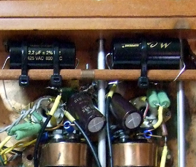

Guys, you put the bug in me and I got 2.2uF Mundorf Supreme to listen to. I put the biggish caps in and listened a lot. With my amplifier load there was no missing bass that I got back quantity wise. I just got a feeling of better coherence and a bit of more relaxation. Could be the phase turning much lower and preserving a better impulse response. Non the less I can hook up the odd solid state power amp with 20k or 10k input Z now with no bass loss.
