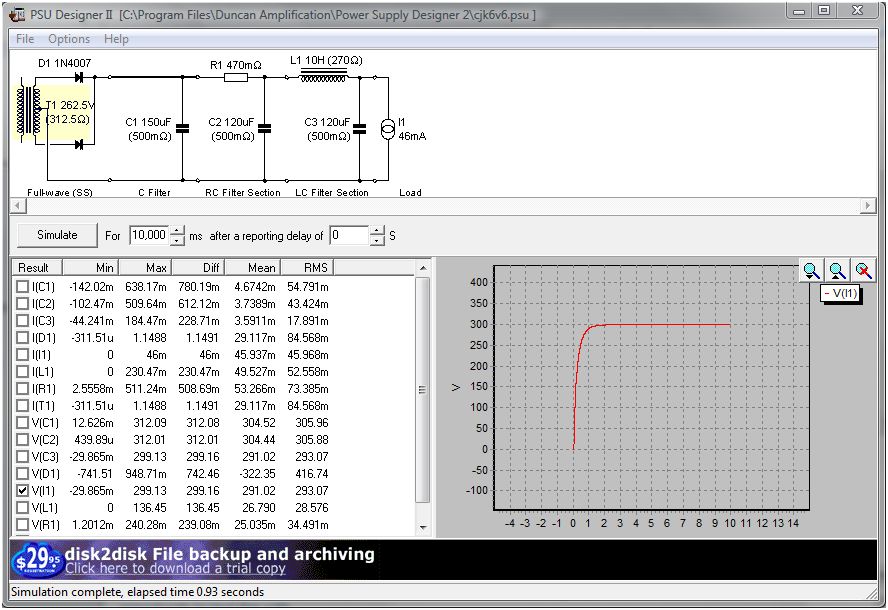

If your going for a linear supply I suggest we work it out togethere here. We would need your
  • xformer data, unloaded voltage and total dcR (measure primary and secondary resistance with DMM)
  • rectifier data
  • choke data, dcR and inductance
We'll set it up in PSUDII and calc so you dont get ripple or ringings
Staffan
Xformer - Allied Electronics TRANSFORMER, PRI:110-120V, 50/60HZ, 500VCT @40DCMA, 6.3V @ 2.0A, LEADS
Choke - Triad C-7X Inductor; Filter; Ind 10H; Tol -20%; +50%; Cur 90mA; Leads; DCR 270 Ohms
Rectifiers I have on hand are HER108 ultrafast
See attached...I have all the parts on hand to build this...
