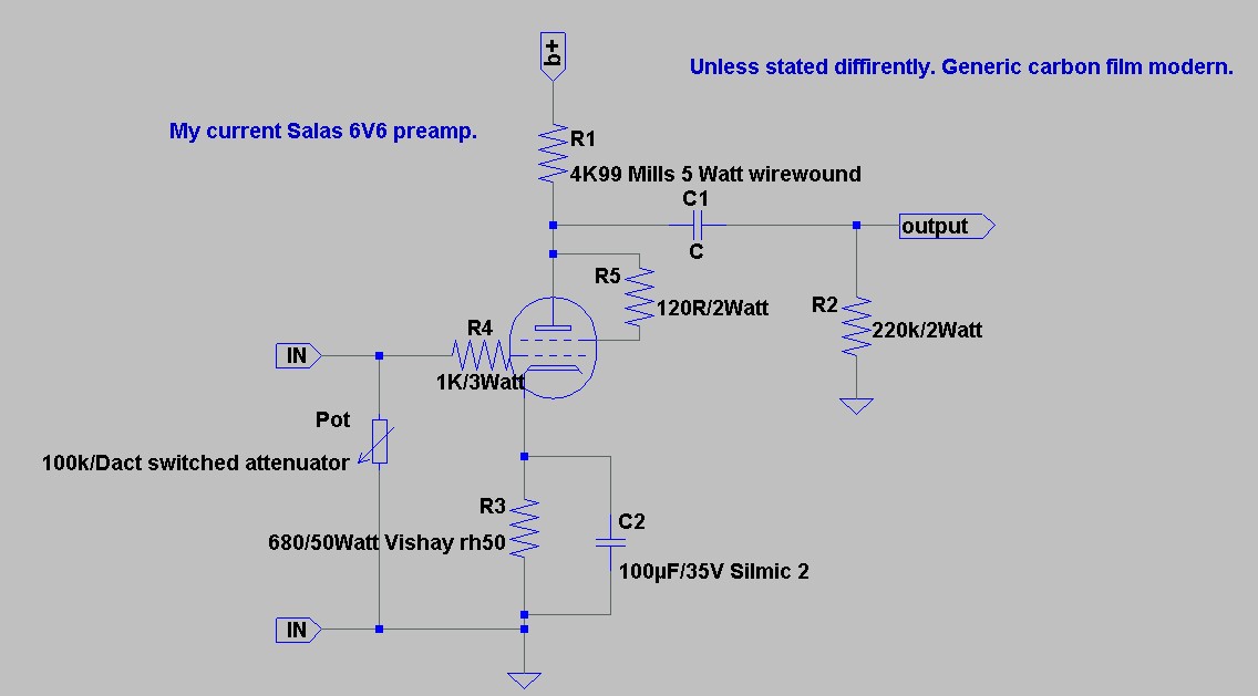

close pics and exact sch , please

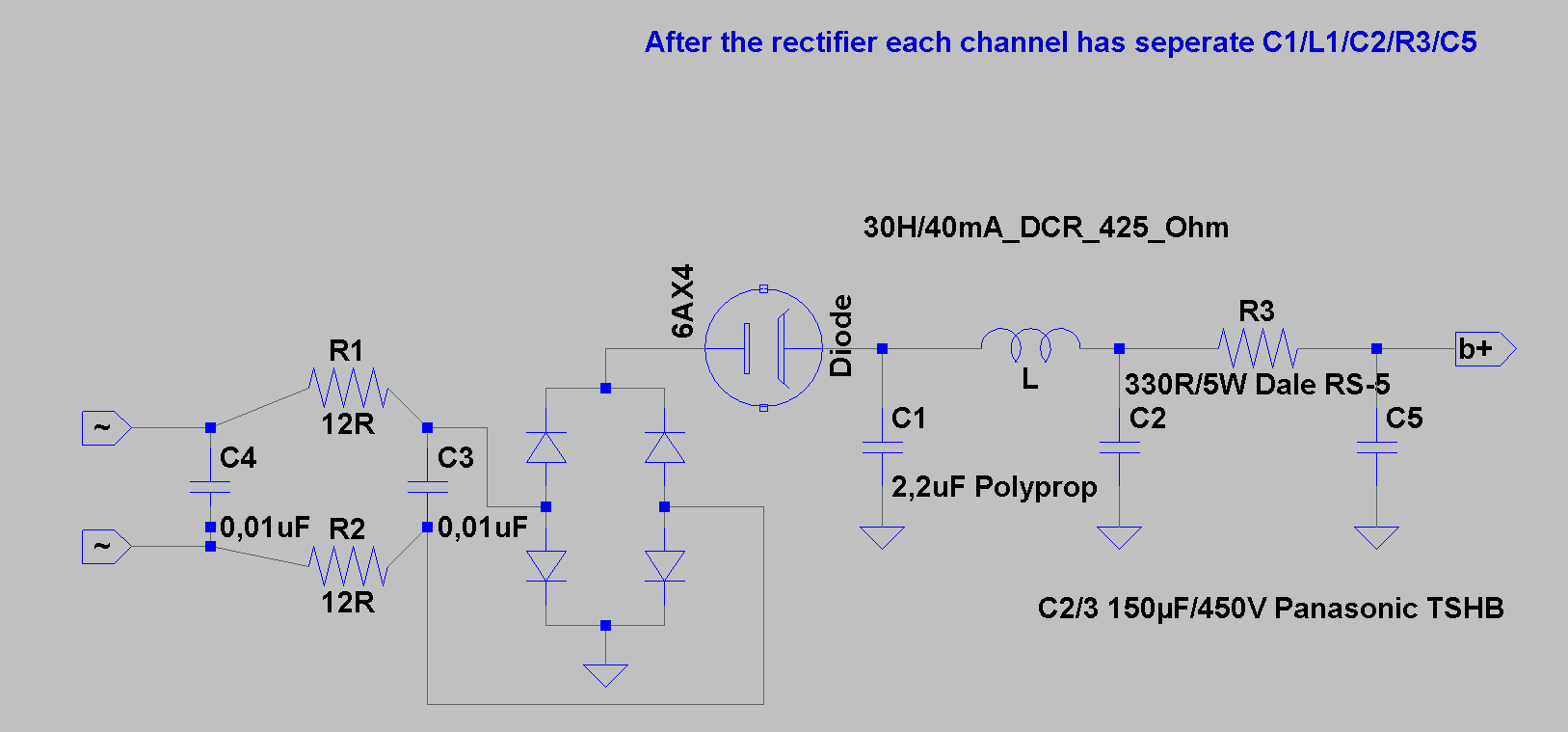

First sch. Tomorrow pics.
C1 at the moment. 4 * K42Y-2 caps. Each 0,047uF. 2 Wired in one direction. 2 In the other.
