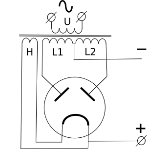

Do this and you should have no hum. Your 6.3V secondaries aren't strong enough and you parallel those I suppose.

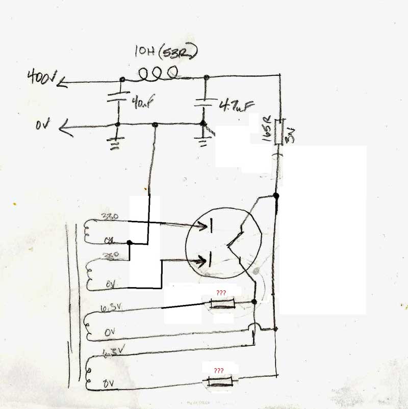

I just saw what Salas wrote about weak windings ........
you canconnect them in parallel , but!! securing that each 6V3 winding have own fixed resistor ;
so determine those resistors by trial and correct , going from higher value , that way that they're paralleled at tube heater
than take your Ub from whatever side of rectifier tube's cathode , as Salas posted

THe resistors before parallel point being an attempt to balance draw and reduce hum, as hum is essentially a difference or imbalance in voltage?
even if that you have hum there (in heater circuit of rect. ) and you have it anyway - because you are heating it with 5V/60Hz hum in fact :rofl: .... fact is that that hum is floating , referencing to your audio power circuit

Exactly!. Actually, my secondaries are rated for 4A, so I think Salas is right that one can be eliminated, leaving the balancing act for another day....
if they're 4A , then OK

:cheers:Filament went bad on soldering iron. Just got cheapo radio shack to make changes. Changing to single secondary to filament made no changes in hum. Hoping the CT configuration on B+ secondaries makes a difference. Let you know in a bit, and thanks for asking. Its been a day from hell so I need something to work!
