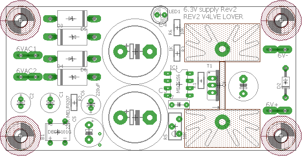

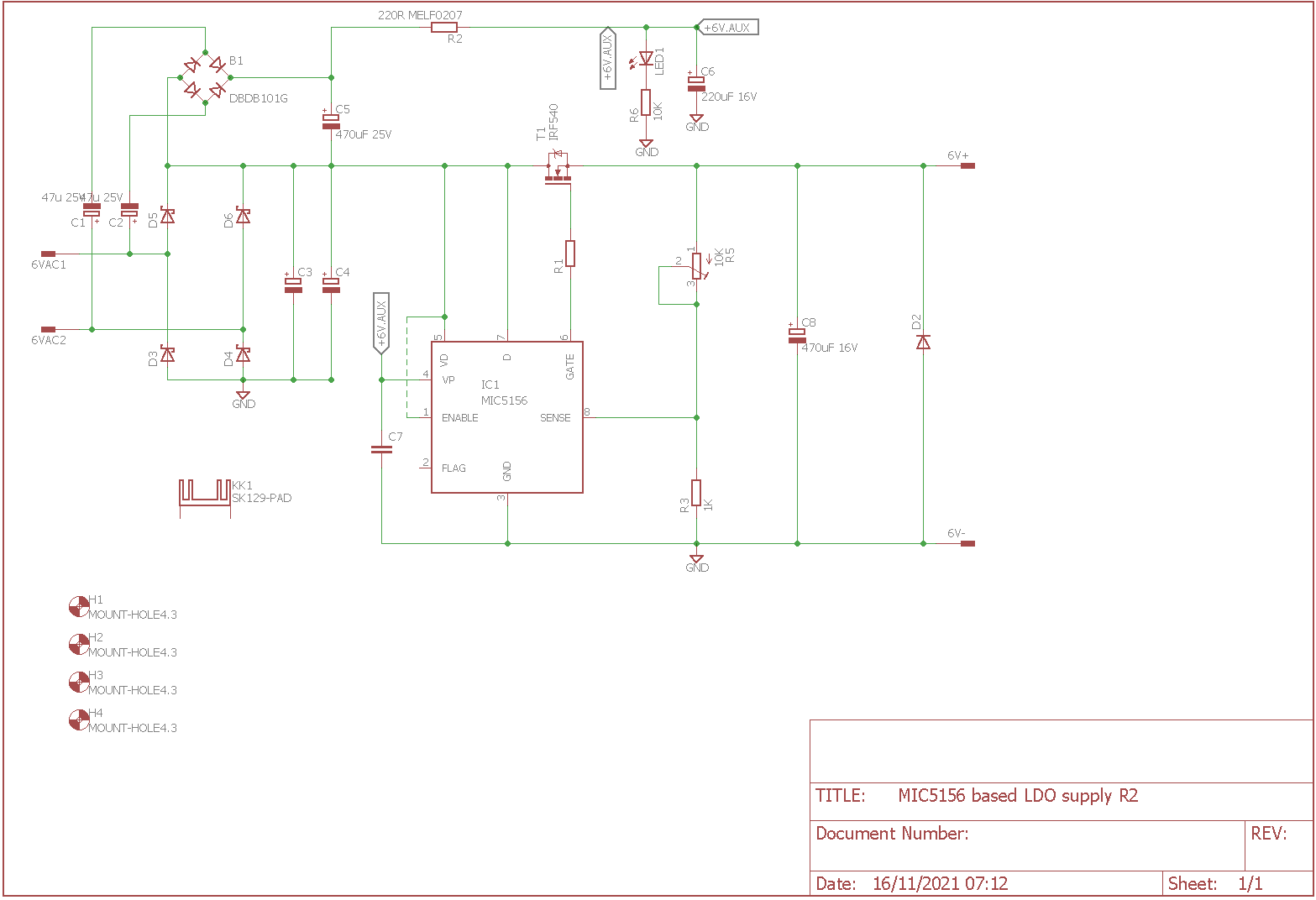

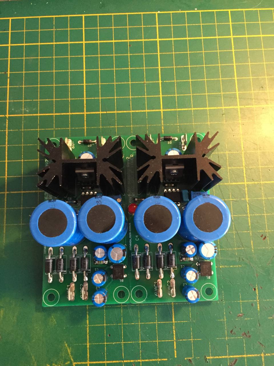

Here are the Gerbers for a little 50x100mm 40mm high LDO supply i made to turn 6.3VAC into 6.3VDC stabilized DC. Regulator dropout is lower than 120mV at 2.5A
Great if you have hum issues, and cant upgrade the existing supply for something like LM317.
I also make these to order.

Just got in my small PCBs for the power supply that is meant to go with these, and redid my workshop enough to try and actually work in it. Hopefully some more progress soon. Similar to this posted implementation- https://www.diyaudio.com/community/threads/6v6-line-preamp.102352/page-243#post-7319674
Apologies on how slow going things are, lots of busy work at my day job, and busy at home in my off time.

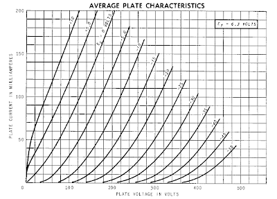

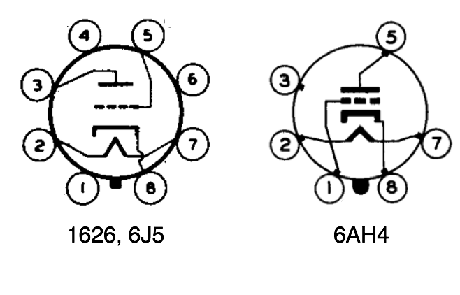

6CK4 and 6AH4 grid is connected to pin 1.
Caution: The 6CK4 also has its grid connected to pin 3, as well as pin 1. If your 6AH4 amplifier ties any circuit to the socket pin 3 (to use it as a "free tie point"), and you plug in a 6CK4, you are asking for trouble.
The 6CK4 and 6AH4 have different specifications.
Gm, transconductance 5500uM, 4500uM
u, Mu, 6.6, 8.0
plate resistance, rp 1200, 1780
plate dissipation, Watts 12, 7.5 Watts
filament current,1.25A, 0.75A

For what I consider a generic linestage circuit, 6CK4 is a direct plug in for a 6AH4. Current reg plate load and LED bias. As mentioned, be aware of the connections so this does not cause an issue. Rather like rigging a power stage to run either a 26LW6 or a 26HU5. Pins not the same, but with planning, they will serve in place of one another... :)

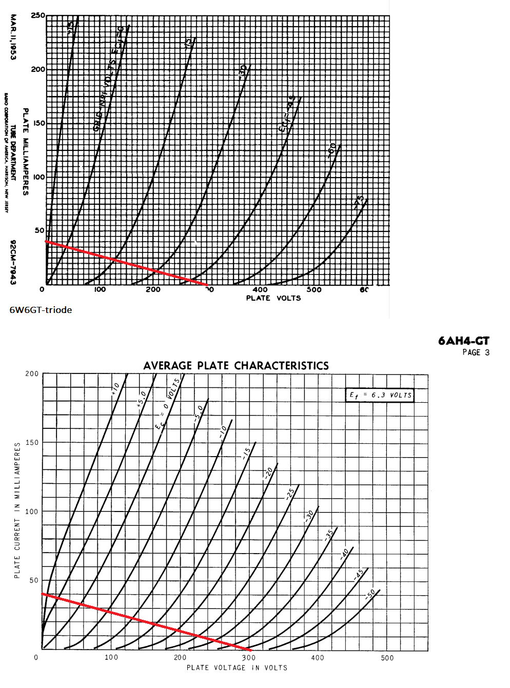

Hi, bias point will shift. Ip 4mA down Vp 22V down, gain will remain the same, THD 2dB less. In other words it doesn't change spec significantly for in ballpark plate load resistor other than less available output current and max negative going swing. Due to governed by the parallel feedback (Schade) network.
