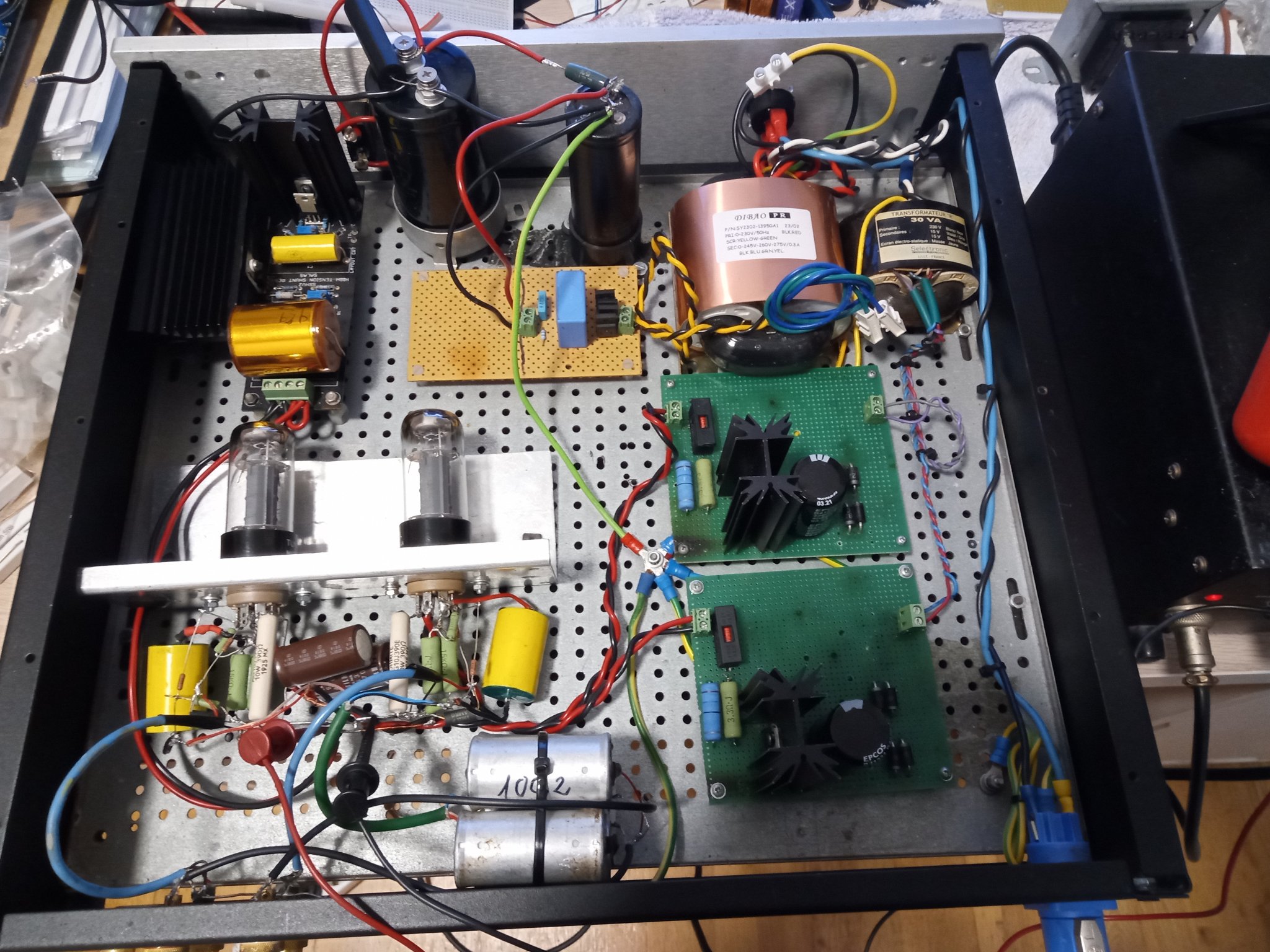

Done!
Reactions: 1 user
Joined 2009

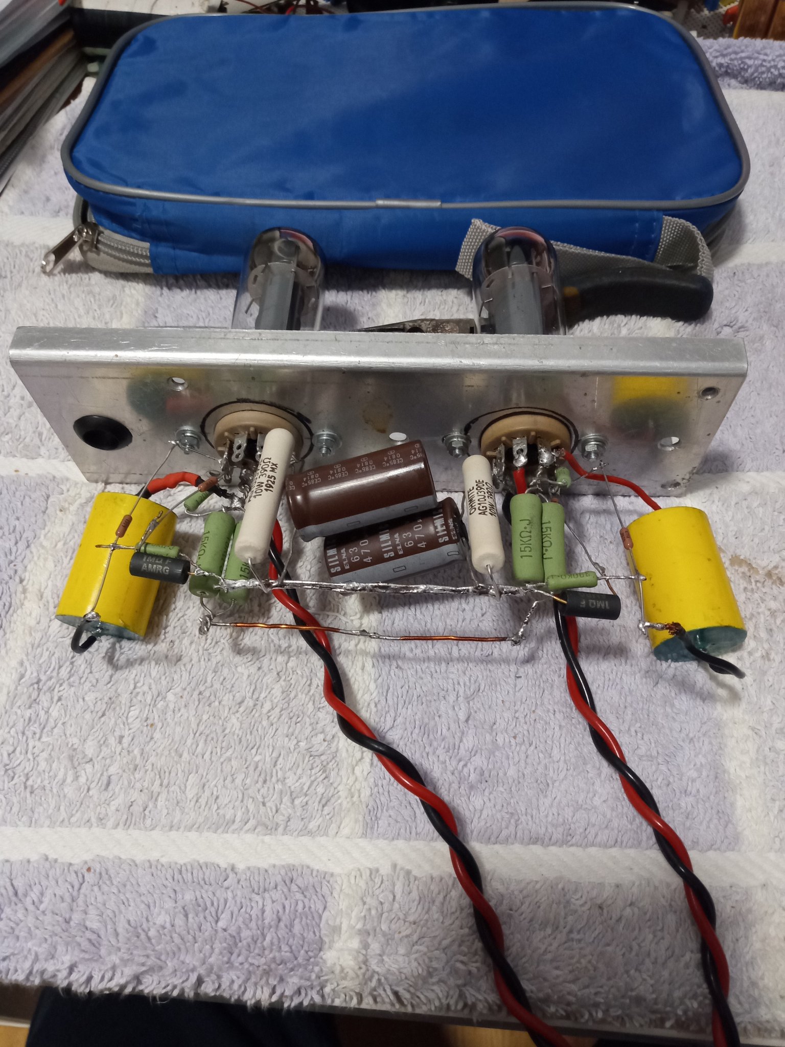

Yes analog noDac output stage.
It's only changing parts, first to use only one resistor @ cathode & NFB, 2nd to see if new parts improve sound (1st time using Ohmite Audio Gold 12W at cathode) used CMF @ NFB because can't get my favourites RN60 or RN65 and to use the more aproximate schematic values, also new R-Core reaching 330V for B+.
Possible a lot of changes to know how impacts the sound of each one but improved the SQ.
As you can see there are 4 FT3 caps at the output doing a crossfeed for HD600.
I do not exclude in the future use it as preamp.
N.B. When used before the 6V6 G3X NFB not used the crossfeed so still can compare, I will take off the the crossfeed & listen.
P.S. Sorry for my bad English guys.
