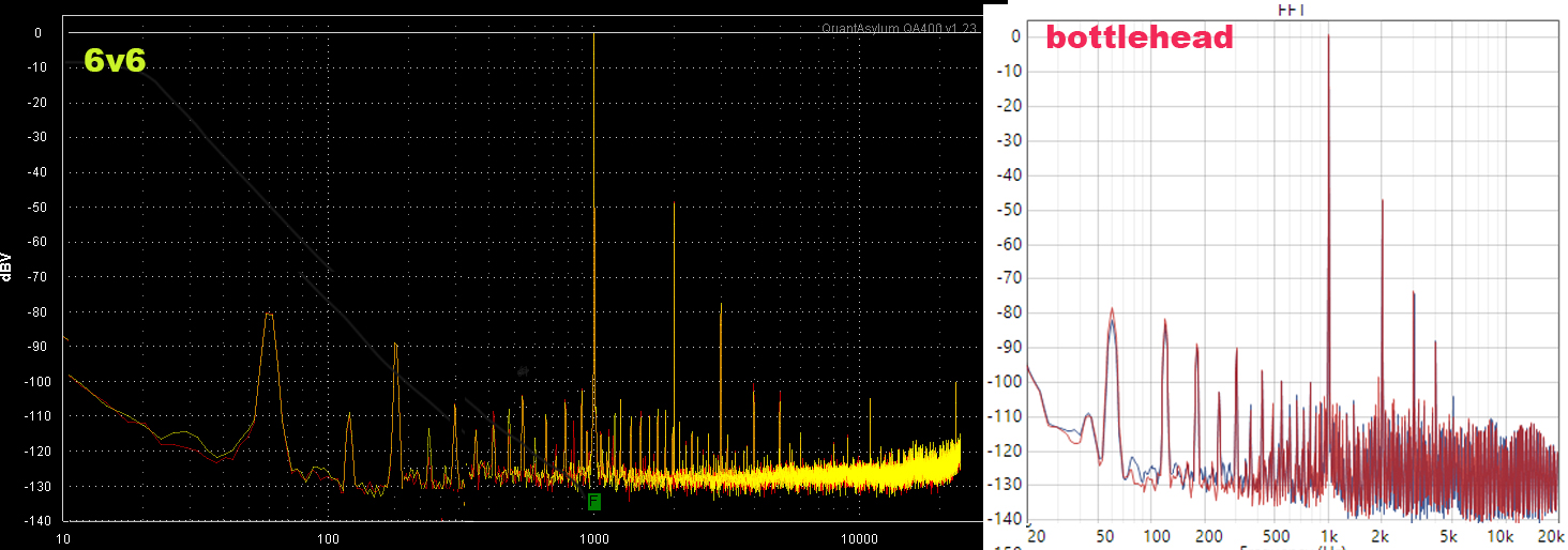

as headphone amp
Someone a few pages back asked about using this amp as a headphone amp. I did it running the gain stage into the CF stage, and just thought I'd post my results. It's similar to the bottlehead crack, so here they are side by side. My measurements going into a pair of Beyerdynamic DT 990, 600 Ohm cans, and another measurement of the crack from a review site, also into a 600 ohm load. My subjective experience also matches those from the crack reviewer.
This 6v6 version a bit lower noise than the crack due to using a Maida and DC heaters, and also H4 a bit lower too, but otherwise similar animals.
If you run the preamp into a regular line stage (20kOhm load and above) as intended, H3 and above all disappear to to -110db, pretty amazing.

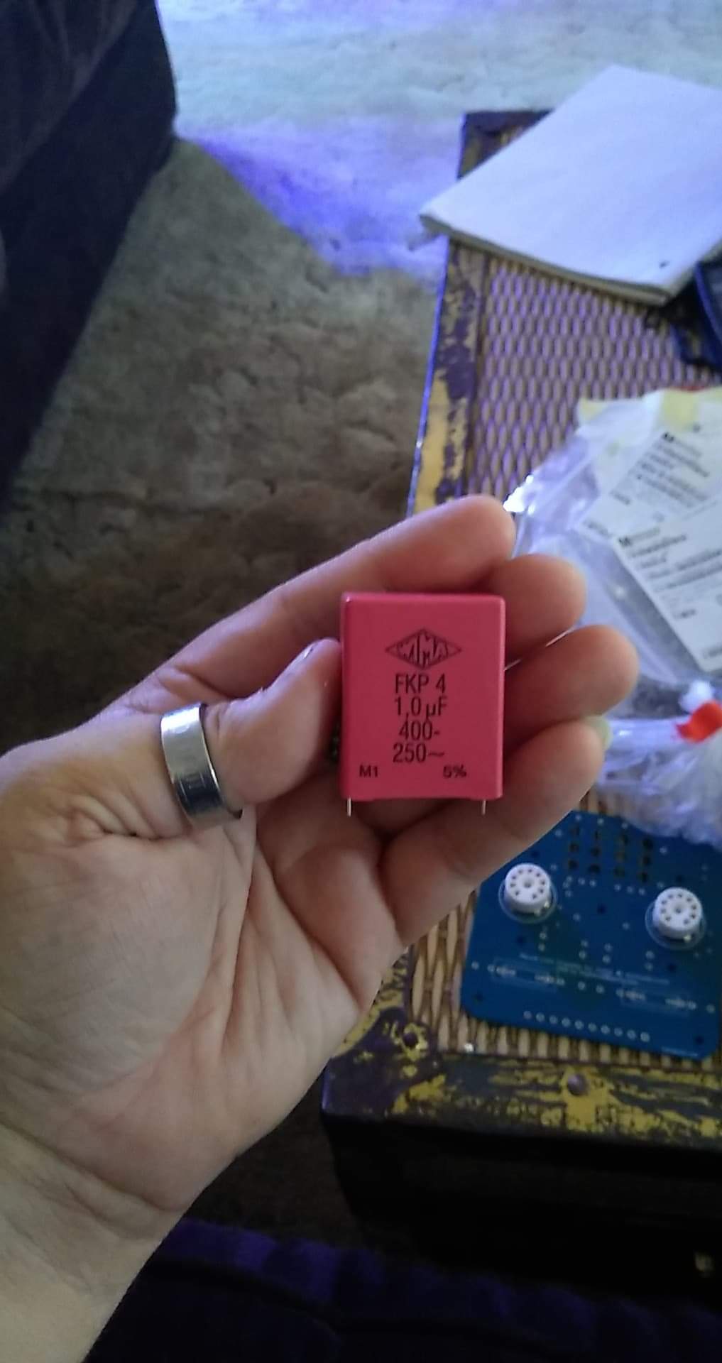

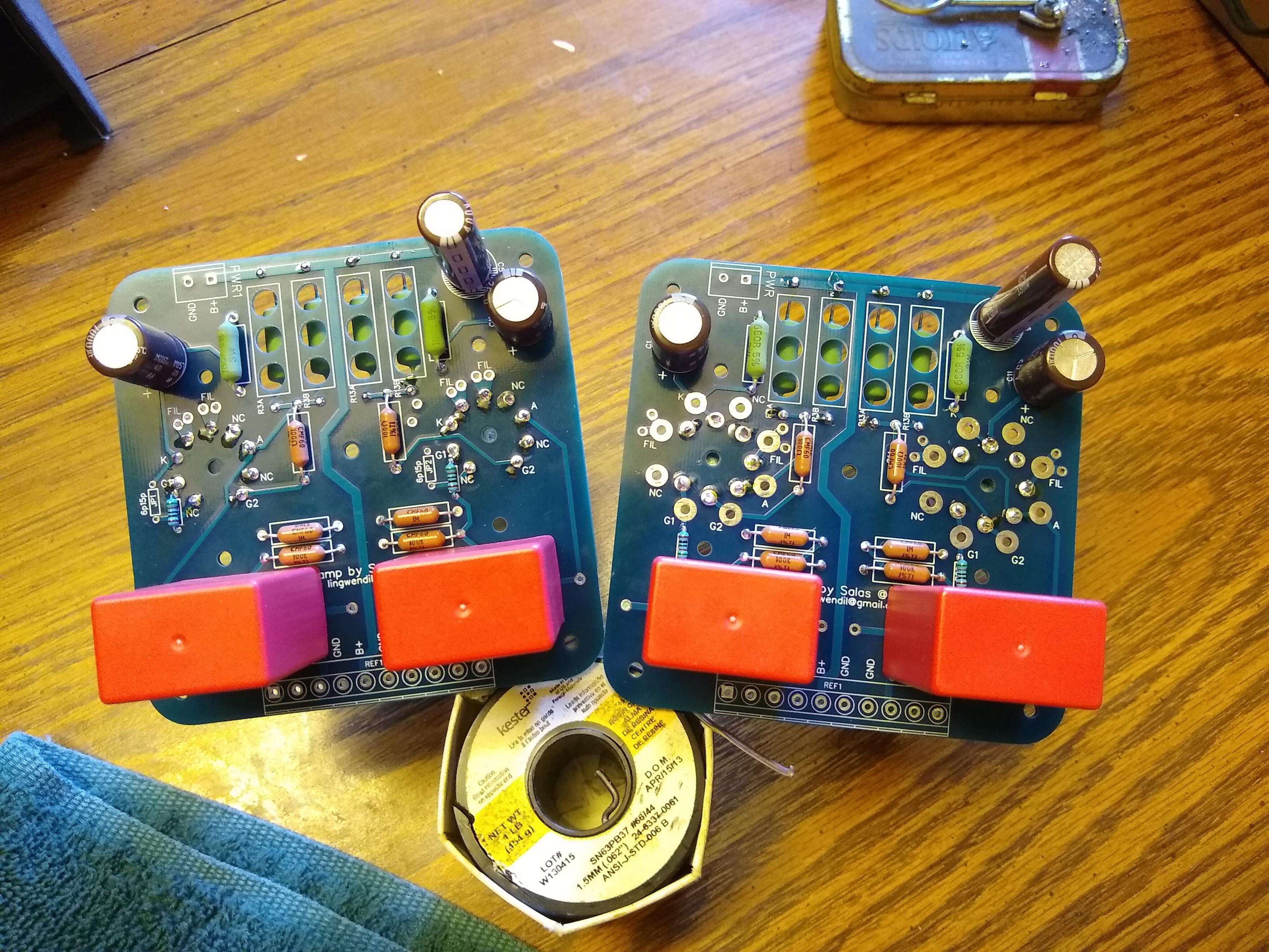

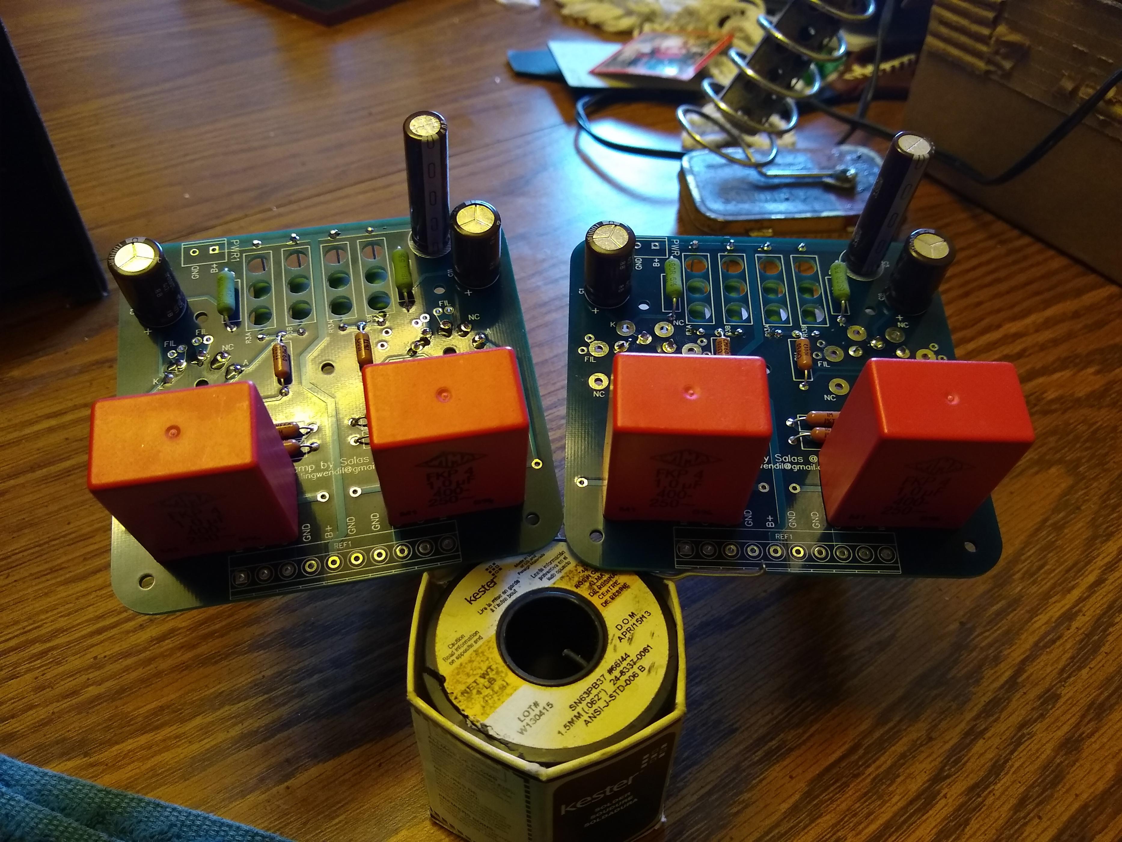

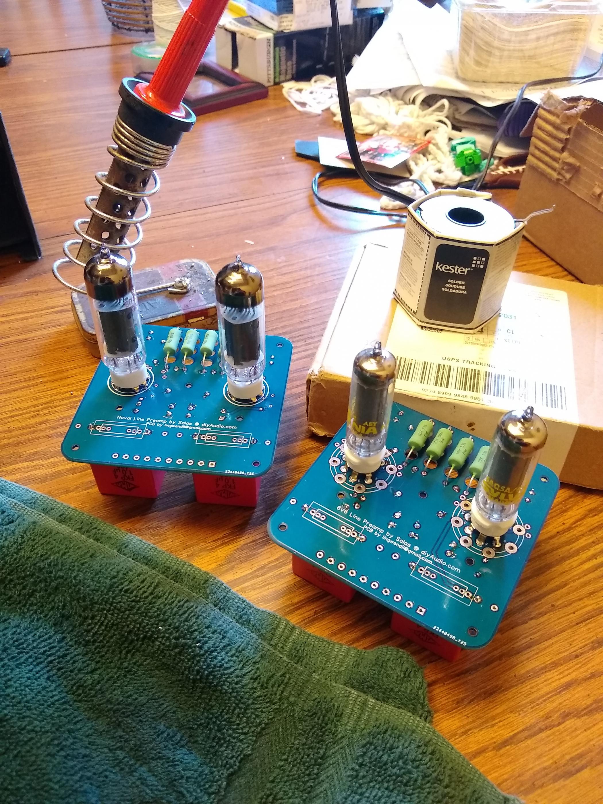

Parts came in today! Sneak peek at the populated boards- going 6AQ5 for the octal/seven board, and 6p43p-e on the noval board. The wima output caps I ordered are huge compared to what I usually use, it's been a while since I used such a large film cap! Thankfully everything I ordered fit the boards perfectly.
In the next few days or so I hope to have a power supply together so I can test them, and go from there. I think that will be a new thread, with better pictures and more discussion.
Excellent job!
Is this pcb for sharing?
Soon
I will do an initial build and test of them, then send a few out to others for testing. We will make any necessary changes to the board, and then do a larger order to sell them to members. Logistics still to be decided there.
