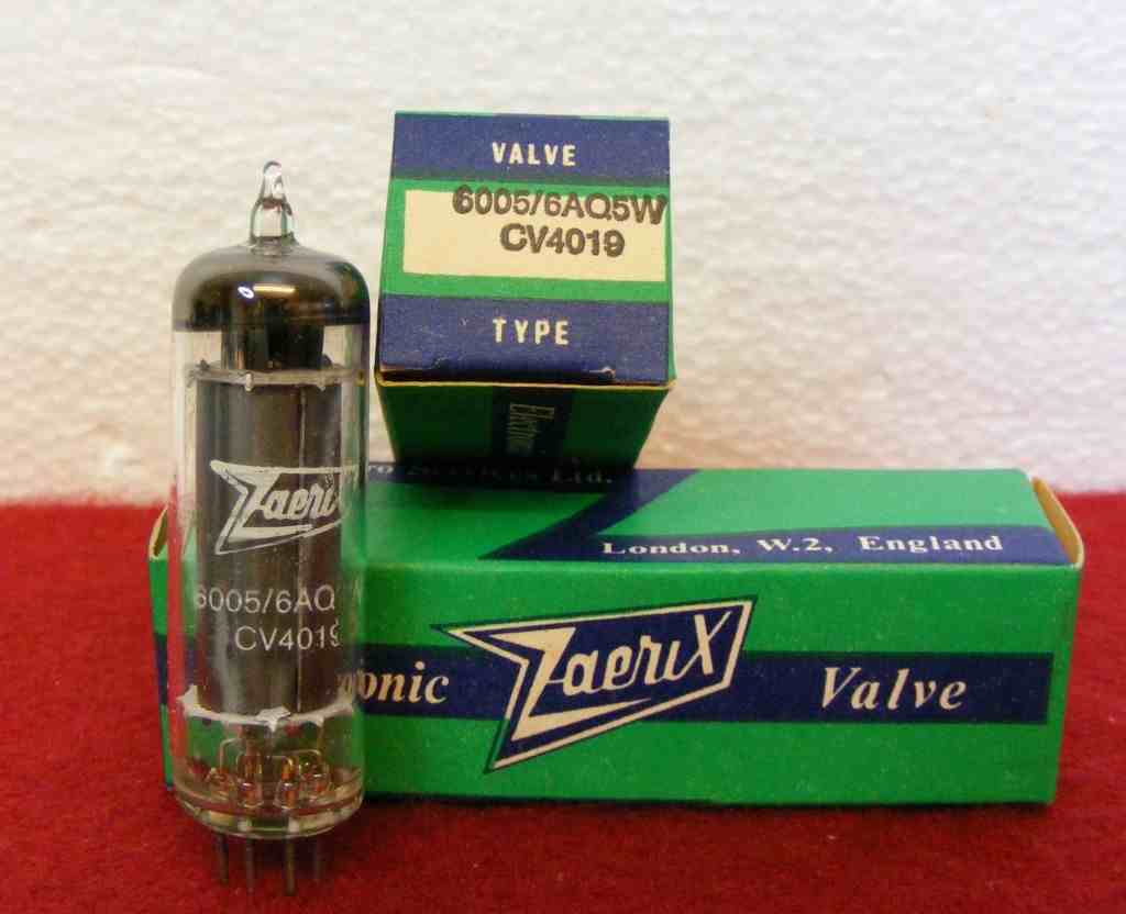

6AQ5
" There has been some question about building it with the 6AQ5 in the past and I said go for it but I can't remember a build. I had also mentioned the possibility of the English 6BW6 early in the thread. I don't know if it would be subjectively identical to using a good 6V6 but it has chances to be close."
Hi filament fans :deerman:
6V6 and 6AQ5 are both ROCKIN' TUBES ! :emoticon:
'Ampex' used to use the 6AQ5 as line-driver tubes in their multitrack tape machines.
The 6AQ5 is super linear & has a GREAT sound, just like the 6V6.

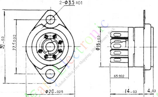

It's a straight swap for a 6V6, so in theory you could fit parallel tube sockets & choose between both.

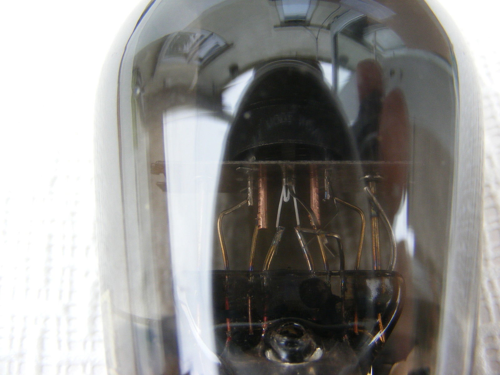

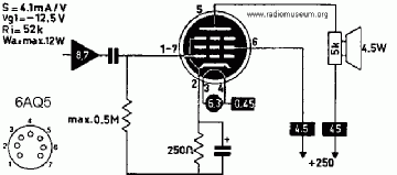

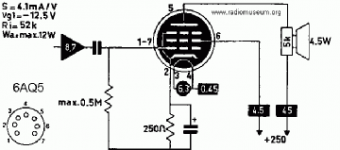

The last batch I picked up, was half a dozen of these ones.
Nice price ... nice sound !
attachment.php
