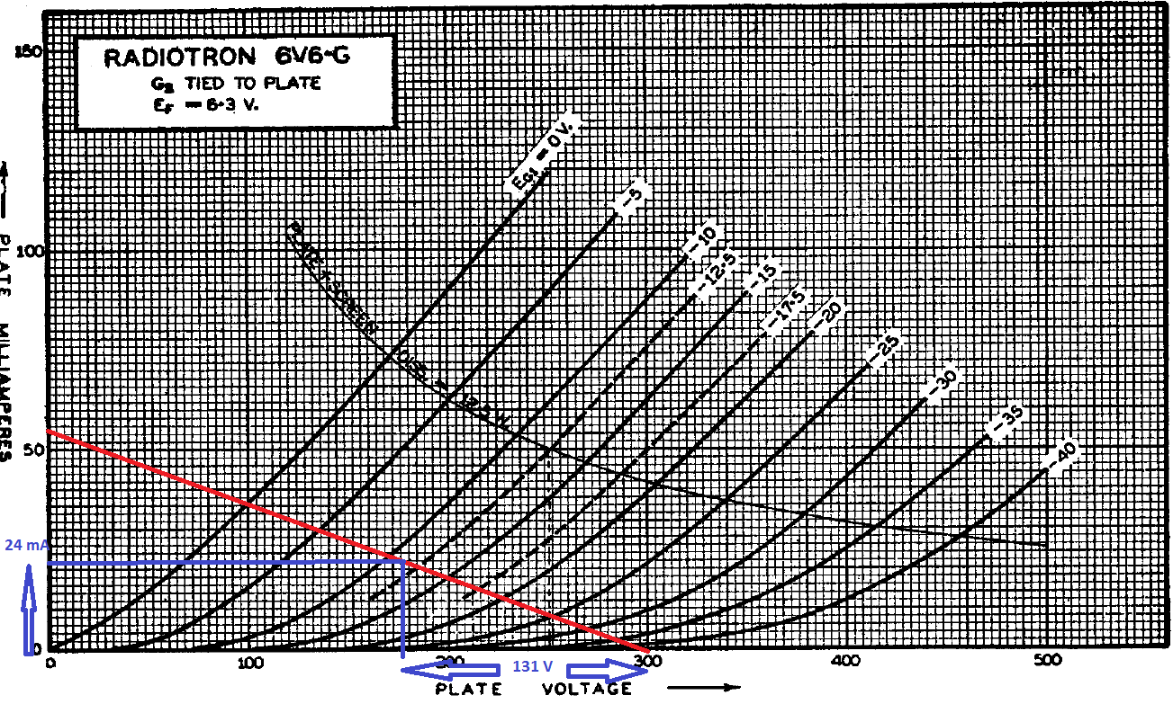

Ok i changed multimeter non i have:
Anode 295v
On the grid stopper after Cin 88v
On cathode 120v
8v across 470r
Actually i'm listening good music with this parameters...
The resistors are from schema standard the supply is a CRCRCRC doubled in the last for the Teo channel
Anode 295v
On cathode 120v
8v across 470r
This value is odd though. Probably measuring fault. It should be the difference between voltage over 470R and cathode.
May be, but there is a 470k between 470r and junction of Cin and 1k grid stopper
I guess it says that there is a small grid current, Otherwise there should be no drop over the 470 k.
It is true... I go to measure again...
Slightly leaky input cap could also change the expected grid to ground voltage measurement.It is true... I go to measure again...

If you can live with the lower gain and higher Zout it may be worth a try if only to judge the sonic impact of the decoupling cap.
I usually prefer the sound without the decoupling caps especially in a (phono) preamp. But then it's best to design with that in mind from the onset.
Another workaround would be to replace the cathode resistor with an appropriate LED if you don't mind the sand.

Noone maybe. Some superlocal fb w less amplification , lower thd and unfortunately some higher Z-out is worth a try. Z is ok as is
Ciao,
You know the story. 6dB less gain, double the Zo, half the 2ndH with about the same 3rdH.
