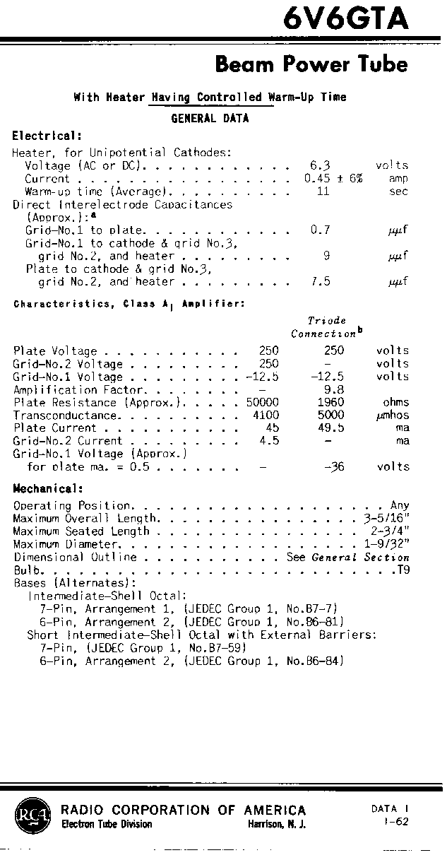

Dear all,
Pls, see attachment, RCA manual 6V6GTA. They said that in triode connection mode, at 250V plate voltage, plate resistance is 1960ohms.
Have you ever tryed this one before? Or could you suggest schematic to operate this mode. How about SRPP 12AT7 for driver?
Any pentode can be a triode. But in a pentode, the screen grid sucks big current even when plate voltage is low. So a pentode is designed for a high Mu (G1 to G2), 10 or 20, for good power sensitivity. In a triode, current falls when plate voltage falls. You want a low Mu, like 5, to reduce this effect. 6V6 Mu is 10. So it is OK but hardly great as a triode power amp.
For 1935, this was very good performance. It might still be pretty good for 6V 0.45A heater power. It won't knock your socks off.
I've used the 10 Watt plate rating, which really applies to TV V-sweep duty. SET duty is tough too, but perhaps less likely to gross abuse than cheap TV work, so at your discretion you could run 12, 14, even 18W in your 6V6 (they are tougher than the book says).

Ah: RCA's 1940s datasheet gives suggested values for triode operation, somewhat better than my estimates because they push the 14W rating for audio triode operation.
Huh? It only needs 15V-20V of drive, with 250V-300V of supply voltage available. No reason to muck it up with complicated drivers. For zero-feedback operation, a 6SN7/12AU7 is plenty of gain. If you want damping better than 2, use 6SL7/12AT7 and take some NFB around everything.
